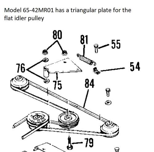

Spindle belt 6738 (1/2" x 86") - This model uses a triangular idler arm. See PSB 209.

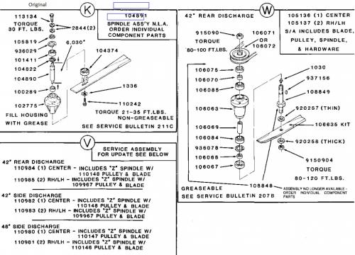

Mower spindle assemblies could be K, V, W or Z
For V and W see service bulletin 207B
106586 3-blade set replaces 105837 blade and no longer available (5/8" x 3/4" double-D center hole)

1976 model 65-42MR01 replaced by - (Has the flat spindle belt idler pulley mounted on a triangular plate.) - (Has multi-link hardware at the gauge wheel support)
1977 model 75-42MR01 - Both use blades with 5/8" x 3/4" double-D center hole unless the spindles have been upgraded. (Has the flat spindle belt idler pulley mounted on a triangular plate) - (Has multi-link hardware at the gauge wheel support)
