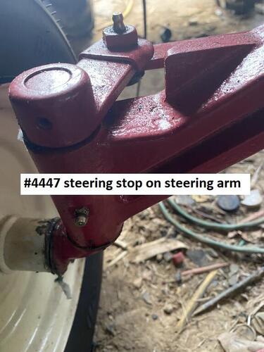

1962 model 32E Lawn Ranger
1962 model 32R Lawn Ranger
Steering stop / turning stop 4447 added to 3919 arm
