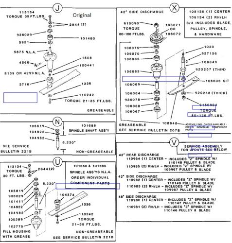

Mower spindle assemblies could be J, N, U, V, X or Z
For N and U see service bulletin 221B
For X and V see service bulletin 207B
6693 blade replaced by 100200 3-blade kit and no longer available (Hole 5/8in.x3/4in. Double-D)
Stens replacement - 3 of 350-041 still available March 6, 2021

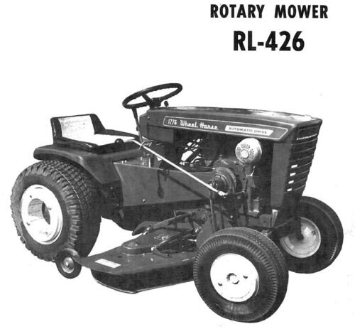

Mower Rotary 1966 42in SD model RL-426
