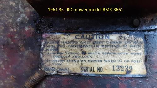

Mower Rotary 1961 36in RD model RMR-3661

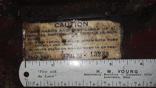

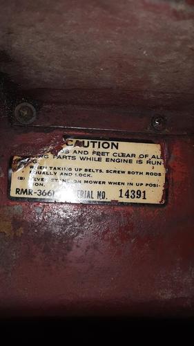

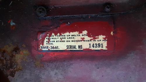

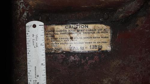

1961 serial numbers that have shown up for the RMR-3661
10588
12661
13239
13341
13376
13984
14105
14391
14729
