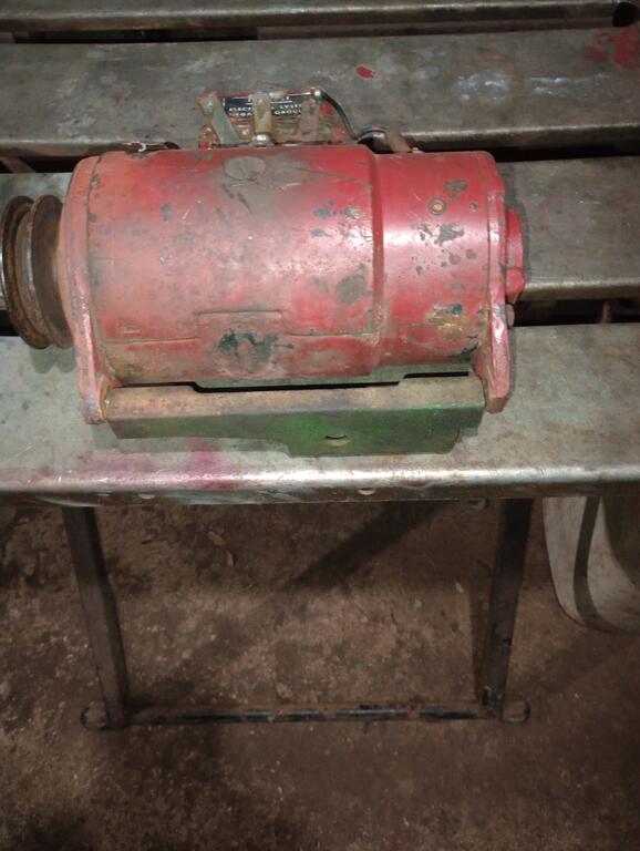

    Looking for the long 5/16 bolt that holds the generator too the bottom bracket the generator measures 8 inches help thanks

    A 8 inch bolt is to short so what kind of bolt did they use for this

    What tractor/engine is this for?  If you can find the parts manuals here (quite likely), you might get lucky and find the actual measurements of that bolt.

    If you get into straits and you have thread-cutting ability, you could consider making one.
    From my extremely limited knowledge of steel specs, I’d use something like Multipurpose 4140 Alloy Steel rod from McMaster and put Nyock nuts at both ends (or thread locker and double-nut on one end)
    (@ri702bill?)
    Note: threaded rod will chew up the mounting tabs on the S/G and engine--smooth rod will maintain proper alignment without wear.

    If the overall length is an uncommon size, say 8-3/4", it is far easier to get a 10" boly and diecut the threads back to the required length. @Handy Don is correct - the run of the bolt thru the brackets should be smooth - all thread is not a permanent choice due to vibration.

    By chance have you tried giving AZ tractor a call?  Or some other person who salvage parts?

    I may have found one at a bolt supply I will see when it come in thanks everyone for the help

    The bolt came in and it was right on thank y'all for the help
