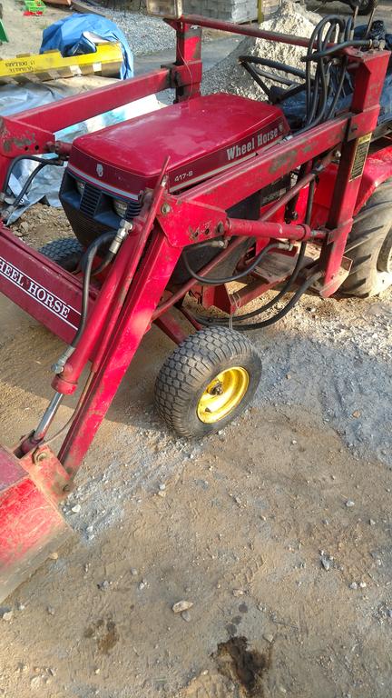

Howard8313 1 #1 Posted August 24, 2017 Hey guys. I have a 417-8. I honestly don't know the year. I saw it and bought it. It has been a great machine. I am looking to do a trans swap on it though. The right side axle bearing is shot and pretty sure has damaged the case. I am not sure how long it's been like that. I have tried to find a different transmission but can't find one for my exact model. Can someone let me know what other models may have a trans that will fit? Or if I might be able to put a heavier one in instead. Share this post Link to post Share on other sites
gwest_ca-(File Mod) 12,451 #2 Posted August 24, 2017 Will be 1985 tractor model 31-17K801 or 1986 model 31-17K802 Both used the 110995 model transmission. This file has a list of tractors that used the 110995 but there are other transmission models that used 8 pinion gears and 1-1/8" axles. Search the manuals using "6 forward speeds" in quotes for more. Looks like I can't make the link stick. Will try later. Garry 2 1 Share this post Link to post Share on other sites
Howard8313 1 #3 Posted August 24, 2017 Awesome. Thanks for the info. I at least have a part number to look for now. 1 Share this post Link to post Share on other sites
