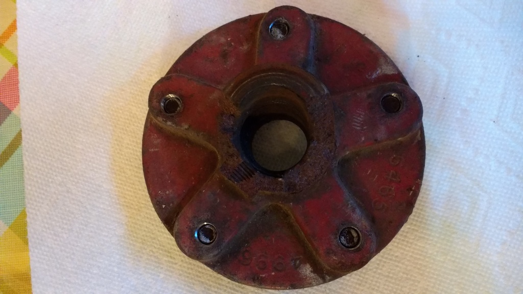

elicountryboy1996 2 #1 Posted August 9, 2017 I am in the process of restoring an automatic 12 and I thought i'd ask if anyone knows the part number for the hubs, or knows where I can get one because this is why I got the tractor for free because it broke Share this post Link to post Share on other sites

gwest_ca-(File Mod) 12,467 #3 Posted August 10, 2017 Sounds like you need some manuals The axle should be 1-1/8" diameter. At some point in time they went to 2 set screws to secure the hub to the axle which was an improvement. Might try to get one of those for a replacement. Good used should be available. 6465 was the original hub number and replaced by this one http://www.partstree.com/parts/toro/parts/105763-03/ Garry Share this post Link to post Share on other sites
