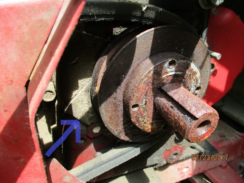

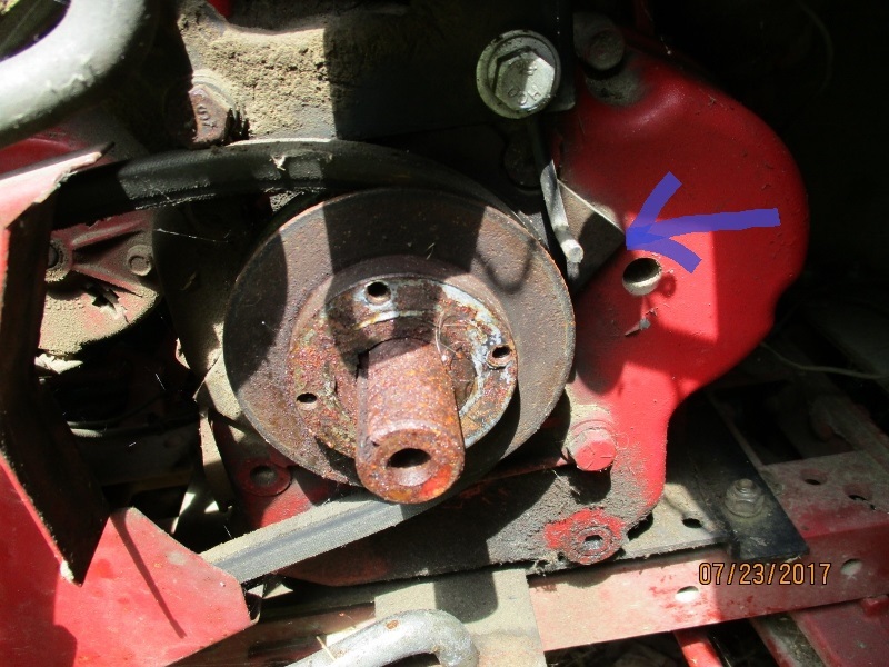

Anyone have a close up picture of the pto/Mule side of their gt 1142 engine? Should be the briggs 11hp model 252417. I got a disassembled one and a close up picture would ensure I got it back right.
Thanks!
I just went out and took a few pics of the one I have.  The important part is the thrust plate bolted to the motor.  Briggs doesn't have an internal thrust bearing.  The thrust bearing is in the pulley and presses against the plate.  Arrows point to the plate.  It's on a diagonal.
Hey, thank you alot. That's exactly what I needed. That will make it a ton easier.
