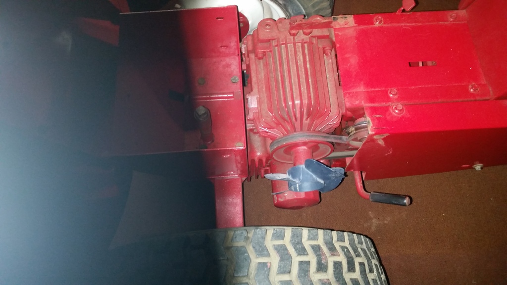

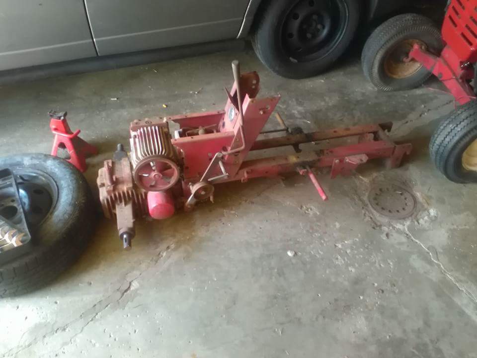

Tgtack 653 #1 Posted July 9, 2017 I have an opportunity to pick up a 1077 (to restore), and two complete B Series hydro pumps and transaxles. The question is, can I swap out the 3 spd transaxle on my 857 with one of the B Series units. This would help me greatly as I use the 857 to mow with, and because of my MS, I have issues using the clutch/brake on the 857. One of the hydro units has all the various linkage needed for a transplant. Share this post Link to post Share on other sites

Tgtack 653 #6 Posted July 9, 2017 (edited) They are the older Sundstrand units. One is still mounted to the frame with head stand and all linkage, so I should have pretty much everything I would need. I know I would need the smaller drive pulley with the bolt on fan rather than the large diameter pulley with fan made as part of it that is on the units. Also will need to modify or replace the head stand. So I guess it would wind up as an 877 clone. Supposedly they work, but for the additional $40 for two complete transaxles, I figure it is worth taking the risk. Edited July 9, 2017 by Tgtack 3 Share this post Link to post Share on other sites

Sarge 2,608 #10 Posted July 10, 2017 I think up to '75 Sundstrand units will interchange , although there can be some minor differences in linkage and pulley sizes . Most of the differences are in the parking brake mechanism , but otherwise all the same parts . I may upgrade the '67 1277 to the later C-series piston to piston unit as it was much stronger and less prone to breakage than the early hydrogear version of those transmissions . The basic 4 bolt pattern never changed on the Sundstrand equipped tractors , so that helps a lot . You can spin that hydro to do a mild test with a heavy duty drill and a socket on the pulley , but be careful how much torque you apply as you can snap that small bolt off easily . I say go for it if you can get complete units with all the linkage intact . It's a bit of a puzzle , but you can handle that part . Sarge 2 Share this post Link to post Share on other sites
