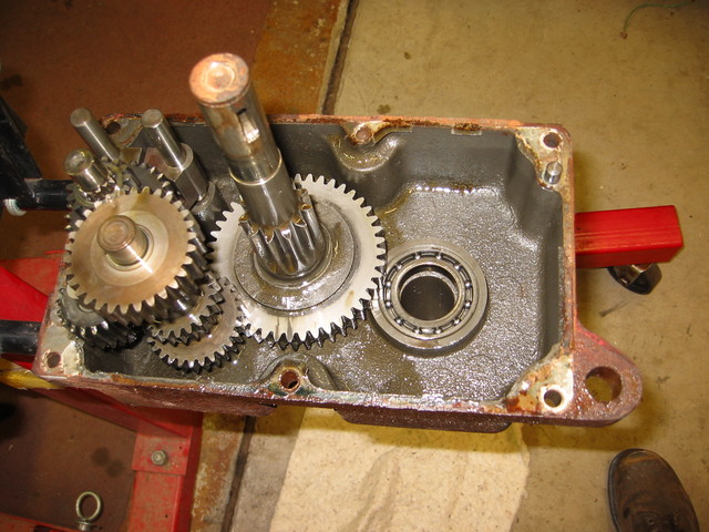

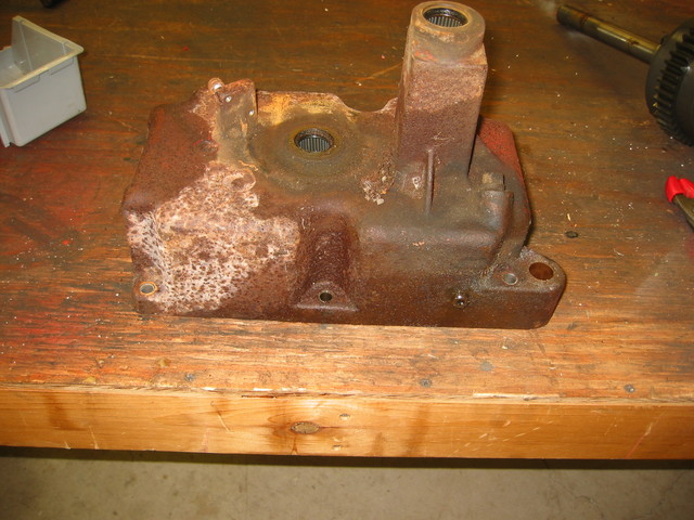

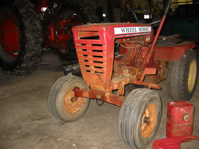

pfrederi 21,097 #1 Posted December 11, 2016 Pick up a rolling frame Commando 8 a long time ago and she has been sitting in the barn until last month. Based on looks I anticipated problems in Tranny land. Opened her up today and looked like new. New case gasket and seals and she is going back together. I had planned on full tear down, press out all the bearings and sand blast the case...not now. Any ideas how to clean up the outside of the case without getting water or sand into the tranny???. 7 Share this post Link to post Share on other sites

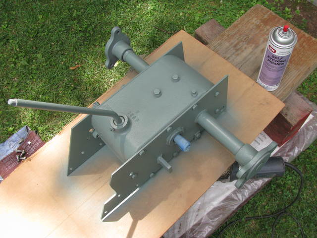

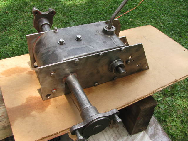

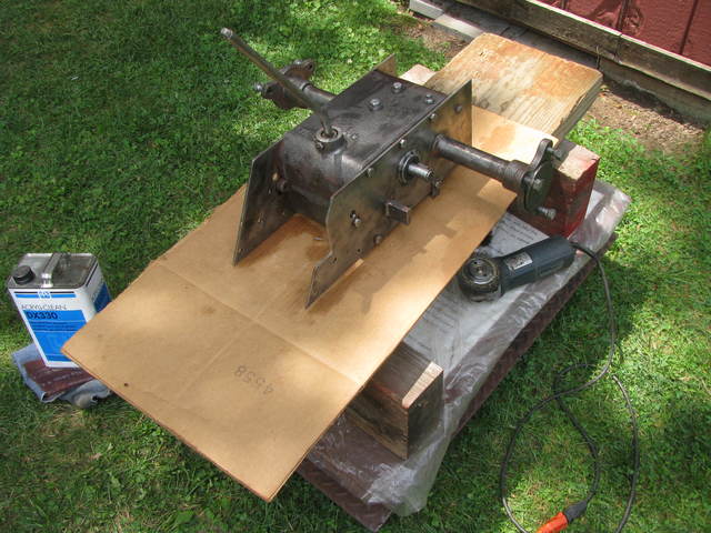

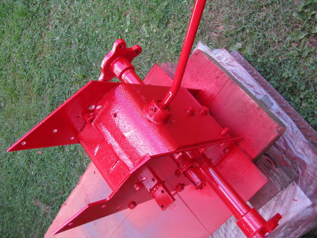

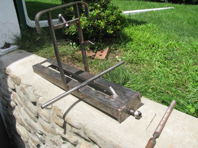

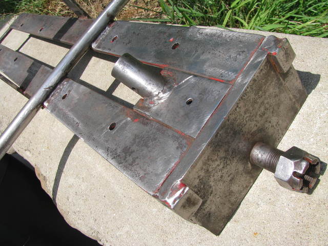

AMC RULES 37,259 #2 Posted December 11, 2016 Simple grinder & wire wheel cleaned this one up nicely. 4 Share this post Link to post Share on other sites

AMC RULES 37,259 #5 Posted December 11, 2016 I can assure you Paul... this one won't be rusting anytime soon. 1 Share this post Link to post Share on other sites

cleat 9,295 #7 Posted December 11, 2016 Or like AMC said, just use a grinder with a wire wheel then a good primer and paint. I would replace the seals just because of age. 1 Share this post Link to post Share on other sites

AMC RULES 37,259 #9 Posted December 12, 2016 BTW, those angle grinders... work really great on frames too. 1 Share this post Link to post Share on other sites
