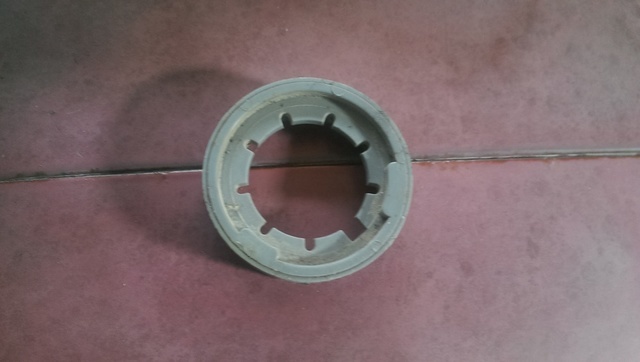

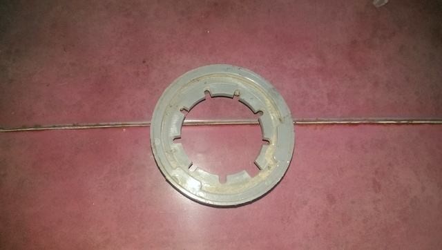

Could very well be was it the BLACK ring by chance? These are prone to weak magnets vs the GRAY but when my module went south I was advised to replace All components at the same time, "Jess" has a post going right now with his 518 also, try PMing BOOMER the Onan parts guy here,Jeff.
  • Like 2
Hi Jeff, yes, I seem to remember the ring WAS BLACK because it had slipped around on the crank shaft about 90 degrees when I removed the flywheel, so I had to slip it back to align it to the key-way slot. Damn......now I have to take the whole doggone shroud etc etc off again, pull the flywheel, etc to check out and more than likely replace the ring.
   It would make some logical sense that the magnets may be weak because as I check the negative side of the coil with my light tester, the light dims but has what seems to be a very weak flicker. If the magnetic pulse is too weak, the circuit in the module will not produce a solid ground for the primary of the coil. Without a strong current in the primary of the coil, the secondary of the coil will not produce a high enough voltage to cause a spark jump in the plug electrodes. I guess I know what I will be doing tomorrow morning !!!

SUCCESS !!!! Replaced the black ignition ring with a new one (Gray) strong magnets, and the beast roared to life !!! Just to sum up the problems, the coil secondary was bad also, open winding. The ignition module may be still OK, I will check this out later on the bench to see if the circuit will operate with a makeshift tester. Now the H518 has a new capacitor, a new coil, a new ignition module (and heat shield spacer), and a new ignition ring. The former parts lasted 29 years, so if these new parts last that long I will be 102 years old and probably won't even be able to mount the horse any longer !!! LOL
