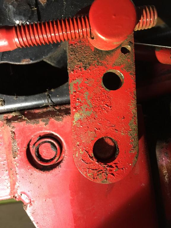

bizzo15 52 #29 Posted April 28, 2017 (edited) Ok so I was able to get some time to Tear back into the left side of the tractor tonight and I have a couple of questions. First one is which hole is the clutch return spring supposed to go into?(pic included) also is the trunnion in the right hole? My second question is I looked at the pin and it doesn't appear sheared to me but I'm not exactly sure how to tell. Can you guys tell by this pic? thanks for all all the help and advice I feel like I'm real close to getting this issue licked Edited April 28, 2017 by bizzo15 1 Share this post Link to post Share on other sites
