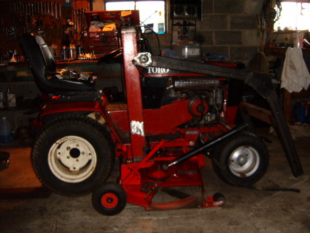

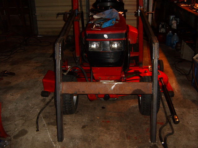

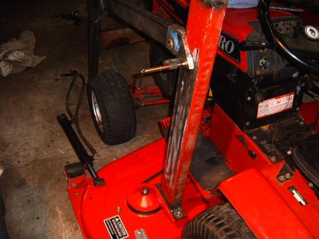

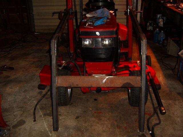

elliot ness 1,916 #29 Posted September 2, 2015 You think the 20hp will be able to handle the 60 inch and the loader? In the brochure it only shows i having a loader. I have put a loader and a deck on a 12 hp. 312 A and it handled it just fine. and it had a 48 in deck, The 20hp Onan will do great as far as power. I even put a loader on an electro 12 and run a till also All that being said, you still have to know the tractor limitations as far as frame strength, and spindle strength. and as with any loader on a garden tractor, never steer it when it's sitting still with a load in the bucket, wait till it moving. And if you have a D series make sure your thrust bearing under your front axles are there and in good condition. Day 6, everything I thought was right yesterday turned out not to be . So after some rework on the loader under carriage, to the tune of 4hrs. I got the deck on the tractor and it works with the loader frame, so back to more grinding and welding tomorrow. 1 Share this post Link to post Share on other sites

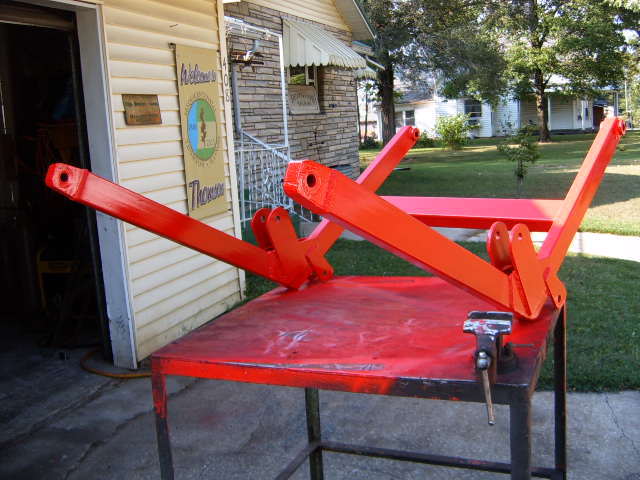

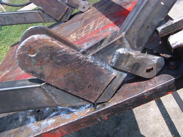

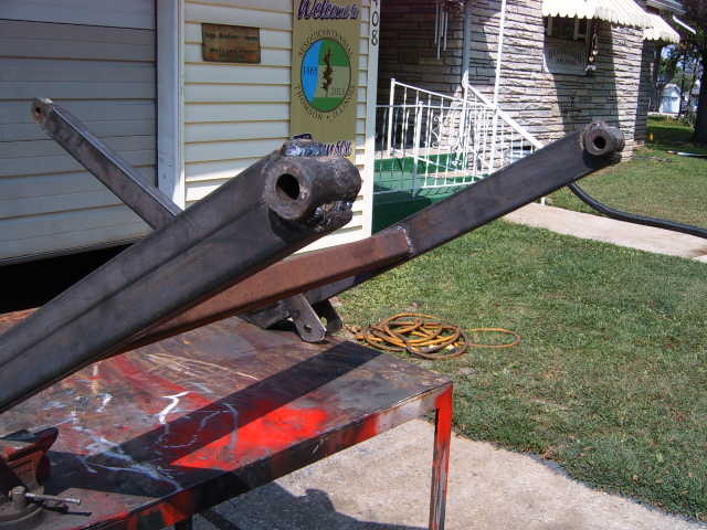

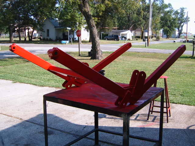

elliot ness 1,916 #34 Posted September 4, 2015 Day 7, finished the brackets on the loader arms and welded also now paint this evening. Plus much more fitting and welding tomorrow. 3 Share this post Link to post Share on other sites

elliot ness 1,916 #37 Posted September 5, 2015 Day 7 yet painted the loader arm frame. Still a ton of fitting , grinding, plumbing, ect. but I see light at the end of the loader frame Share this post Link to post Share on other sites

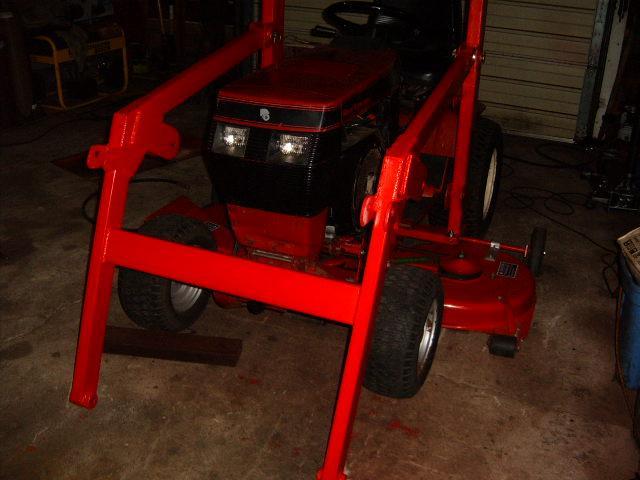

elliot ness 1,916 #38 Posted September 6, 2015 Day 8. painted the uprights and mounted some things. Tomorrow going to figure out the pump and pulley off the left side of Onan. I can tell now that it is going to be a tight fit. 3 Share this post Link to post Share on other sites

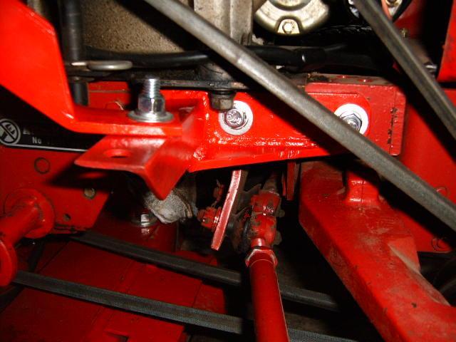

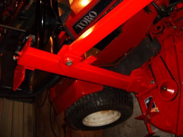

elliot ness 1,916 #45 Posted September 6, 2015 One angle bracket complete. Share this post Link to post Share on other sites

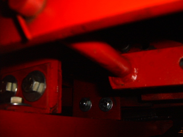

WNYPCRepair 1,875 #47 Posted September 6, 2015 Not to detract from your story, but is that a loose engine bolt? Didn't think of it at first but I can understand the deck helping to lower the center of gravity and actually make the loader more stable. But I think it's the exact opposite when it come to mowing. Can't see the FEL being much help while cutting grass. Though we do raise dogs and there have been some moments... Hmmm? If you have a Great Dane or Newfoundland you will need the loader to scoop! Several Labradors! Don't want to have to pooper scoop for anything larger unless I can ride it too! Kids could ride either with no problem. Probably not my fat rear though, I would break their back! When I first started my PC business, I also sold fence for a friend to help pay the bills. I did an estimate where the guy had two Danes, and apparently never cleaned up after them. There was crap everywhere, and the piles were huge. There was still snow on the ground, and the smell was so bad I couldn't stay to measure, I just estimated, doubled it to be safe and make up for our guys having to work there. I assumed he would say no, but he took the bid. I may have been the only guy to not just leave Share this post Link to post Share on other sites
elliot ness 1,916 #48 Posted September 6, 2015 Not to detract from your story, but is that a loose engine bolt? YES it is. Didn't think of it at first but I can understand the deck helping to lower the center of gravity and actually make the loader more stable. But I think it's the exact opposite when it come to mowing. Can't see the FEL being much help while cutting grass. Though we do raise dogs and there have been some moments... Hmmm? If you have a Great Dane or Newfoundland you will need the loader to scoop! Several Labradors! Don't want to have to pooper scoop for anything larger unless I can ride it too! Kids could ride either with no problem. Probably not my fat rear though, I would break their back! When I first started my PC business, I also sold fence for a friend to help pay the bills. I did an estimate where the guy had two Danes, and apparently never cleaned up after them. There was crap everywhere, and the piles were huge. There was still snow on the ground, and the smell was so bad I couldn't stay to measure, I just estimated, doubled it to be safe and make up for our guys having to work there. I assumed he would say no, but he took the bid. I may have been the only guy to not just leave Share this post Link to post Share on other sites
