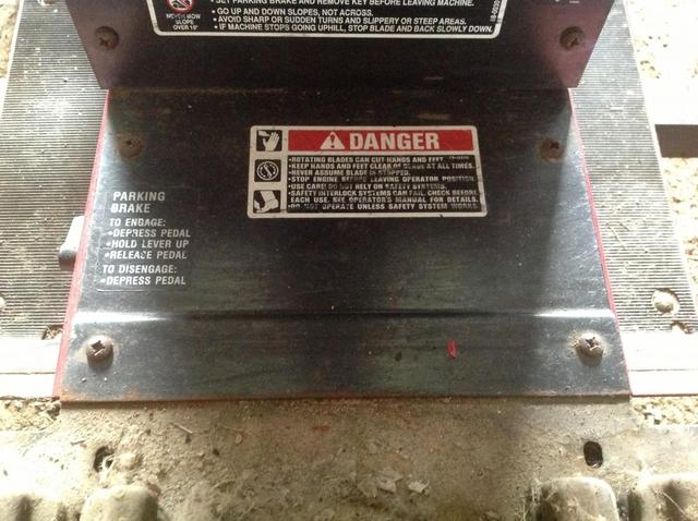

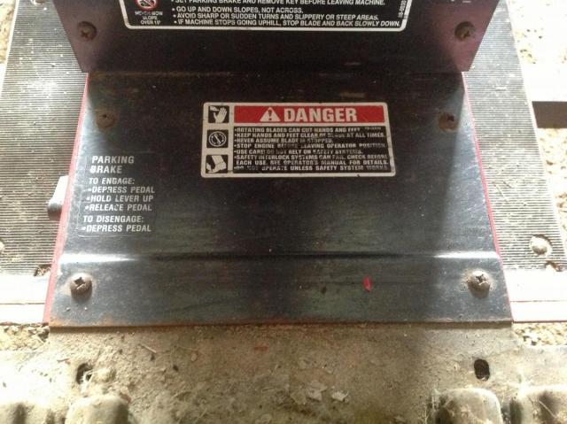

dennist 139 #99 Posted July 10, 2014 Yes, they can roll, mine do. I know when I suggested removing the tunnel cover in pic below, you said yours was welded on? Even if it is, you should do something about that, as there are plenty of important components under there that "can" be causing your issue also. There are a bunch of linkages and if they are not all tight and correct it may result in rattling that makes the cam move. IMO, this is very important step that you are not addressing and it is going to continue to haunt you till you atleast make sure it is all functioning as it should. . I once found a bolt going through the dash tower was put on backwards making the end of the bolt block the travel of the motion lever and the PO just kept hammering on the lever instead of taking the time to fully look at the motion lever from front to back to see how it all works and what was wrong. It could have even been the reason he ended up selling a great machine that continually gets a bad rap for not running properly. 1 Share this post Link to post Share on other sites
252H 6 #100 Posted July 10, 2014 Yes, they can roll, mine do. I know when I suggested removing the tunnel cover in pic below, you said yours was welded on? Even if it is, you should do something about that, as there are plenty of important components under there that "can" be causing your issue also. There are a bunch of linkages and if they are not all tight and correct it may result in rattling that makes the cam move. IMO, this is very important step that you are not addressing and it is going to continue to haunt you till you atleast make sure it is all functioning as it should. . I once found a bolt going through the dash tower was put on backwards making the end of the bolt block the travel of the motion lever and the PO just kept hammering on the lever instead of taking the time to fully look at the motion lever from front to back to see how it all works and what was wrong. It could have even been the reason he ended up selling a great machine that continually gets a bad rap for not running properly. I'll try to get it off and see what i can find! Hopefully i find the problem! Share this post Link to post Share on other sites
