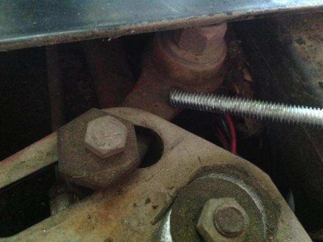

zu7ysa9y.jpg.
That star shaped bolt on top is very loose and when i move the motion control lever the star moves around like partially in a circle
Looks like that piece is upside down. The raised flange should go down into the cam. the flange has an eccentric on it that allows you to fine tune your neutral setting by rotating the large hex then tighten the bolt and you should be good to go.
You might be right, Cleat. It does look like there is a lip on the cam plate slot.

2e8ara4u.jpg. This is what i have done so far. Now what do i do?
I flipped the 1/2 in bolt. Does this look better? I

In the pic below, look at the bolt that I have laying on the pump arm.....when you remove the bolts that hold that on the cam plate, you will be able to rotate that arm forward and and backward making the wheels go forward and reverse. You will need to get it to the neutral, then adjust the linkages by putting your motion lever to the exact neutral location and hook up from there.
