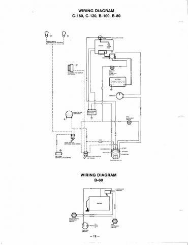

rmaynard 14,897 #2 Posted April 23, 2014 There are two safety switches. One on the PTO lever, and the other activated by the clutch pedal. Here is the wiring diagram. You also mentioned that there was no throw-out when the starter turned. That is not uncommon for a starter that has been sitting for awhile. You need to clean the Bendix assembly and do not lubricate it, as oil and grease only attract dirt and will soon create the same "no throw-out" situation. You should have 12 volts to one side of the solenoid at all times. The other side goes to the starter. Starter is grounded through the body, to the engine, frame and back to the (-) of the battery. Taking a jumper from the hot side of the solenoid and touching the small lug on the solenoid should do the same thing as turning the key with all safety switches working. However, by using the jumper, you are eliminating everything that could be a problem. If the starter turns over, then you can go back and trace your circuit to find where the problem is. Hope this helps. Share this post Link to post Share on other sites

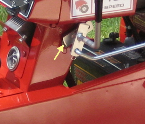

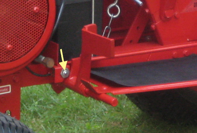

rmaynard 14,897 #4 Posted April 23, 2014 (edited) Clutch safety switch is located in front of the clutch pedal. It is a ball switch that is mounted in a bracket attached to the frame. You should see two wires attached to it, one of which goes directly to the solenoid. The PTO switch is the same type of ball switch, and it is mounted in the dash tower, directly behind the PTO lever. Here's the clutch switch and the PTO switch location Edited April 23, 2014 by rmaynard Share this post Link to post Share on other sites
