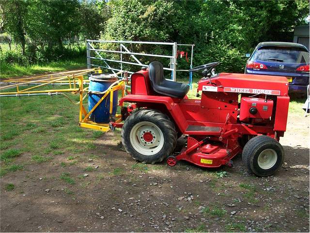

rtfbg 744 #1 Posted March 20, 2014 Can any of you guys or gals help me date a D200?? Hood decal is "D200 Twin Automatic" Does not have traction brakes Background of headlight panel is black. Kohler engine large number at bottom of IDtag is 8126 main serial number not readable. Previous owner said it was a 1967 model ... but had no data to back that up. Looks identical to a 1978 I used to have. HELP!! thanks!! Share this post Link to post Share on other sites
Shuboxlover 474 #2 Posted March 20, 2014 If the decal is correct it's somewhere between a 1978 to 1981... More qualified people will chime in. GREAT looking horse by the way!!!!! Share this post Link to post Share on other sites
rtfbg 744 #3 Posted March 20, 2014 Thanks ... I found a manual online that had the ID page, and it shows this tag would be a 1978 model. Guess seller was full of it!! No matter, 78 is fine with me!! Share this post Link to post Share on other sites

AMC RULES 36,945 #5 Posted March 20, 2014 Nice lookin' , did you bring it home? Share this post Link to post Share on other sites
rtfbg 744 #6 Posted March 20, 2014 Yes ... picked it up on Tue. It looks good in the pics, but it needs a ton of work ... as usual, the steering is shot, the hand controls are all crap and a rear wheel seal is leaking .. all usual D200 stuff!! BUT .. it appears all the parts are there except the fuel tank cap!! lol Share this post Link to post Share on other sites

Hodge71 663 #8 Posted March 20, 2014 Definitely not a 1967 as the "true" D series didn't start until 1974. It appears to be a 1978..its id tag should be 81-20KS01..... Looks in great shape. You must have been around these tractors quite a bit. It seems lil you know all the normal issues for a tractor of this era.... Good luck with her!! Share this post Link to post Share on other sites

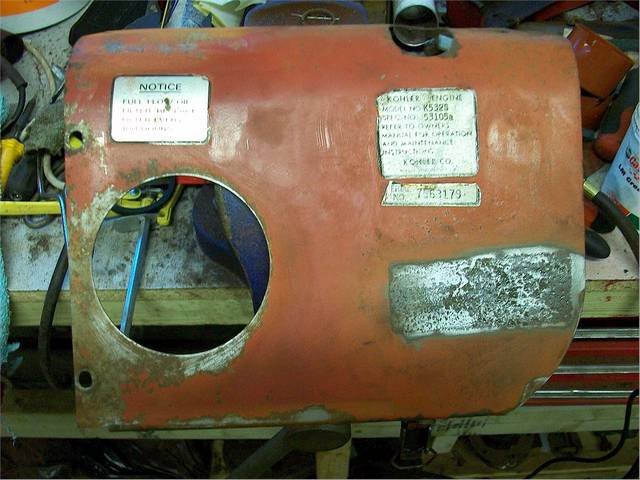

rtfbg 744 #10 Posted March 26, 2014 I've got another silly question ... the previous owner painted this thing, including the engine, with what I can only guess, was a 10 year old mop!! Where should I begin stripping paint on the engine to find the ID tag??? thanks!! bob Share this post Link to post Share on other sites
wheeledhorseman 573 #11 Posted March 26, 2014 (edited) The Engine ID is on a couple of foil decals on the engine tin just below the spark plug. Here's the originals This is from my '77 D-200 but the arrangment on my '78 is exactly the same - just don't have pics of that ready to hand. Hope this helps. Andy [edit] Re the gas cap gauge the original 13" is NLA but I discovered that Kelch (OEM manufacturer) still do a generic 12" that looks good - and gives you a little 'reserve' after it indicates empty. This size based on the larger gas tank which should be on yours - both my '78 and '79 have the large tank. Edited March 26, 2014 by wheeledhorseman Share this post Link to post Share on other sites
rtfbg 744 #12 Posted March 26, 2014 thanks!! I will gently hit it with some stripper gel and see if something pops up. Otherwise, IK may have to borrow someone elses number to shut up the counter clerk at the Toro dealership Share this post Link to post Share on other sites
pfrederi 17,147 #13 Posted March 26, 2014 You said it didn't have "Traction" brakes...did you mean turning brakes. If it is a 1978 it should have a real brake band on the transaxle. earlier models just used the hydro itself for braking. If it is a 78 the Kohler Spec number should be 532S-53105A Share this post Link to post Share on other sites

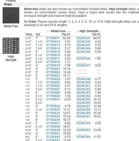

pfrederi 17,147 #19 Posted April 21, 2014 (edited) Seems the brake band is NLA...McMaster sells strips of brake lining (I use metal free)....and rivets Edited April 21, 2014 by pfrederi Share this post Link to post Share on other sites

rtfbg 744 #22 Posted April 21, 2014 Thanks guys ... never thought to check McMasters. I've been watching online, most bands are showing round hoops on both ends ... the D has a hoop on one end and an angle with holes on the other. Either put new lining on my band, or cut end off and weld it to a different style. Better sleep on this!! lol thx again!!! Share this post Link to post Share on other sites
