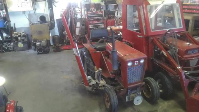

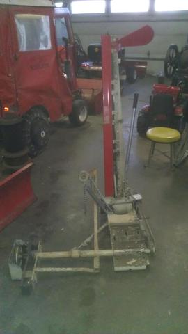

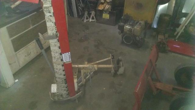

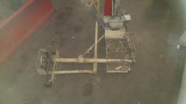

jeremi3210 688 #4 Posted March 6, 2014 So here are some pics the guy i got it from said it was new old stock when he got it he only used it once. I think i got it for a good price at 250.00. I do have the rear mounts for it and the front original mount. 1 Share this post Link to post Share on other sites

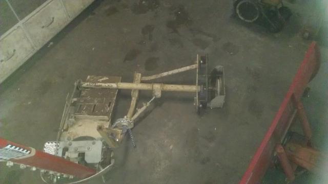

jeremi3210 688 #7 Posted March 12, 2014 So this is where iam at now. Next figure out a belt drive. Any sugestions? Share this post Link to post Share on other sites
bitten 133 #8 Posted March 13, 2014 Looks like it would mount to a D series tractor. Nice looking herd you have there, really digging that GT14. Share this post Link to post Share on other sites

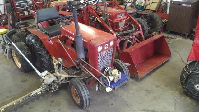

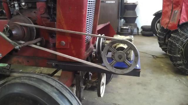

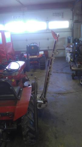

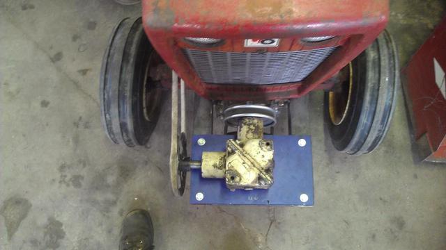

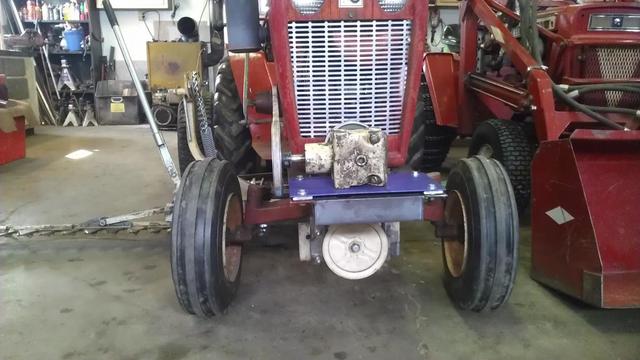

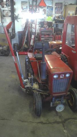

jeremi3210 688 #9 Posted March 18, 2014 So i found a gear box and fabed up a mount and it works!!! Now all i have left to do is fab up a guard for the angle box, paint, and wait for the weeds to grow. 2 Share this post Link to post Share on other sites
