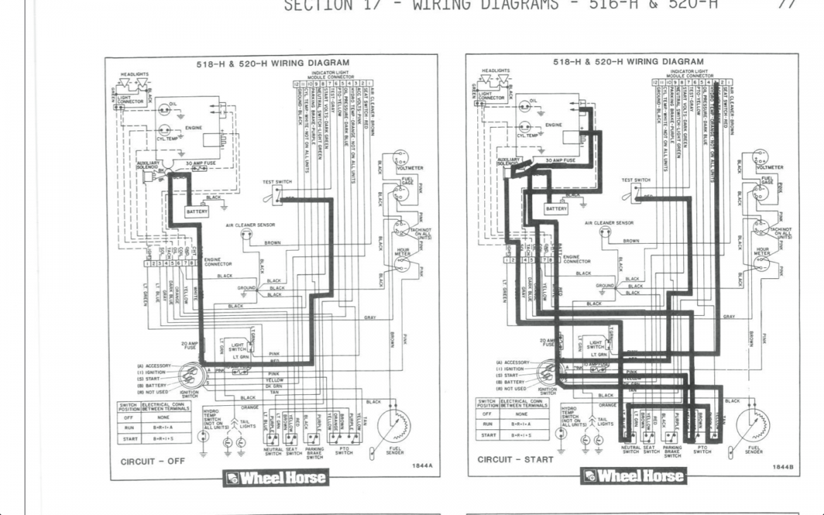

Martin 2,130 #31 Posted February 8, 2014 hate to sound like a broken record here, but have you checked for any bad terminals or connections yet.? that terminal is a fairly secure one but you have a bunch of smaller ones that need to be good to complete the electrical circuit when cranking....... the post you tested should have battery voltage all the time as it is a direct connection to the battery. the problem you have been describing is failure to turn over the starter when key is turned to start. you need to follow the electrical path from the fuse supplying power for the start circuit all the way to the solenoid terminal that should be hot when cranking. im not sure what year you have but heres a wiring diagram giving you the start circuit....... run through each wire and check for continuity and visually make sure that they all look good with no corrosion or loose connections. these models are notorious for having burnt or corroded terminals and or connectors. testing voltage is fine but if you have an intermittent connection and don't wobble it while testing, one time it will be ok and the next you have nothing....... process of elimination here...... Share this post Link to post Share on other sites

RJMcEachern 18 #37 Posted February 9, 2014 so I went out this evening after work and disconnected the battery, working one connection at a time I disconnected the connection, cleaned it with either a wire brush or emery cloth, rubbed dielectric grease on it and reconnected. I also ohm check for continuity on each wire using the DVOM, all wires had continuity. I did this on the starter relay solenoid and on the starter solenoid, I also checked and cleaned battery ground on the frame, and the connections at the ignition switch. after wards I came in and had a beer then went back out and it started! I swear it started faster, ran better and stronger (more power). I then left it outside in the freezing cold intentionally, it has always been very hard to start when left out in the cold overnight, and it started immediately. It would usually turn over real slow and finally "catch" and fire, this time it just turned over like it had never cooled off. I did wait about an hour for it to cool off in -2 degree ambient temperature. I can't thank everyone enough for thier patience and help with this issue, electrical is not my strong suit and I muddle through, if it wasn't for the assistance of you folks I would still be starting my Wheel Horse with a screwdriver. Thanks, RJMcEachern 3 Share this post Link to post Share on other sites
