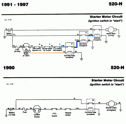

Save Old Iron 1,563 #7 Posted May 11, 2013 What year is the 520H? I do believe it makes some difference in the wiring of the tractor. I will be happy to help out and get you started in the right direction. Dan made a few good suggestions in his earlier posts. Let's start by leaving the ignition key in the OFF position. Remove the BLUE wire from the trigger terminal of the starter relay (the one you cannot get 12 volts to) Place a jumper wire from the battery (+) terminal to the terminal on the starter relay previously connected to the blue wire. The starter relay should click and the engine should exhibit strong cranking speed. Let's try that one step first, as it will tell us about the health of the starter relay and the starter motor. Also, the starter relay is about the only common item in the start circuit for 1990 and 1991 up models. Share this post Link to post Share on other sites
2fast2pass 0 #8 Posted May 11, 2013 I think the tractor is either a 1990 or a 1991 I will try the jumper to the starter tomorrow thanks for the help. Share this post Link to post Share on other sites
Save Old Iron 1,563 #9 Posted May 11, 2013 the reason the year is important is the difference in wiring for the start circuit is vastly different from a 1990 to a 1991 model. Share this post Link to post Share on other sites
