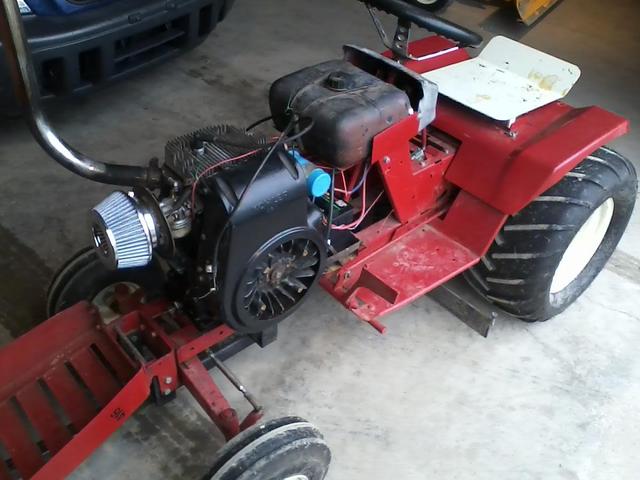

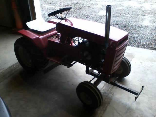

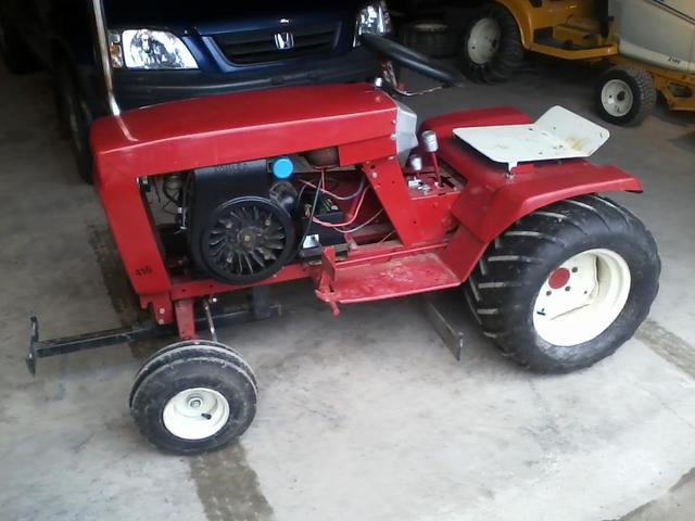

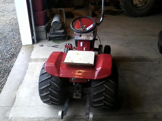

i just got my puller done for this season. its a 16hp stock class puller. im going to pull with a few local clubs and im hoping to make it to a few mid penn pulls

Looks like a very nice machine... Good Luck!
Good looking WH, you will have fun at Mid Penn. a lot of tough tractors there...including the Wheel Horses. You may need a set of turf tires to go along with the ags, on some of the tracks you will need them.
Ya I'm hoping to beat a few cubs and the guy I got it off of said he pulled at mid penn but I don't know how he did. The tires on it are 24-12-12 at101s ans I also has a set of 23-1050 super lugs and a set of 23-1050 turfs but they has some dry rot on them and I've never seen anyone pull with this turf tread thanks
Good luck with your puller, im sure you will do great. Nice looking tractor.
The AT101's are what a lot of the 25HP class run there. The 24x12x12 are not allowed in the 16hp class. You can only go as big as 23x10.50's in that class. Super Lugs are one of the best bar tires to use. As far as the turf tires you will want to use the Multi Trac style tread, they seem to work the best.
Thanks I'll probably use the super lugs because the turfs I know aren't multi trac I thinks they are good years
