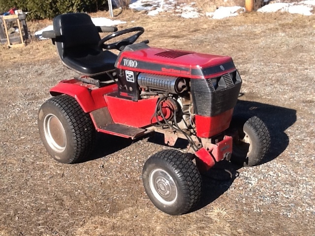

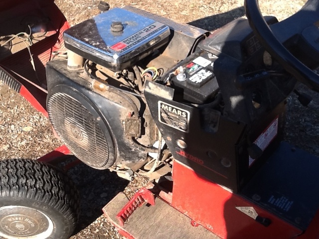

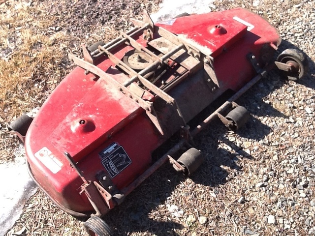

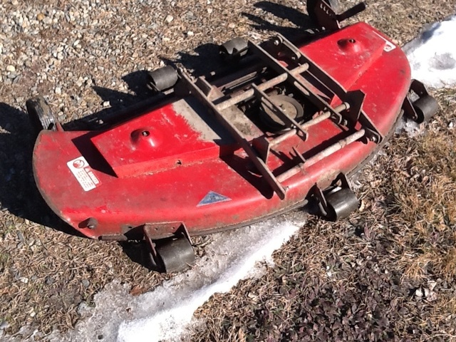

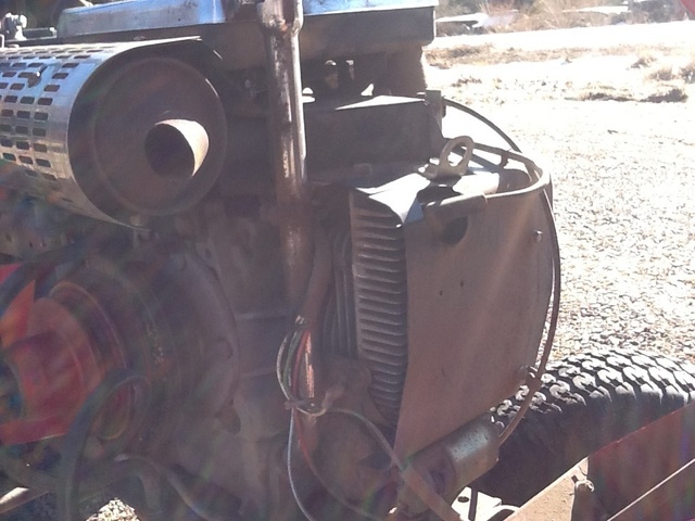

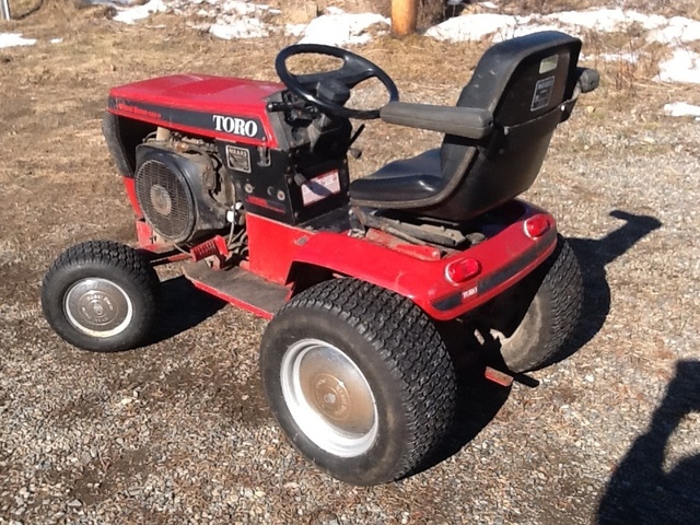

Here's some pictures of my latest acquisition.
Had to travel through three states to get (nearly 36 miles!).
No spark, missing a screw on the exhaust cover and some rust on the hubcaps.
But I think it will clean up nice!
It's a 1990 with a 48" deck
post-8342-0-95906900-1359824223_thumb.jp
post-8342-0-85206100-1359824241_thumb.jp
post-8342-0-31568000-1359824262_thumb.jp
post-8342-0-83133600-1359824288_thumb.jp
post-8342-0-23966900-1359824304_thumb.jp
post-8342-0-24422700-1359824321_thumb.jp

looks like a decent tractor. hope you get it going without too much work.
yes, i think that would clean up real nice......

Looks like it is in pretty good shape, and the deck looks to be in great shape!
Clean it up and hunt down that electrical gremlin, and you will be very happy.
The swept axle allows for the 60" deck, and helps if you ever add a loader.
I don't think gear reduction steering was added until the '91 model,
so you will get a little arm workout if you add a 2-stage blower or any other heavy front-end attachment.
Enjoy!
Looks like you found a nice one. Let us know how you make out on the electrical issues.
The original owner passed away. And I bought this off a young guy that was selling for the heirs.
It was the only one he was selling.
He had cleaned up somewhat. And put a new battery and terminal ends in it.
He told me it ran fine last fall.
I think he may have connected the battery backwards and fried the ignition module?
I jumped pos to coil, and, still got no spark. So, I took the coil out and brought it into the house to warm it up for testing.
It was very low on crankcase oil. The oil pressure light was blinking. I added a half quart of oil but the light acts the same.
Manual say it has an oil pressure cut out switch. But low oil level won't kill the ignition circuit?
