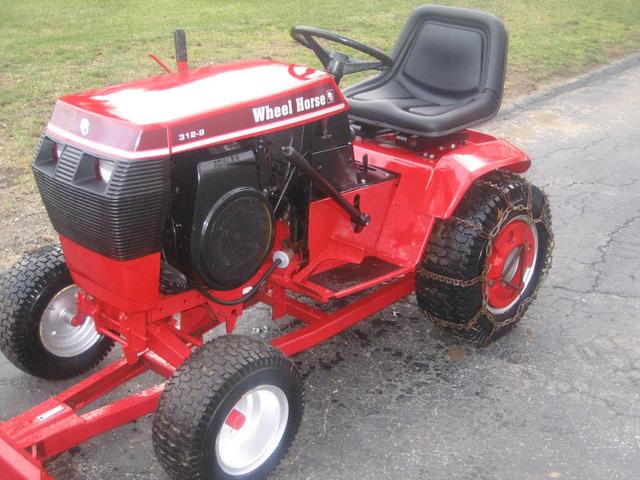

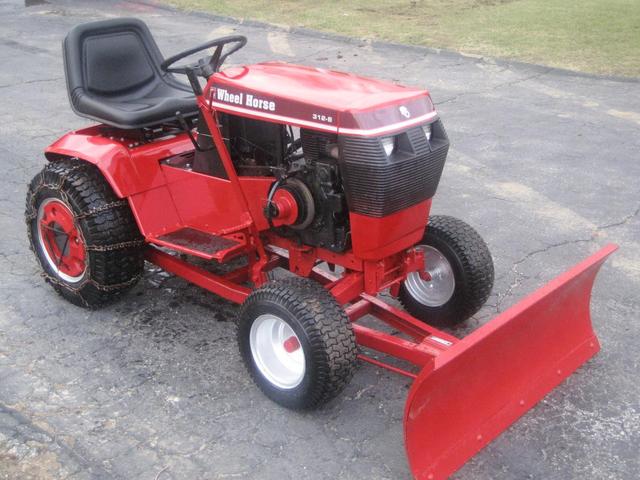

I used that style muffler on a one of the 312-8's that I restored a few years ago. It was super tight in there and when I sold it I suggested to the buyer that he replace it with the correct muffler. I knew the paint was going to heat up so I wrapped it with header tape (that is what Charles it talking about). It is a thick cloth that you can get on line. It was not cheap but did a nice job for the time I had the tractor prior to selling it. Good luck-
I had a simular Muff on my C-120 Snow chucker exhausting on the Fly Wheel side of the tractor. Well since I was useing The heat off the engine the flywheel sucked in fumes the first year and thats when I went to a stack! And as you can see by the stack on the 520 Snow Chucker Ole Duke dont play. :eusa-whistle: I nthink they look cool and gets the heat out from under the hood and just makes things run cooler. In my situation on the 520 I had to do it cause the stock 520 Muff interfeared with the snow cab. Do a stack and dont look back! By the way nice looking tractor :handgestures-thumbupright:
