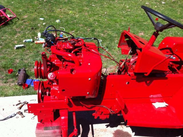

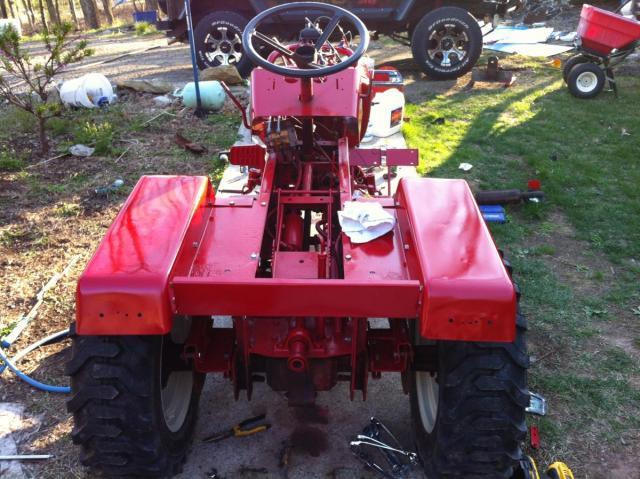

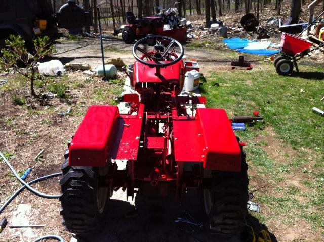

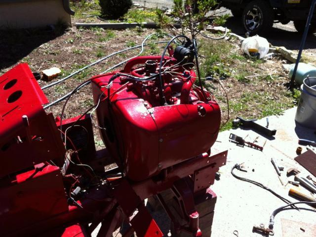

Hodge71 663 #211 Posted April 5, 2012 The reassembly process has begun...but I see now that its going to be slow....Already some issues but heres pics of todays progress, tins on the engine, rear fenders, inner fenders, got that god forsaken tongue thing off and the new 3 point brackets on. Got the turning brake calipers on but that showed me the 1st problem. Apparently someon had the hubs off the axles at some point and when they put them back on they drove them on so far that theyre almost against the caliper.... WITHOUT THE PADS IN IT YET!!!!! I have no clue how I'm going to get these hubs moved out about 1/2-3/4 of an inch. I saw what Paul went thru getting his off.... I also got my fancy fused ignition system. I will be using this to fuse the fuel pump, lighting and igniton system 1 Share this post Link to post Share on other sites
JamesBe1 80 #212 Posted April 5, 2012 Looks great Jeff. Sounds like you are going to have to make a spacer to move the turning brake hubs our further. Either that or set up as per the original intent. What hold them in place along the axle? Good luck getting them off. Share this post Link to post Share on other sites
JamesBe1 80 #213 Posted April 5, 2012 Sorry if I've spooked any of you but I guess my description probably wasn't good enough as I didn't have a diagram to use. I don't know why but the Toro diags for my exact model D-200 don't include a manual PTO. I found the answer in the electric PTO diagram so didn't look any further but having looked at earlier models, they give the diagram so..... When I remove the end bolt (17) and end cap (16) the pulley assembly can be slid off the crankshaft consisting of the outer clutch assembly, double V pulley and its bearing and washers etc. On mine it all holds together as one unit so I considered it as such in my original description. The spring clip (circlip) and washer are parts 14 & 15. The clip sits in a grove in the bore of part 13 of the pulley assembly with the washer (14) behind it. Together these determine how far the pulley assembly will travel along the crank shaft before the end bolt and cap tighten. When Lonny said: the pulley on the bottom is in the middle of the two grooves on the engine pulley .any ideas? I thought yep, remember looking down on mine and seeing the exact same thing. Having put a clip and washer in place they lined up. I don't know the exact thickness of washer required but I found one that did the job by trial and error. Hope this clears things up. Andy I just took the PTO off of the engine from my donor horse. I noticed that there was a small round piece hanging around in the back of the assembly doing nothing. I found out it was part of the bearing assembly (No. 3 on the drawing). The bearing rusted away enough that it pretty much fell apart. It turns out to be Toro PN 102914. M&D has it on special for $107.00. Ouch. Anybody got the specs on this bearing? I can't imagine it really being more than a $30 part. There is no way I am going to pay over $100 for a bearing unless it is made of some type of semi-precious metal and blessed by the leader of a religious order. 1 Share this post Link to post Share on other sites
wheeledhorseman 573 #214 Posted April 6, 2012 Looking great Jeff - I'm getting that 'deja-vu' feeling and yes I found everything took far longer than I imagined. Re the hub position, is there actually about 1/2" - 3/4" of axle prtruding beyond the outside face of each hub? I needed to get the hubs off mine to do the seals. One was actually a bit loose on the axle where one of the set screws had been slackened off by the PO (probably in an attempt to do the same job). I thought the hub would come off real easy but it didn't. I made a puller and it still needed some force to get it off. When I inspected it there was no rust but where the set screw had been done up real tight it had bitten into the axle and caused the surrounding metal to mushroom up around it despite the hardness of an axle. It wasn't much but enough to make pulling the hub difficult such are the tolerances. The hub wouldn't push back on by hand so i used some abrasive to carefully remove what in a way was a pretty small distorted area after which the hub slid on and off as though there had never been an issue. I had to give up on the second hub, the puller started to bend. Strengthened up the puller and tried again. This time the puller didn't give but I was applying so much force that there was a real danger of breaking the hub. These are a real pain! In my case I needed to pull them to do the seals and as the one I changed was leaking the most I've left the other side for now. What I'm going to try is to use the method that helped release the first side so I've just pinched up the screw that bears on the key and left the other which bites into the axle loose. I'm hoping that in time it will loosen up slightly and alow me to pull it. Looks great by the way without that appendage on the back! Andy Share this post Link to post Share on other sites

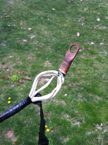

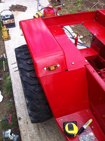

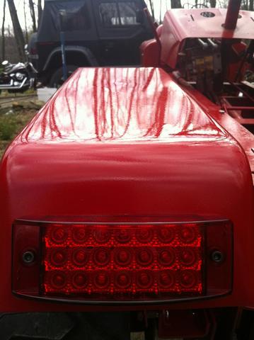

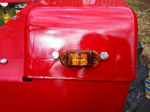

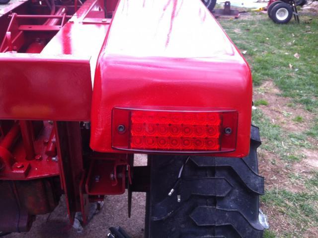

Hodge71 663 #222 Posted April 9, 2012 Todays progress was slow but steady. Found some real wiring doozies let me tell ya. Tail lights and amber clearance lights are in..... more to come tomorrow. Whoever built the homemade starter wire was a FREAKIN' GENIUS!!! Lamp cord!?...REALLY!?!!? New one cost me a whole 4 bucks at TSC!! Share this post Link to post Share on other sites
JamesBe1 80 #223 Posted April 9, 2012 Lamp cord! Gotta love (or hate) yankee ingenuity. The new lights look great. Did you get the turning brakes straightened out? Share this post Link to post Share on other sites
