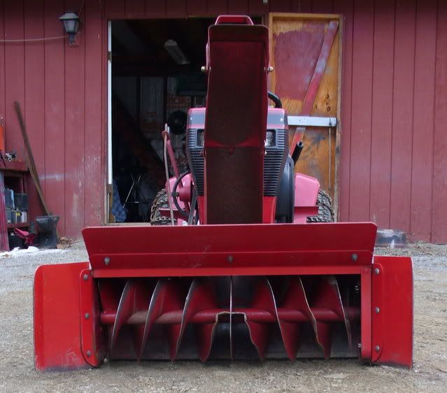

fourwheels0 191 #1 Posted August 10, 2011 can anyone tell me what model 6 6212 6 snowblower fits?. here's the pics. Share this post Link to post Share on other sites
gwest_ca-(File Mod) 12,265 #2 Posted August 10, 2011 Snowthrower 37" 1970-1973 6-6212 1-stage Basic unit Requires 6-9111, 6-9112 or 6-9113 completing pkg for long frame tractors. Your completeing package is 6-9111 or 6-9112. The 6-9113 fits the front quick hitch first used in 1973. Your ID plate shows a 6 following the 6-6212. Subtract 5 from 6 = 1971 model year. Garry Share this post Link to post Share on other sites
fourwheels0 191 #3 Posted August 11, 2011 garry thanks. ya i found out the hard way that it won't fit my tractors(c-120 and a 414-8) . Share this post Link to post Share on other sites
TT-(Moderator) 1,170 #4 Posted August 11, 2011 No point in when you can either rework the existing hitch on the thrower or install the "correct" one to work with the Attach-Matic front hitch. Share this post Link to post Share on other sites
fourwheels0 191 #5 Posted August 11, 2011 TT thanks but i think i'm gonna get rid of a bunch of stuff and just get the correct and bigger blower for my 414-8. the one i have i got with some other stuff and thought it would work. oh'well i'm learning every day. Share this post Link to post Share on other sites
TT-(Moderator) 1,170 #6 Posted August 11, 2011 With the exception of gauge wheels vs. skids, the thrower you have isn't really much different then the newer ones. It's also the widest single-stage you'll find - you just need the extension plates ("wings") to make it 42". I know it's entirely your decision, but (other than cosmetics) your thrower looks to be in decent condition - and you already own it. :woohoo: Share this post Link to post Share on other sites
fourwheels0 191 #7 Posted August 11, 2011 TT that's true i do already have it and it is in good shape mechanically. where can i get the correct hook up to use it on my 414-8. are they available new or would i have to search for a used one?. maybe i could find one used and trade some stuff for it. thanks for your input and knowledge on this. Share this post Link to post Share on other sites
