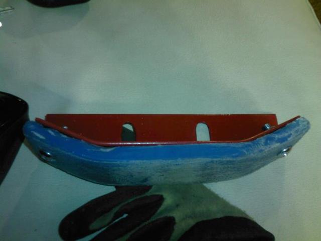

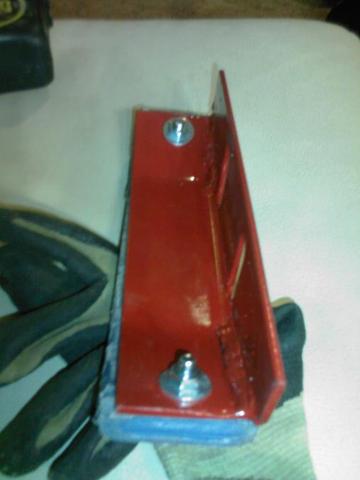

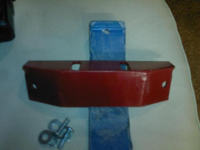

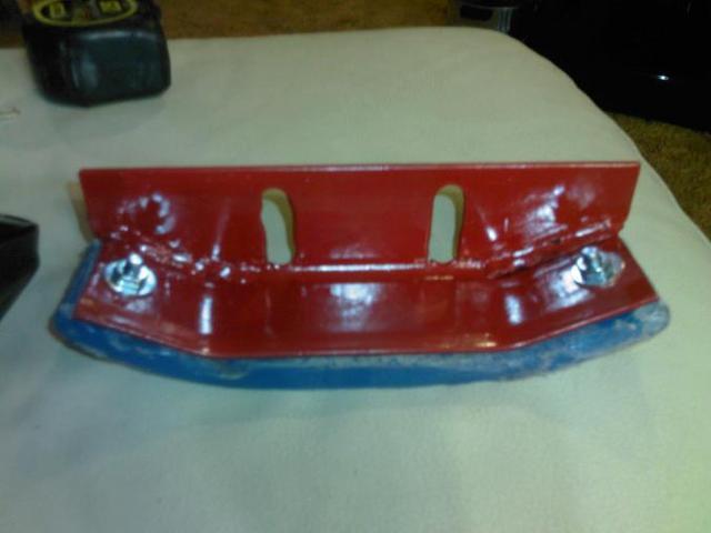

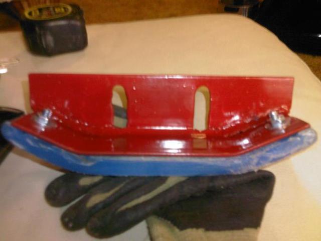

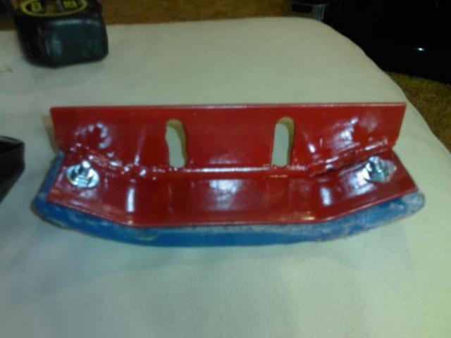

I have not finished both skis yet. Been doing the typical holiday stuff. I would much rather be tinkering in the garage and shed. Basically I am taking a piece of 2 inch angle iron and putting it over the top of the stock wheel horse feet. I cut slots in it just like the standard feet so I can adjust it up and down. I then cut a 2 inch wide strip of the cutting board I stole...um borrowed from the kitchen. I am putting it under the bottom of the stock feet. I melted the ends to bend upwards and drilled holes to mount it to the angle iron on each end. Basically I made a sandwich with the stock foot in the middle. I wanted the ski to angle upwards on the front and back to ride over bumps better.
Having said all of this, if it works out okay, I plan to completely remove the stock foot. I will take my piece of angle iron and cut the angle and bend the ends up slightly. Weld it in place, hack off what is essentially flat bar that is now hanging below my welded up end, then bolt on my piece of cutting board. I don't know if that makes any sense to anyone. Basically I will make an actual ski. Sorry I don't have CAD on my netbook, had to use paint instead. My first very basic attempt is more for checking how well the cutting board will work.

Well there is no snow here so I got some work done on a ski last night. I finished my original build of sandwiching the stock foot. It did not go up high enough and left the blower about and inch and a quarter off of the ground. I scrapped it. I started building version 2...replacing the whole foot with my ski. It was a pain as my welder intermittently would stop feeding wire in the middle of a weld. I ended up welding with one hand and wiggling the circuit board inside the welder with the other. It made a messy weld, but I got it done. My gas regulator was not cooperating at first either, I had not used it in a long time as I typically only use it when I do stainless. Well after several hours of diagnosis, cutting, bending, drilling, and painting I finished one ski. I wanted to make sure it would work before I made a set.
Here are the pictures. Only using my camera phone. I painted with krylon cherry red. I plan to powder coat in the future. I'm just waiting for a free CL oven to pop up. I think they will work great with the replaceable plastic strip...now I just need snow. No scratched driveways!!
