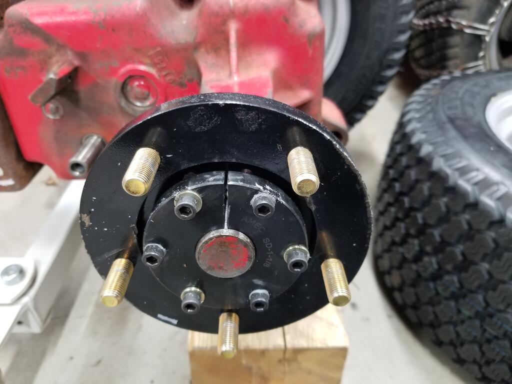

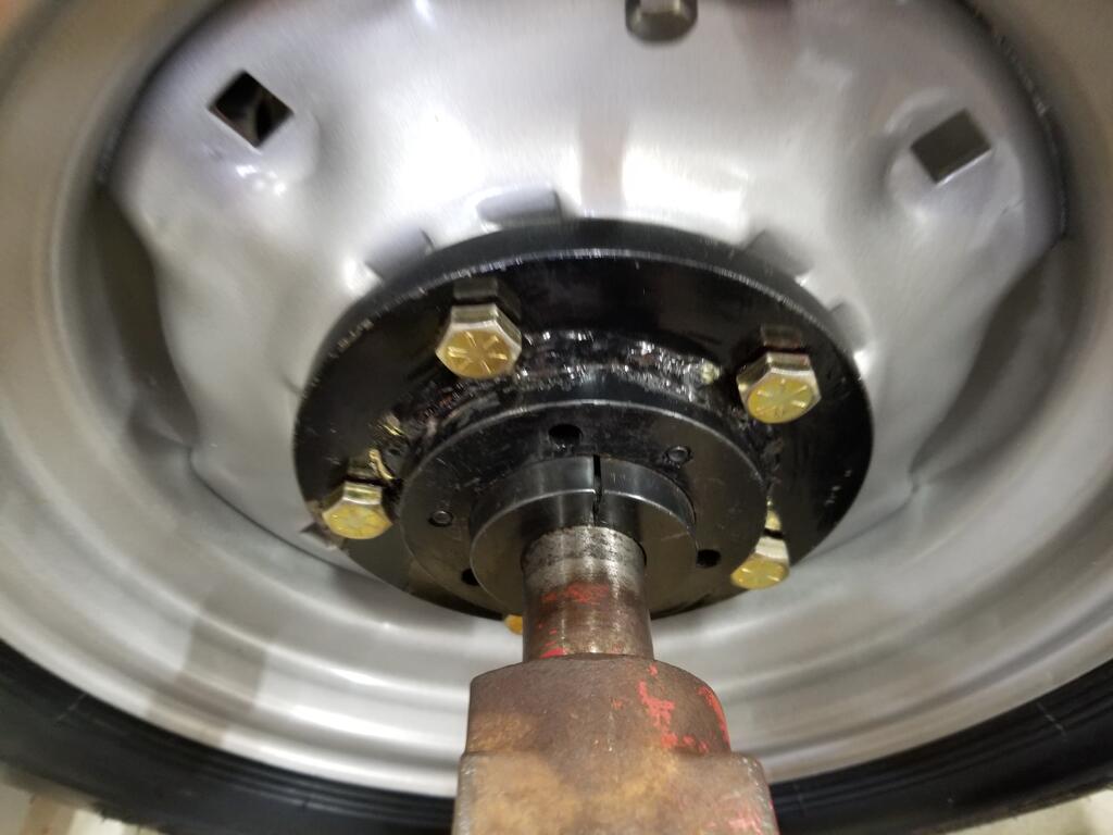

Wild Bill 633
A-Z offers wheel hubs for both 1" and 1-1/8" axle shaft diameters. I purchased a set of 1-1/8" hubs. They are manufactured from a SD QD bushing and weld-on hub which are rated at 5000 Lb-In when the bushing screws are torqued to 108 Lb-In.
A 1/4 X 1-3/8, #22 woodruff key, P/N 937108, made of 1018 CD material is rated at 2256 Lb-In. Torque (Lb-in) = Length X Diameter X Width X Yield Strength / 12 = (1.375 In.) X (1.125 In.) X (0.25 In.) X (70,000 Lb/Sq. In.) /12 = 2256 Lb-In.
The QD bushing is designed like a collet that grips the shaft. The bushing is rated over twice that of the key and can transfer more torque than the key. An absolutely beautiful design.

Great photos.  Thanks.  Looks like I’ll be ordering a set
