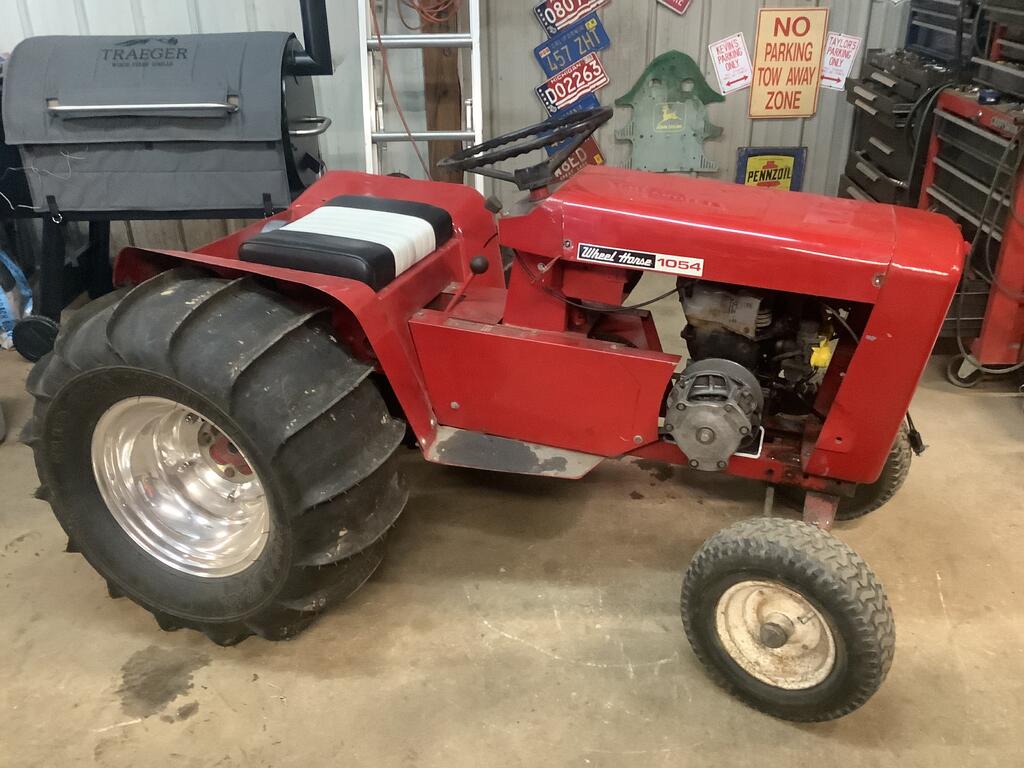

Winter fun - Project “Freedom” 440cc 2 Stroke 1054 Snowmotractor
bds1984
3 hours ago, Pullstart said:
To answer your question Lee, it’s rated to pull just under 8,000 rpms and apparently hp ratings weren’t ever published by the manufacturer but it’s speculated to be around 70-75 hp.
I had many 440 Suzuki Spirits in various Arctic Cats over the years and they're rated 41-50 so I would speculate somewhere in that range.  The real fun one was pulling the 440 out and placing a 634 Hirth twin in its place.  Torque for days.  I don't think I ever saw a 440 put out that much HP unless it was a built and tuned liquid cooled model.  Regardless, 3-4 times the power is going to be fun no matter what!

That is believable.  I read the 70-75 and thought “wow, I’m surprised!” But in all reality I’m glad it’s closer to 40!:lol:  better chances it sticks together!
Oldskool
 I've been wondering to myself for a bit now. Thinking about that primary clutch.
Would it be beneficial to thicken the inner disc half to close up the gap on that belt? Maybe turn out a piece to match or use a piece from an old primary?
Just a thought.
Just a thought.
the belt seems to fit the pitch of the clutch quite well. I think I’ll try it all for now the way it is… and if it seems too slow I’ll chuck the plates up and take a little off the inside to in theory build a larger final drive diameter if that makes sense.
Oldskool
Yes, that makes perfect sense.
I was just thinking if the inner plate was thicker it would close the gap on the belt a bit for low rpm contact.. I wasn't sure when activated if it would act like an automotive "high stall" converter and kick in all of a sudden?

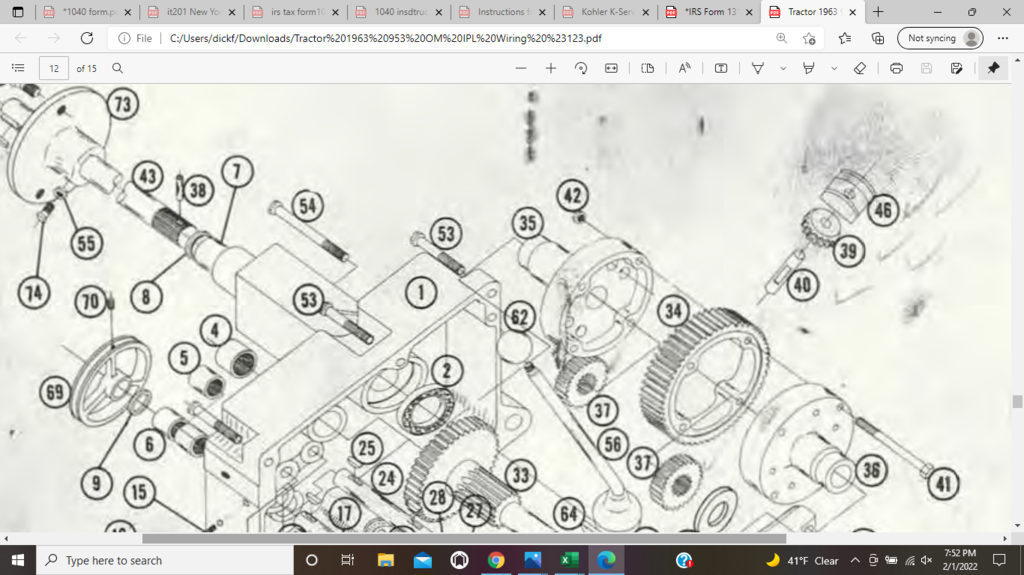

11 hours ago, Pullstart said:
 It also has an aluminum differential
953/1054 have a cast iron bevel gear differential. The early limited slip units have aluminum end plates on the differential.
Well there we have it.  I need a turbo @953 nut!  :lol:

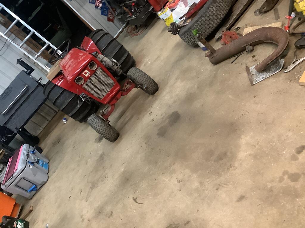

I found a shovel and broom!  @formariz I think we all know I’ll never get to an organized point of zen, but it still feels great to move some unneeded things out back and be able to walk around my toy!
  • Haha 2
Before or after you used quantities of tannerite to get that mess out of the way?
What mess?  I see organized chaos.
