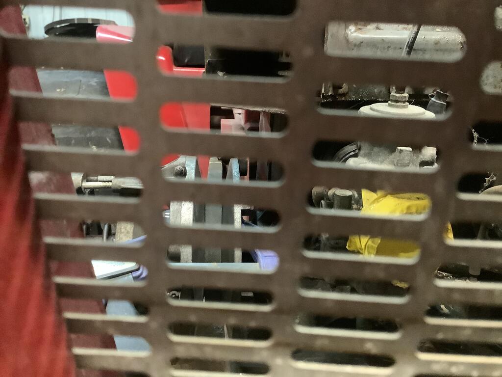

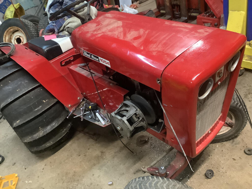

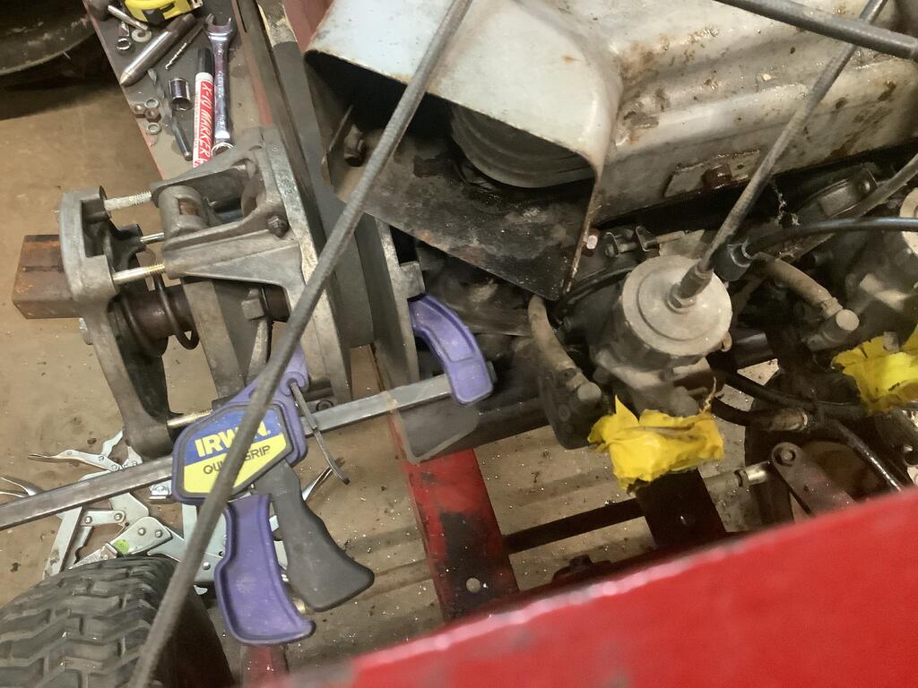

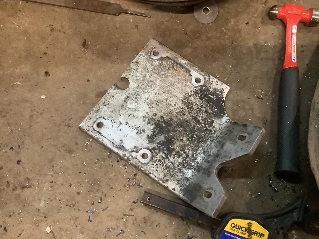

Using the old engine plate as a template, the 2x4 tubing is bolted to the engine.  It’s close to where it should rest for good.  The belt is NOS WheelHorse and has a little bow in it from years of being coiled up.

Will that 5L belt hold up to the torque converter?
Are you also switching the transaxle pulley to the complimentary variable driven pulley or is the idea to make it only as a centrifugal clutch?
I know only one way to find out.  Hopefully, it lasts at least across the driveway!
I’m going to allow the snowmobile clutch to simply tighten onto the belt.  The idea is once it is completely clamped (as in high gear on the snowmobile) the belt will be taught and have nowhere to go but fast.
Yes, my fingers, toes, hairs and eyes will be crossed upon that initial startup!
  1. I realize the demands I’ll be placing on the belt are not the design of the belt.
  2. A snowmobile has much more surface area for grip.  I’m planning on enough tire slip at first throttle to hopefully make it past that first demand.
  3. with no ground engaging action (Sorry @SylvanLakeWH, I’ll not be plowing the garden with this one!) I’m hoping there will be less overall stress and load when under way.
  4. There’s plenty that can go wrong.  Other than time and energy, I’m not $1 into this project as far as new acquisitions.  If it all gets scrapped (the ideas, not the materials), no harm no fowl.

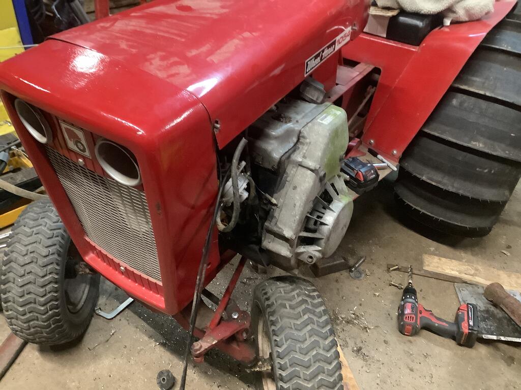

Engine and belt guard are bolted in.  @Snoopy11 It surely sticks out a ways on the driver’s side… but it’ll likely be worth it!
