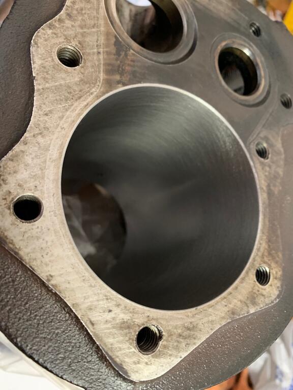

Tuneup
Hi all!
Reviving this thread now that I FINALLY got this thing bored and honed.
That phone number from NAPA for a local with a machine shop? Sweet woman answered and said, "Robert who?" Ex-wife? Well, that was a dead end. In this post-Covid Georgia, few shops remain. Either that or we're just a throwaway world. I had to drive out to Braselton for the .020 bore and hone of my K301.
Called Engine Services on BBS Way - booked for the year, sorry. "How about a bare block, old cast iron single?" He paused and said to drop it by. Good guys. Bonus that they're just 500 ft. past Road Atlanta - an old stomping ground (visitor at the AMA races). I miss that Suzuki and the weekend shenanigans. So, 2 trips and a total of 6 hours in the car with a wife that is understanding and insisted on keeping me company and I have a really beautifully bored short block back on the bench. It really is a thing of beauty. I've never had an engine bored and may just use it as a door stop and cast my eyes toward it now and again or . . . install that piston this weekend.
Highly recommended. Oh, he asked what the engine came from (1980 C-125). Told him the bore measured within spec at 40 years of age. He said it's not surprising - that iron is dang hard! $150 well spent.
Who's that lister that lives in Flowery Branch - you lucky sucker!
I'll finally get all these engine parts off of the garage floor and should have this beast high idling by the end of the month.
