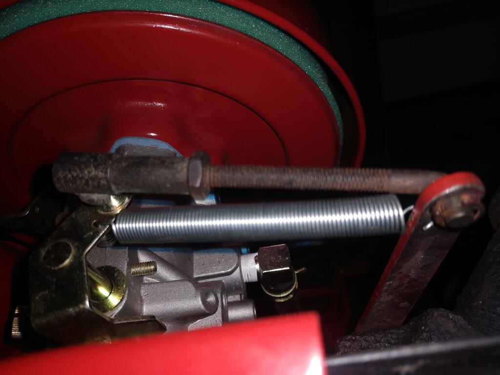

kpinnc
5 hours ago, Jeff-C175 said:
By the way...  it is absolutely amazing to me how much difference moving the governor spring up one hole on the governor arm can make!
Yes sir you are correct! Huge difference in govenor response!
This, and adding the spring between governor arm and throttle made a massive difference in the Charger's performance.
Plain and simple- these machines have wear in the linkages aside from internal wear. You can get a good runner, but sometimes they need a little extra to keep going!
Edited by kpinnc
Jeff-C175
I added a small spring from the throttle over to a small hole that was in the top of one of the tins.  I think I posted a pic of it in one of my threads, maybe this one?  (yes, page 2)
I think it achieves the same net effect, keeping the throttle from 'bouncing' around due to play in the linkage and the throttle shaft.
Edited by Jeff-C175
