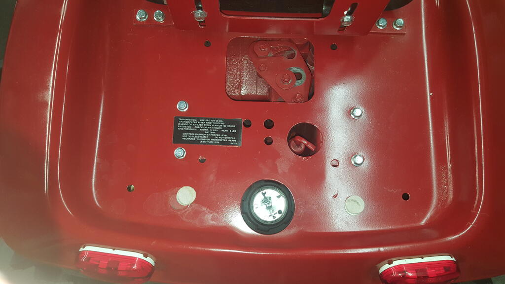

My 175 has this hole above the hydro pump in the fender pan (from an unknown model):
Also note that there's no hole in the seat 'cradle'.

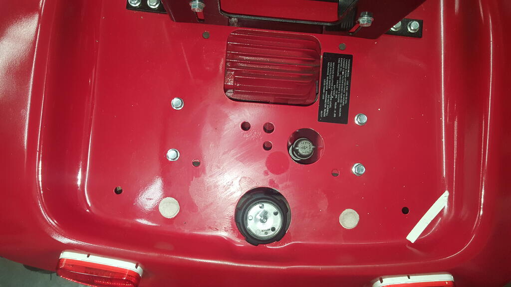

This 125 pan (also from an unknown model) does not have the same hole cut out:

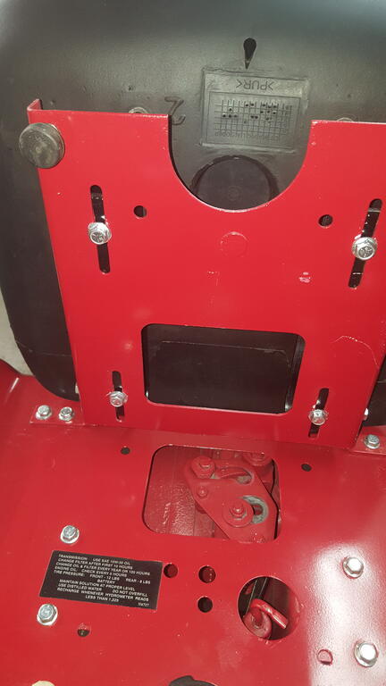

Also note that the hole locations are different.  Where the seat switch is on the 175 there is no hole on the 125, and there's a couple 'extra' holes on the 125.
But oddly, the seat 'cradle' DOES!  (I believe this is original to the machine)
What's the deal with these differences?  What's the purpose of the hole in the seat cradle?  Or, for that matter, in the fender pan on the 175?
What holes did the original plastic fender pans have in them?

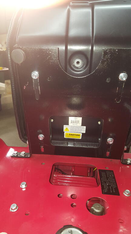

Seat pan and cradle from the 175. I believe it originally had the plastic fender pan. Really no use for the large square hole with the Sundstrand trans.
20211202_020616.jpg.22b534e920c78a17e7a52359558b94df.jpg20211202_020631.jpg.5be40344a92688bdc3720f213bf9b853.jpg
Fender pan and seat from the 125. The large square hole allows access to the Eaton trans for adjustment20211202_020649.jpg.6891ed2f89921bb557cb3f3eac9c03d7.jpg20211202_020657.jpg.5e9205e45b9e6c4b1ea56c68b5b8dfa2.jpg
As far as the original plastic pan, it is long gone. Too bad to save.  Note the small felt stickies on the pans. This  is where the seat cradle springs rest. Saves paint. Is it possible your seat springs a in the wrong place?
Well, I don't know!  They're where they always were on my 175, I never moved them.  I'm the second owner and know the history of it since new.
Is it possible that yours are in the wrong spot?  :ychain:
OK, so the fender pan on my 175 came from a machine that had an Eaton.  Gotcha...
And the one on the 125 probably came from a machine with a Sundstrand.
Maybe the seat cradle on the 125 is NOT original to the machine... I have no way of knowing that.

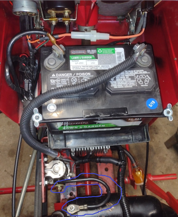

Sliced open a piece of heat shrink because I'm cynical... I don't believe this is acceptable!  :rolleyes:
So of course that means I needed to go over every inch of wiring.  Besides, it was all tangled and twisted.  There were a number of crimp butt splices and other 'questionable' wiring.  So now it's all cleaned up and ready to go:
Those with very keen visual senses might notice an error that I made!  Need to fix that.  Works fine... if you're standing on your head!  This is a test!

My only gripe, @Jeff-C175 is that the wire from the starter solenoid to the starter is suppooosed to be Red...
Just sayin... :teasing-neener:

Jeff-C175
Fixed it for ya, and the others also.  But that's not the error...  the 'standing on my head' part was a clue!
Actually the two smaller wires ARE red, under the heat shrink tubing and inside the split loom.
That starter cable was in such good shape that I decided that I didn't care if it was black.
Snoopy11
Jeff... that is just cruel... you had me going there for a second... I thought you actually changed it to a red wire. Second look revealed that you committed tracery...  :laughing-rolling:
Anyway, you could always buy some red electrical tape if you wanted to make it right... :P
