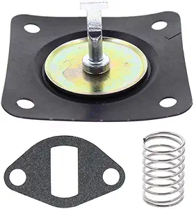

Looking around for the fuel pump kit I happened upon this :
I know the circled parts are for the fuel pump, but what about all those other doo-dads?  They look more like carburetor parts to me?
Is this a kit for the fuel pump AND the carburetor?
Snoopy11
NOPE! I had to edit my post here, as I misread your post, Jeff. Now that both my eyes are open... @pfrederi is right, those others are carb gaskets which would be good to have on hand... There isn't a lot of information on pump rebuilding out there... It'd be nice if you took some video/pictures... :P
Just sayin' :teasing-neener:

pfrederi
No!! it is a mix the top 4 gaskets on the left  are Carb to engine and air cleaner base to carb body.  Next 2 are bowl gasket and splash guard.  Bottom two one is for the bolt that holds the bowl on and one for the float valve seat..  No idea what lower right scrap piece is ...
@pfrederi... you are 100% right.
I misread Jeff's post. I thought he was talking about the items he circled as going to the pump. Considering the other parts... yes, those are carb parts.
My bad. Can't be accurate all the time... :P

BUT, Jeff, if you are wanting to rebuild the fuel pump... why not just buy this kit? :confusion-confused:
Unless you are really wanting all the other... stuff...? :scratchead:
Carbhub 230675 Fuel Pump Rebuild Kit with Spring for Kohler Onan Tractor Generator K301 K321 K341 K181 K161 Engine Replaces 230675

I will say though Jeff, when I look up part number 230675, I know what you mean about varied results in products... :ph34r:

Gregor
I have been trying to figure that out myself. :confusion-confused:
Snoopy11
Odd thing is, it only comes in the MotoAll brand kit... :dunno:

Jeff-C175
3 hours ago, pfrederi said:
No!!
Isn't that a YES Paul?  Parts for the carb AND for the fuel pump?
I got the kit yesterday.  That scrap piece is NOT in the package!  Probably something that was in the package they sent to the photographer and he didn't know any better!
Because for only a couple bucks more I get all that other stuff too!  Whether I need it or not!  ... and I do plan to fool with the carb eventually.
The only place that I can find where you can get each one of those parts is:
And from what I've read, the check valves are not easily replaced!  I just want to change the diaphragm and the gasket to the engine.
