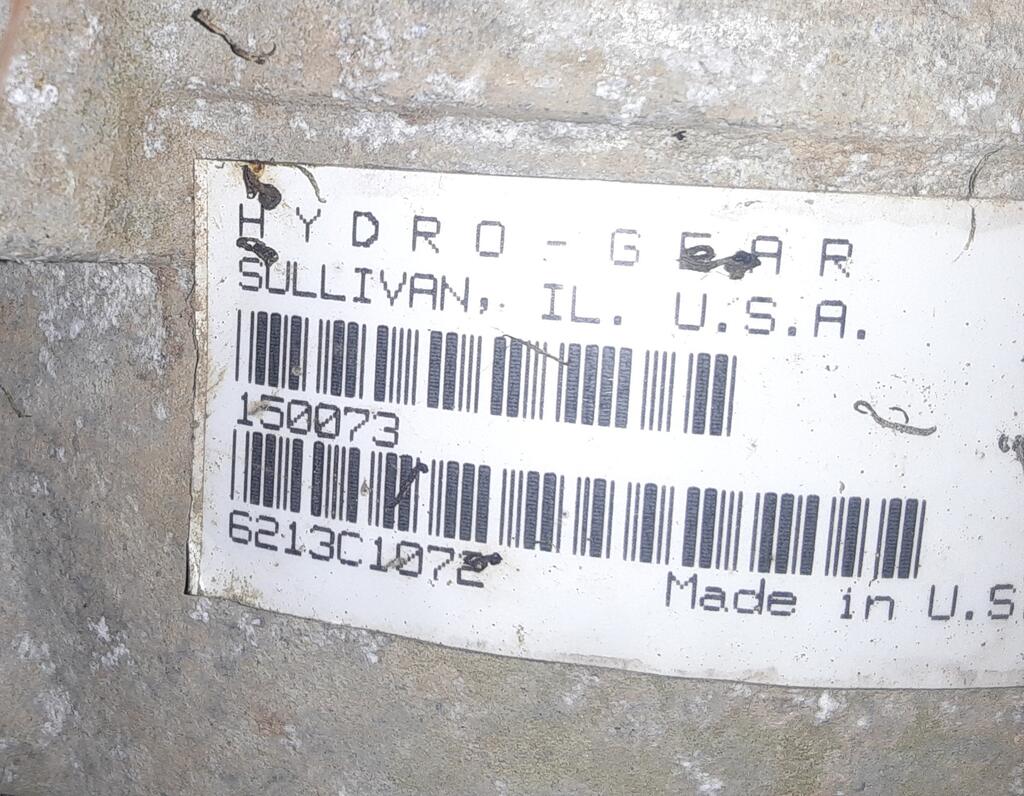

14 hours ago, Oldskool said:
Any input on this?
Hydro-Gear is quite hard to research.
This unit predates their current model line and has the "old" label layout and coding. I couldn't find specs, only parts diagrams.
The model is 157003. The other code seems to read Year 6 (2006?), Day 213, Product C1, SN 072 (for the day)
Pretty sure it was used in Simplicity lawn tractor units with 16-18 hp.
Can you send me a picture of the complete unit?

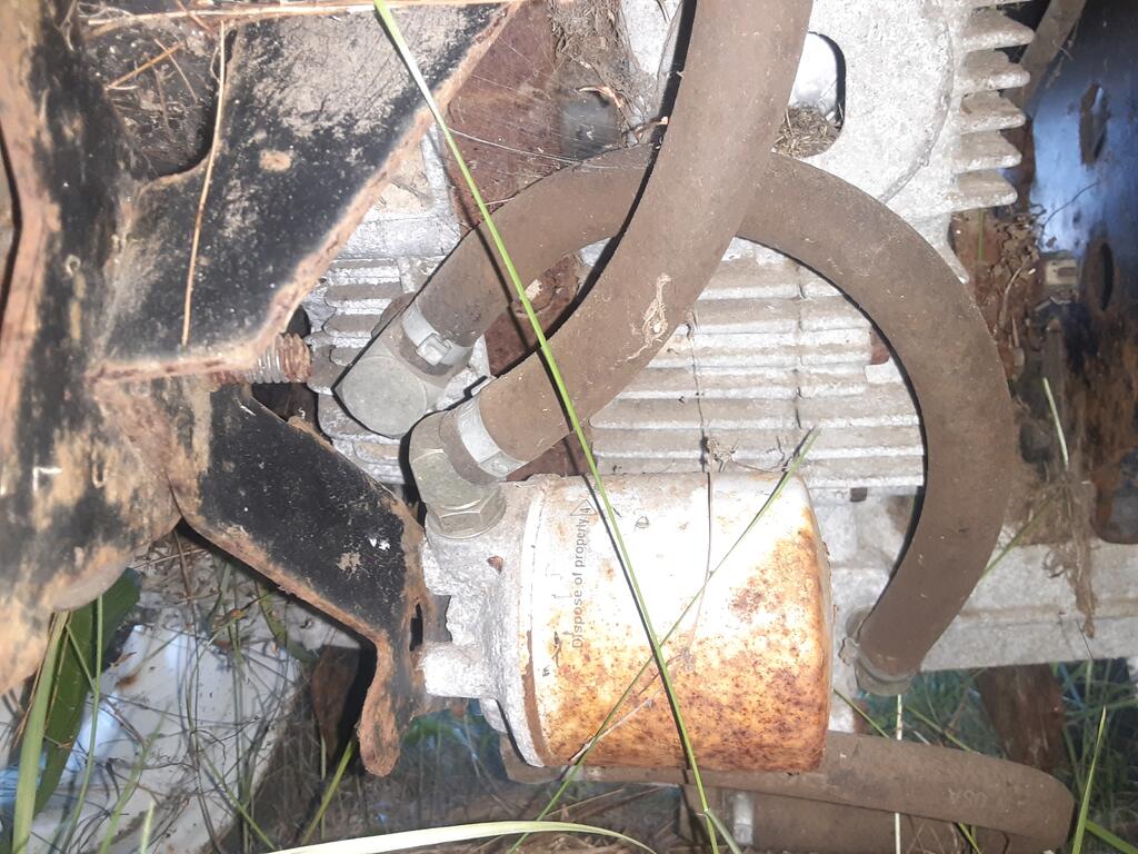

Not a good pic but how bout this?
This perspective isn't much help in matching to illustrations but having an external filter and the extra hoses seems to indicate it had a separate charge pump and, possibly, had external hydraulics. This may be one of the larger units, some of which even had differential locks.
Probably this thing is embedded in something so good pics will be hard to come by, eh? :)

@Handy Don that rear is in a large Craftsman. It does have 5 lug hubs though. It would be hard getting better pics at the moment.  I was told it could be tapped into for remote hydraulics

Luckily it still has the tag on the housing but I'm about 200miles from it at the moment

It may be possible to get the transaxle data via the Sears site if you can get the tractor's model number. The largest Sears tractors were quite strong machines.
I found this one on eBay which looks pretty close...
Handy Don
Boy are you lucky. Via the eBay listing I found some threads on another forum and there found links to the Tech and Service manuals (assuming this is what you have). This is listed as an "HD" (heavy duty) transaxle.
Definitely has option for external hydraulics (1.5 gpm @ 500 psi) -- not as strong as the Eaton 1100 but still handy--with an open center control and 500psi pressure relief.
