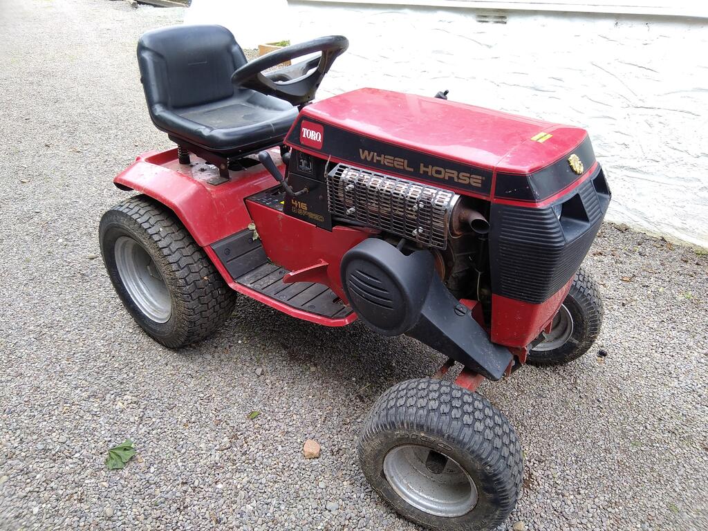

I found another one at a better price ($500).  The Onan has been rebuilt but I don't know how long ago.  Looks complete and better than the one before but certainly not a Garage Queen.  It's a suburbia unit so probably not pushed too hard but it will be a couple of weeks before I can peek at it.  When I worked for Toro/Wheel Horse in the early 90's I remember the Onans losing their lower ends.  Can't remember the exact problem or cause; as the saying goes: "I've slept since then".  I could settle for a nice 300 eight speed "Classic" series but I'd like to get something a little bigger. Deep down I'm a Round Hood fan but I prefer a bit more power and size. I have a C-111 eight speed with a dead Briggs I could get motivated to repair but it only has a 36" RD deck besides I need something I can use now.   I fear my little Troy Bilt Pony has got about 5 years of steady use is probably getting close to imploding.
