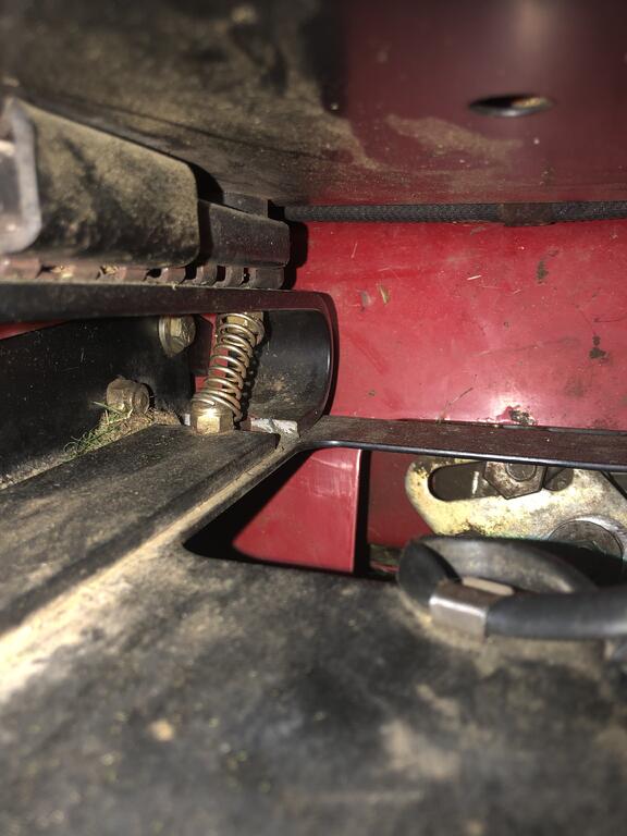

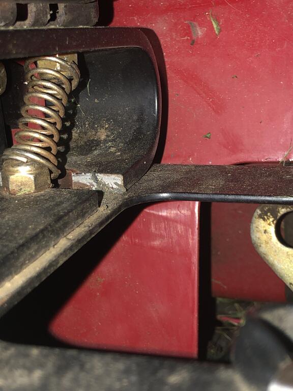

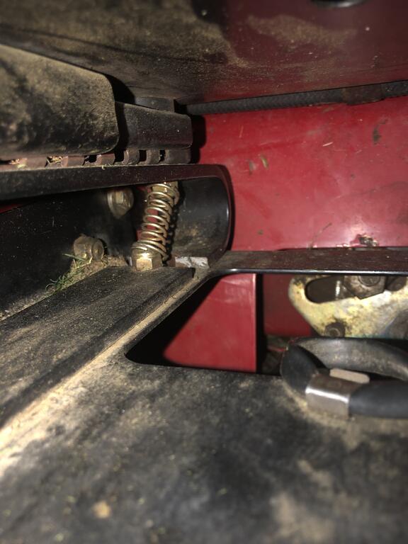

I just keep having problems with this beast!  I was driving the tractor and noticed the angle bracket (left) that mounted to the body of the tractor cracked.  I was able to find something close to repair it.  Not too long after that, the spring cracked!!!!! No idea how the hell that even happened!
I hope that its just not me having these issues!  Anyone have any seat hardware that they can part with? Anyone have any fixes or advice on how to deal with this?

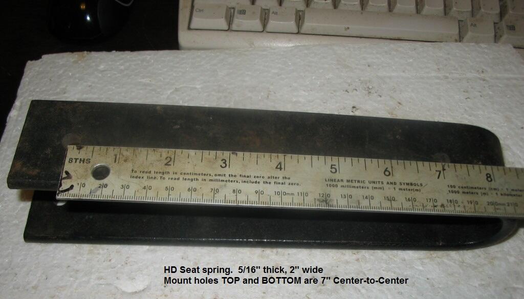

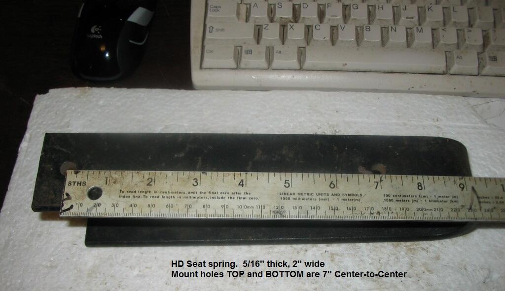

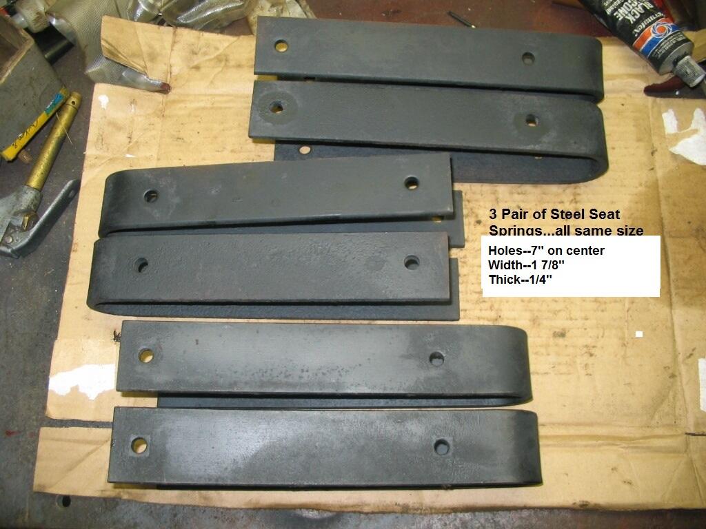

Did you measure the holes Center-to-Center...??  I have.... and even the smaller/thinner seat srpings are 7"...center-on-center.
Here are the other smaller/thinner sets...all the same size and ALL with 7" center-to-center drill holes.
