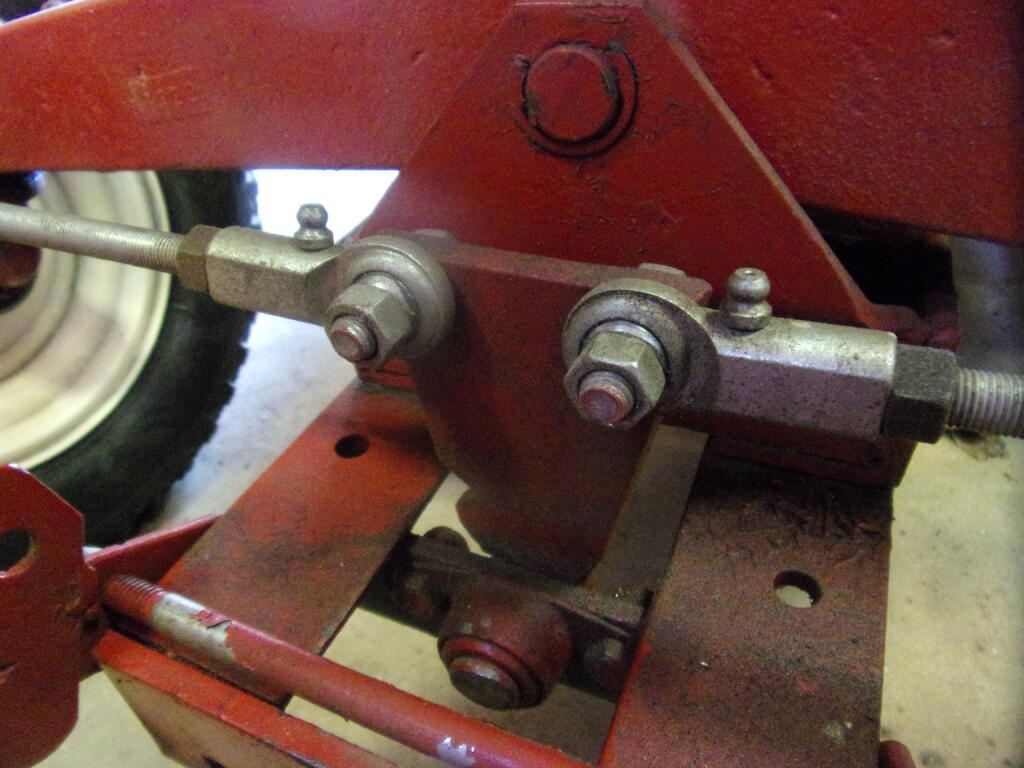

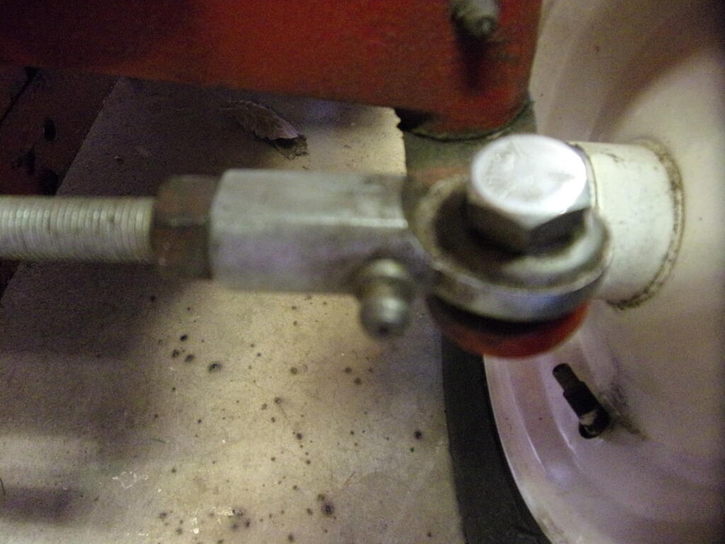

Ed Kennell
On 5/20/2021 at 8:17 PM, roadapples said:
@Ed Kennell made his own also...
I used the Mc Carr 7/16" greasable Heims and 7/16" bolts and rod.    No issues at all.
102_3003.JPG.3ba989ea3358bd436545a3948f05a168.JPG102_3004.JPG.bc5c2e636f3541e55b82532b31556af6.JPG
Edited by Ed Kennell
  • Excellent 2
