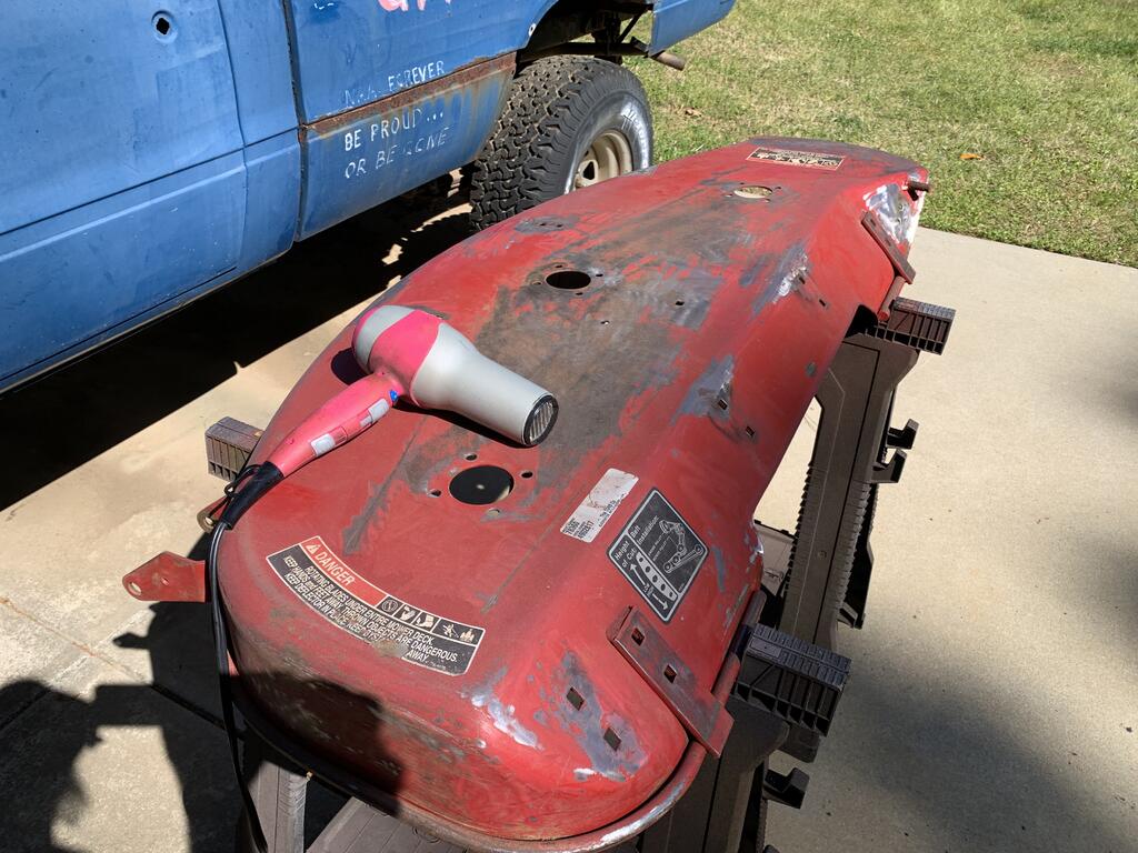

Almost there... ground off the ugly and gave it a coat of paint.  The areas not painted are where I'm going to weld the bottom of the gauge wheel rod brackets to the new rod.  I found and repaired some cracks around those bolt holes also so decided to do what WH did with the later decks and weld those plates to the rod.  That should move the stress from the wheels to the rod and away from the deck shell.

I would like to, but there's a problem with that.  This shell was beat to h377 by P.O., bent and twisted (like me!), and I've straightened it as much as I was able.
The blade tips are too close to the rear apron to allow those bolt heads to protrude any further than they already do.
