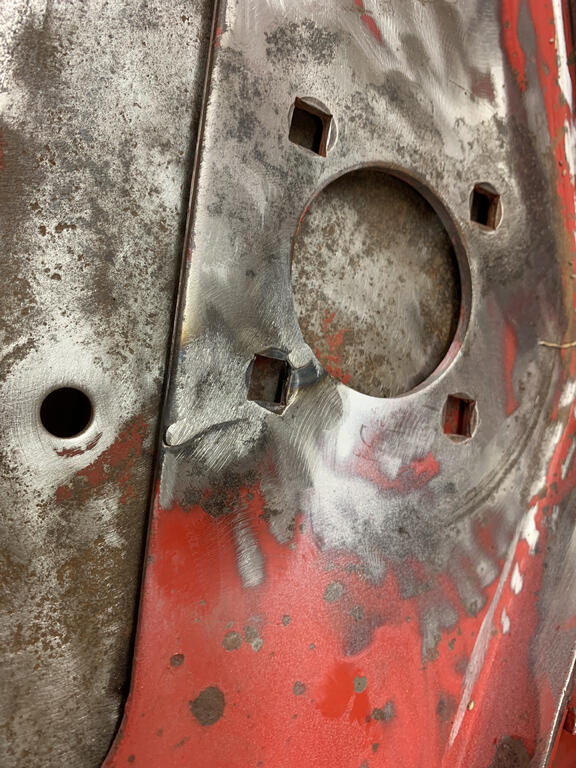

@Jeff-C175   While I was at the welding shop today I had my welder do a dye test on that place I thought was a crack and it was a crack.
You said it didn’t have any where to spread, but actually it crossed the spindle bolt hole and continued on the other side of the hole:confusion-confused:so he welded it up... I’ve never seen that!
  • Excellent 1

On 10/18/2021 at 12:06 AM, Jeff-C175 said:
So it seems that the wide plate they went to didn't really 'fix' the issue.  The cracks in mine, and most of the 48" decks I've seen are exactly the same as shown.
I think that the problem is that when the deck is raised it 'twists' that rear apron and ultimately cracks develop there.
I thought of a 'gusset' to prevent the twist that causes the cracks but as mentioned in the earlier post I think this would only move the crack prone area.
In this case, the blue lines show where the stress would move to.  That gusset would pull DOWN  [ EDIT:  NO, it will push UP ]  on the top surface and probably  eventually crack there.
I don't know that there is any good solution to this problem!
Revisiting this thread because I've now got my deck on the sawhorses for repair of those cracks.
After carefully examining every wear pattern on the lift linkage I've come to the conclusion that the rear bracket twists the rear apron DOWNward when the deck is lifted, and NOT UPward as I previously assumed.  Seems counter-intuitive but that's what all the wear patterns are telling me.
That being said, I'm going to fashion a gusset plate out of 2" wide X 1" high X 3/16" thick "C" channel and install that on the inside of the rear apron and see if that will prevent the cracks from returning, or just move them to a different area.
Material should be here by Tuesday, after which I'll fabricate the brackets and post some pics.
Also, the round bar that WH added around the perimeter of the deck should have been continuous, all the way up and over that rear apron as well.  I'm probably going to add that myself.
