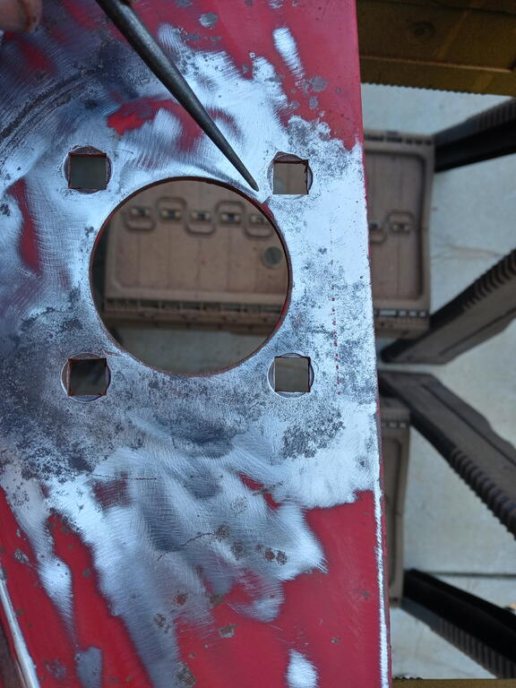

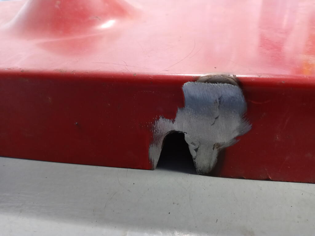

I noticed another crack that we missed on the triangle shaped , 3/16th inch thick piece that sits on the top of the deck...back to the weld shop !

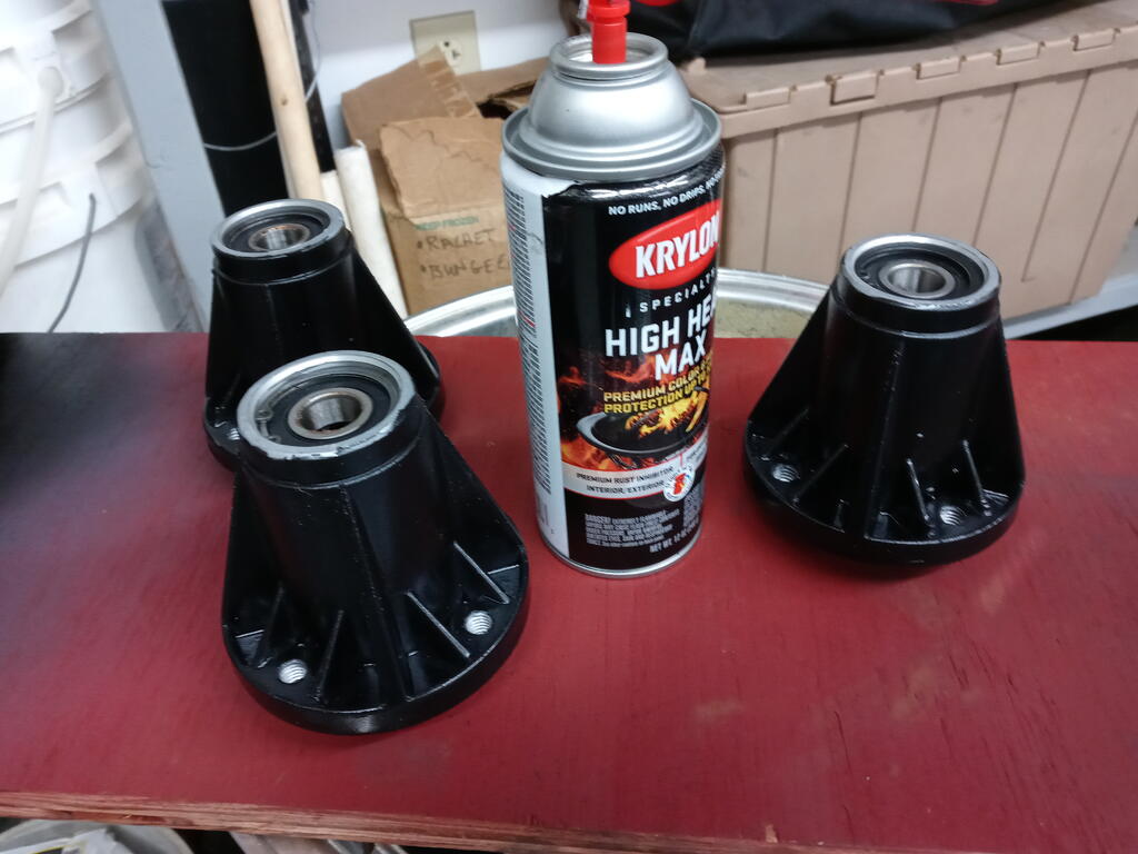

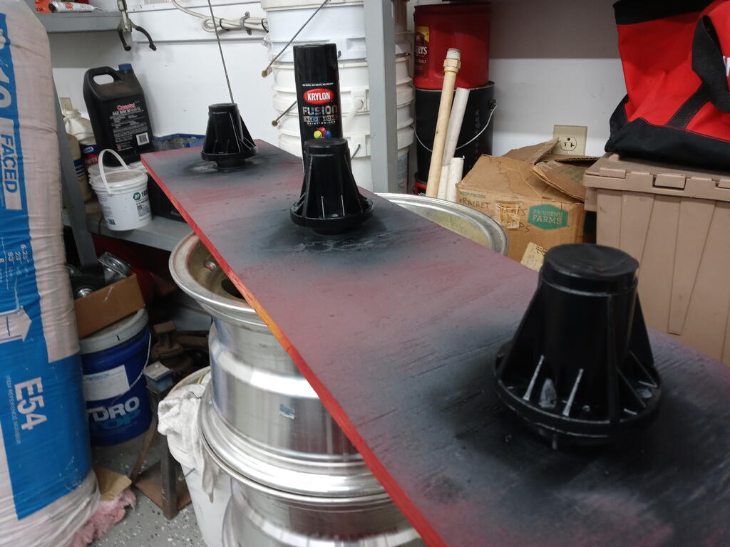

Primed the new spindle housings for the deck...I' ve heard painting the housings will help slow down the corrosive effect of grass clippings... I figure it can't hurt...

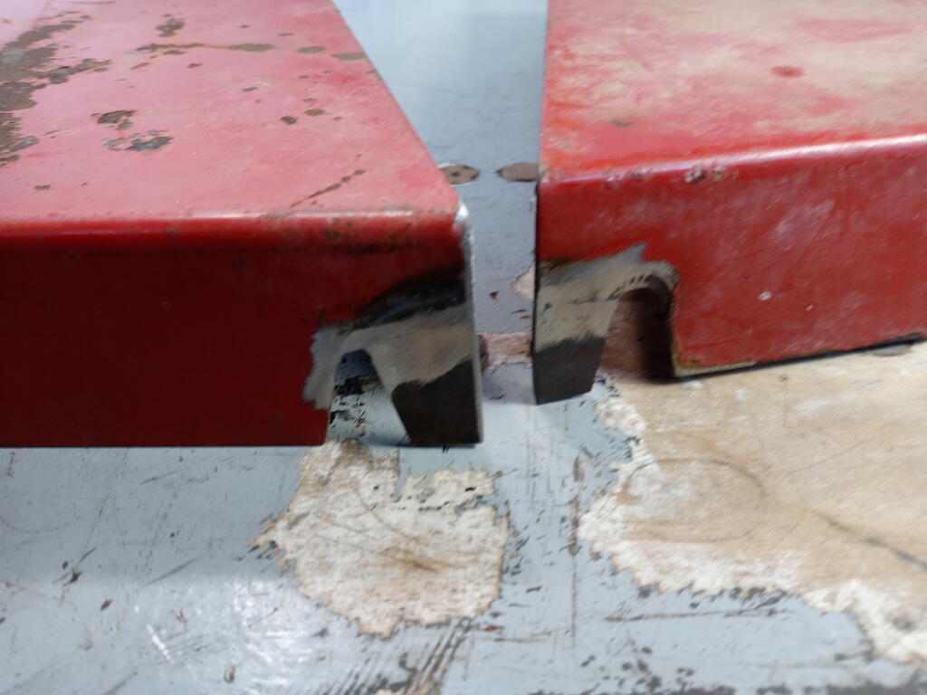

My welder also repaired the 2 belt guards for the deck...these tabs on the end of the guard were broken...one on each guard...
Second pic was a stress crack...

5 hours ago, Horse Newbie said:
another crack
I might leave that one be myself.  I don't see where it has any further to spread!
Jeff-C175
extensive stress cracks
So it seems that the wide plate they went to didn't really 'fix' the issue.  The cracks in mine, and most of the 48" decks I've seen are exactly the same as shown.
I think that the problem is that when the deck is raised it 'twists' that rear apron and ultimately cracks develop there.
I thought of a 'gusset' to prevent the twist that causes the cracks but as mentioned in the earlier post I think this would only move the crack prone area.
In this case, the blue lines show where the stress would move to.  That gusset would pull DOWN on the top surface and probably  eventually crack there.
I don't know that there is any good solution to this problem!

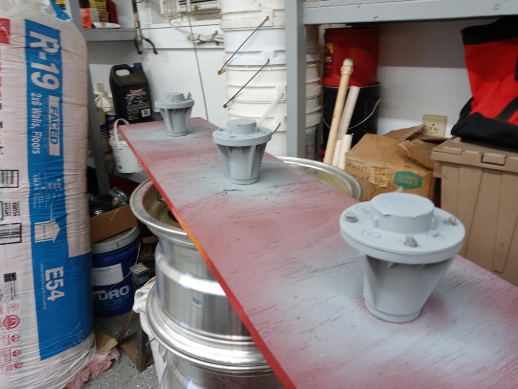

Painted the spindle housings for the 48 inch SD deck...also ordered a set of new decals from @Vinylguy for it.

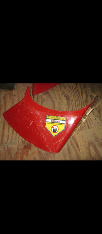

I have reached out to A to Z Tractors for a discharge chute for my 1994 48 inch SD deck.
Can anyone reading this explain how it mounts ?
Pics would help also.
Thanks...
Jeff-C175
Thanks...
Early decks like mine the chute just bolts on.  ( which I don't use in spite of TWICE shooting a rock and putting a hole in my vinyl siding, I know, I know, I should use it.  Now I just make sure to direct the shoot at my neighbors houses )
 It looks like your deck still has the holes for this, but the newer decks had a spring loaded chute assembly.
Of course, I could have just said to Read The Fine Manual !  :ychain:
Edited by Jeff-C175

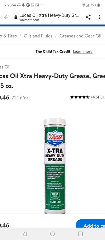

@horsenewbee  your reference to spindle issues , when i started rebuilding decks , made sure that i did not follow those into a repetitive failure , opportunity . those spindle bearings fail and get noisy ,because of generic lubrication , that size , bearing is a very common ceiling fan bearing. if you clean out a new bearing , with removable side shields , and add a certified , hi temp , polyurea , anti sling grease like lucas xtra h/d .  note inner  seal removal , for spindle bearings , they won,t fail or get noisy , lots of detail pics on deck rebuilding , correct a failure , do not reinstall the same thing , https://www.walmart.com/ip/Lucas-Oil-Xtra-Heavy-Duty-Grease-Green-14-5-oz/36052505?wmlspartner=wlpa&selectedSellerId=0&wl13=2331&adid=22222222420449455996&wmlspartner=wmtlabs&wl0=&wl1=g&wl2=c&wl3=501107745824&wl4=pla-293946777986&wl5=9003292&wl6=&wl7=&wl8=&wl9=pla&wl10=8175035&wl11=local&wl12=36052505&wl13=2331&veh=sem_LIA&gclid=CjwKCAjw_L6LBhBbEiwA4c46ust5xSBqPP44kYYrstMuArzgRQkGeVVk1UoSsB5Ap4QvQsTDV3o1_hoCQMUQAvD_BwE&gclsrc=aw.ds  . look it up , do not be afraid to correct issues , just my experience , pete

The spindle housings for the 48 inch SD deck that goes on the 1994 520H has dried...tomorrow they will go back in the box to await re-assembly of the deck.

@Horse Newbie those spindles look sweet , where did you get your bearings ? remember its the stagnate acidic grass effect that rots spindles , clean as often as possible , and finish with an aerosol lubricant soak , the oil will stop the rot effect and feed the metal . doing that on a regular basis , really don't even think about it, if possible add some sun under drying / heating up of deck , that sucks in the lubricant , pete

@Horse Newbie what really caught my eye , was the wide rubber side shields , makes a lubricant upgrade very easy , pete

I checked whether the inside side of the bearings have side shields...they do not.
So I'll be getting that grease from Walmart like you said.
