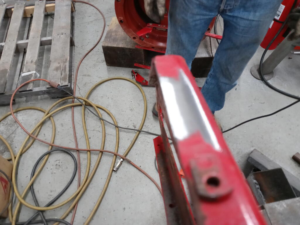

Horse Newbie

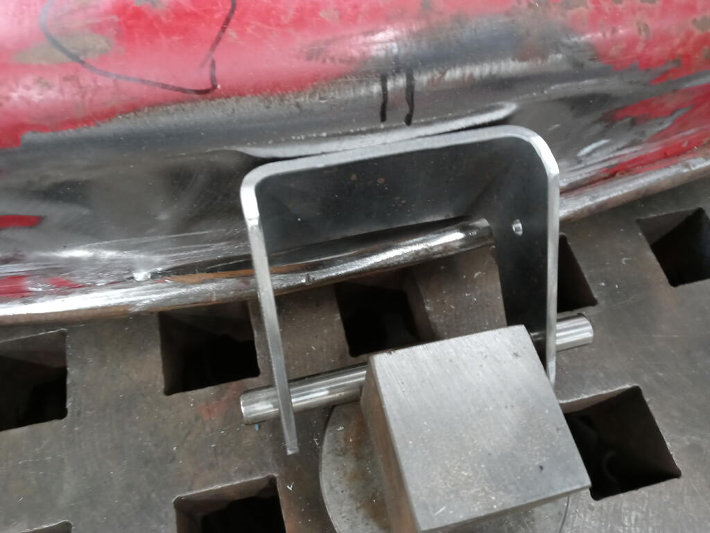

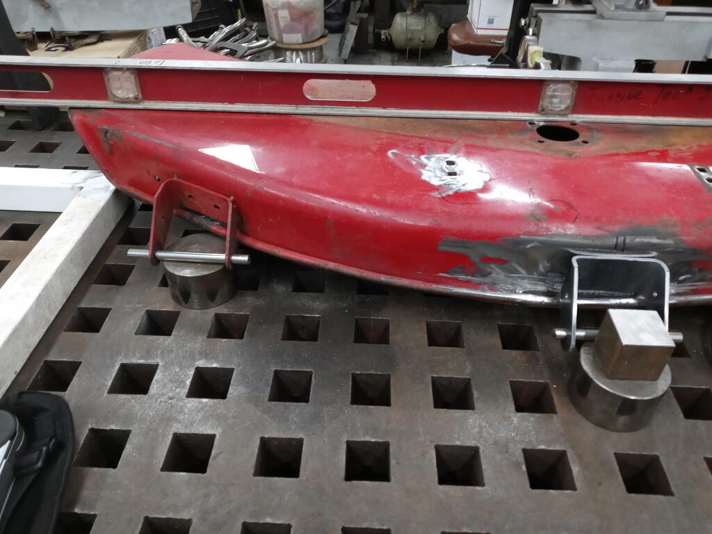

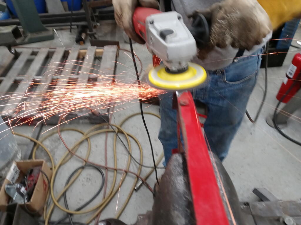

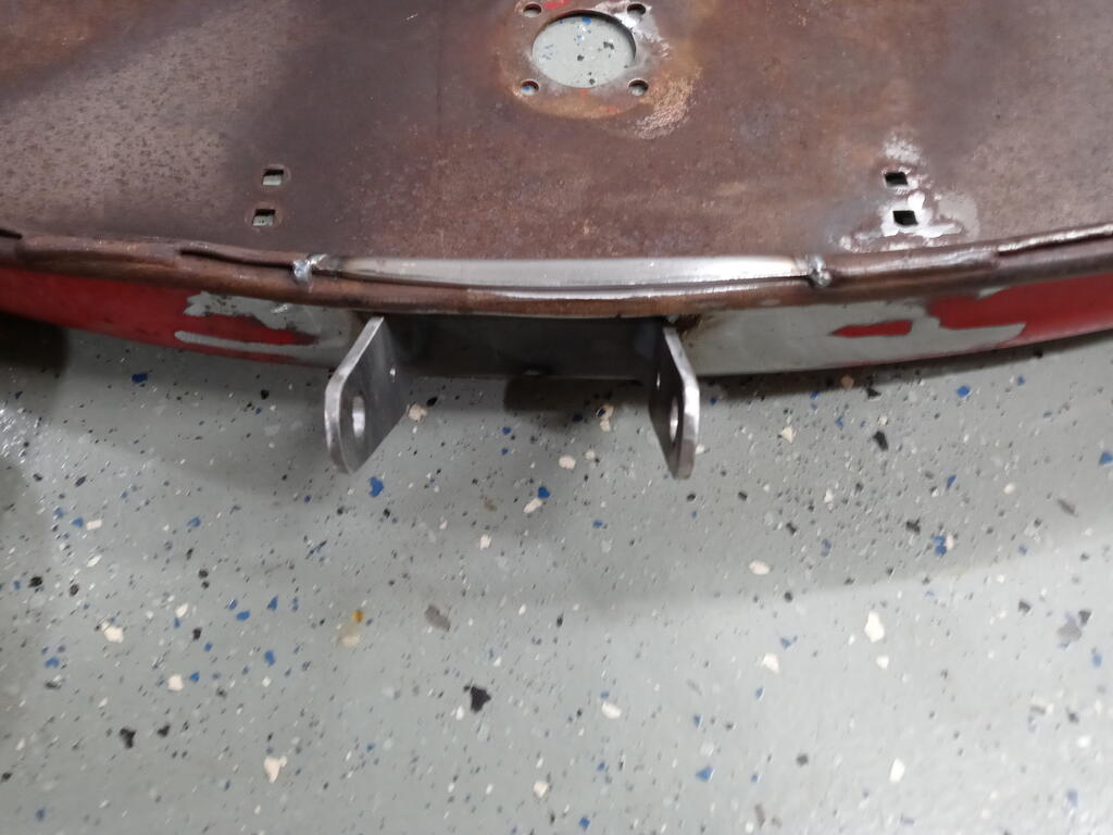

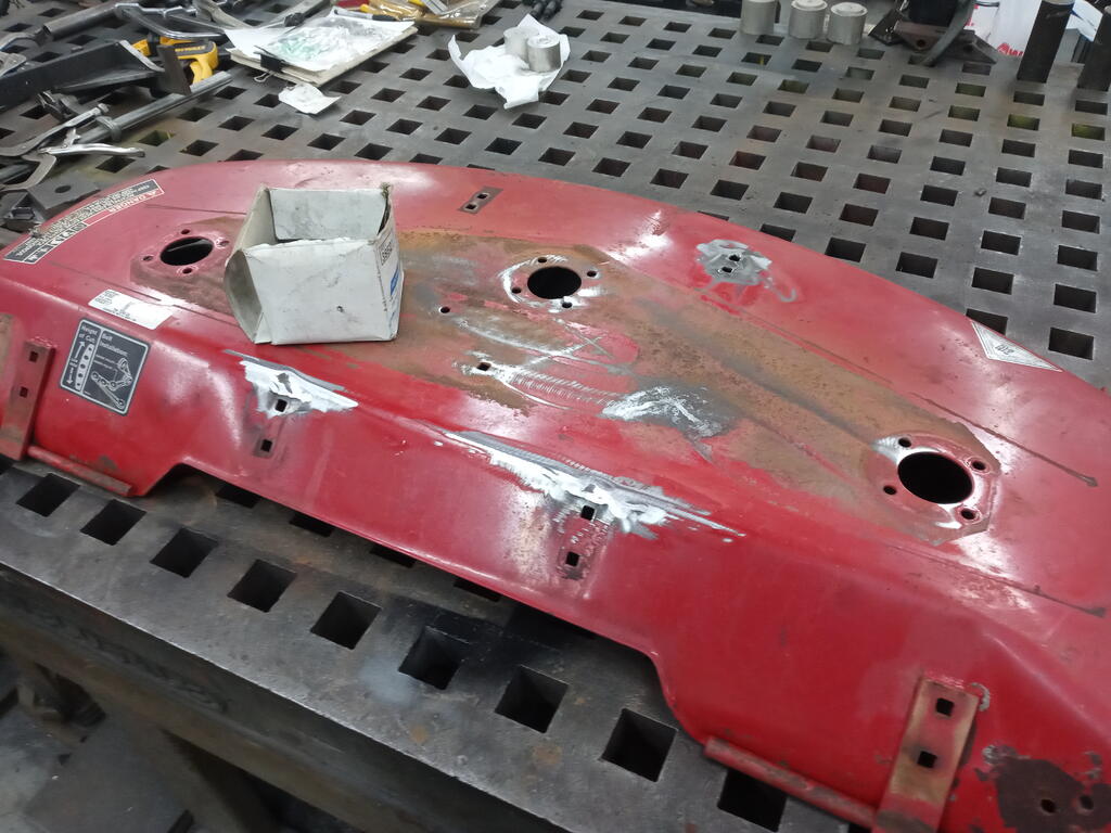

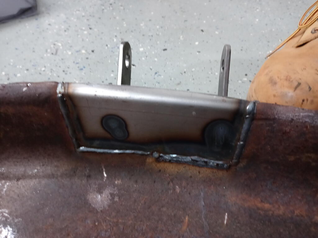

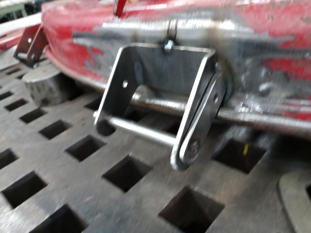

Went to the welders shop today and we finished welding and fabricating parts on the 48 inch SD deck for my 1994 520H.
He welded on the new center bracket he made for the anti- scalp wheels on the front of the deck. This was the area that required the most work. It looked like the PO had repeatedly rammed a stob in the ground...either that or the PO center punched something full speed from the damage done. It pushed the front of the deck back and the center blade did a number on the deck and bracket.
Horse Newbie

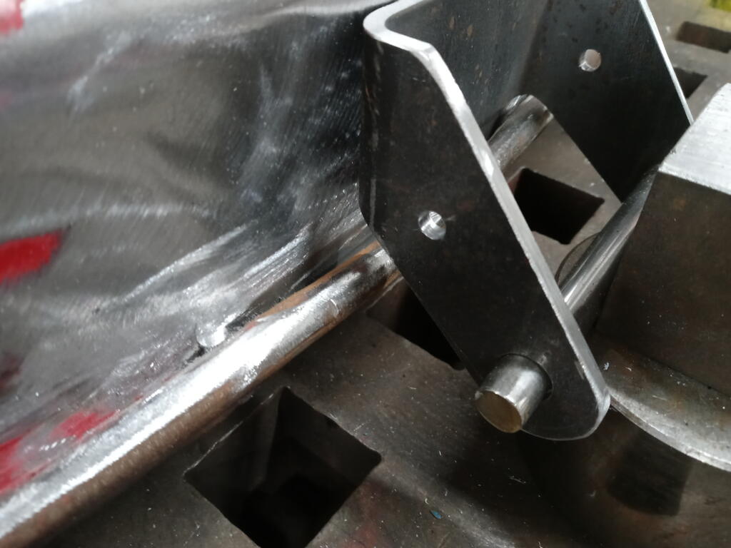

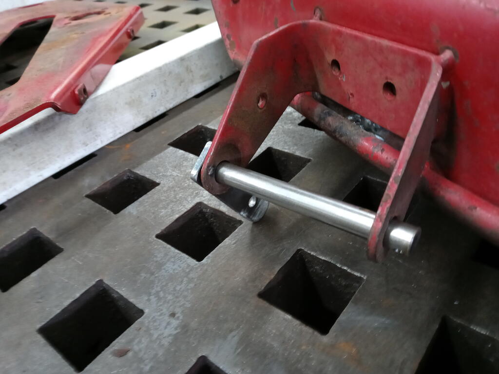

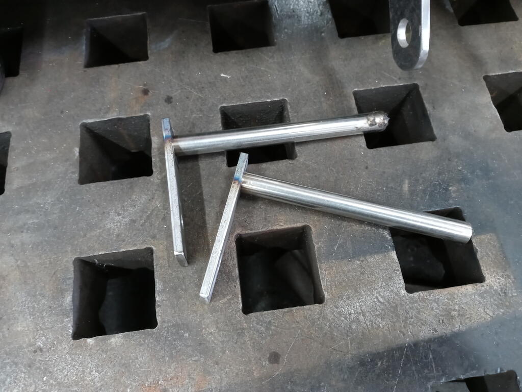

Then we made new skid wheel axles...
Horse Newbie

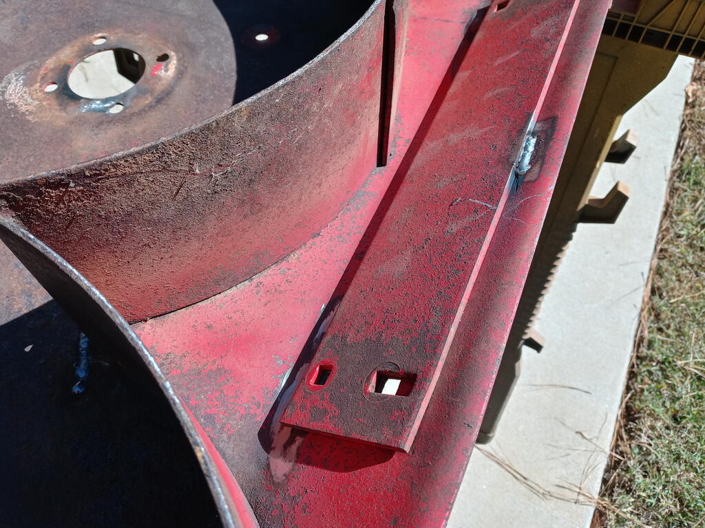

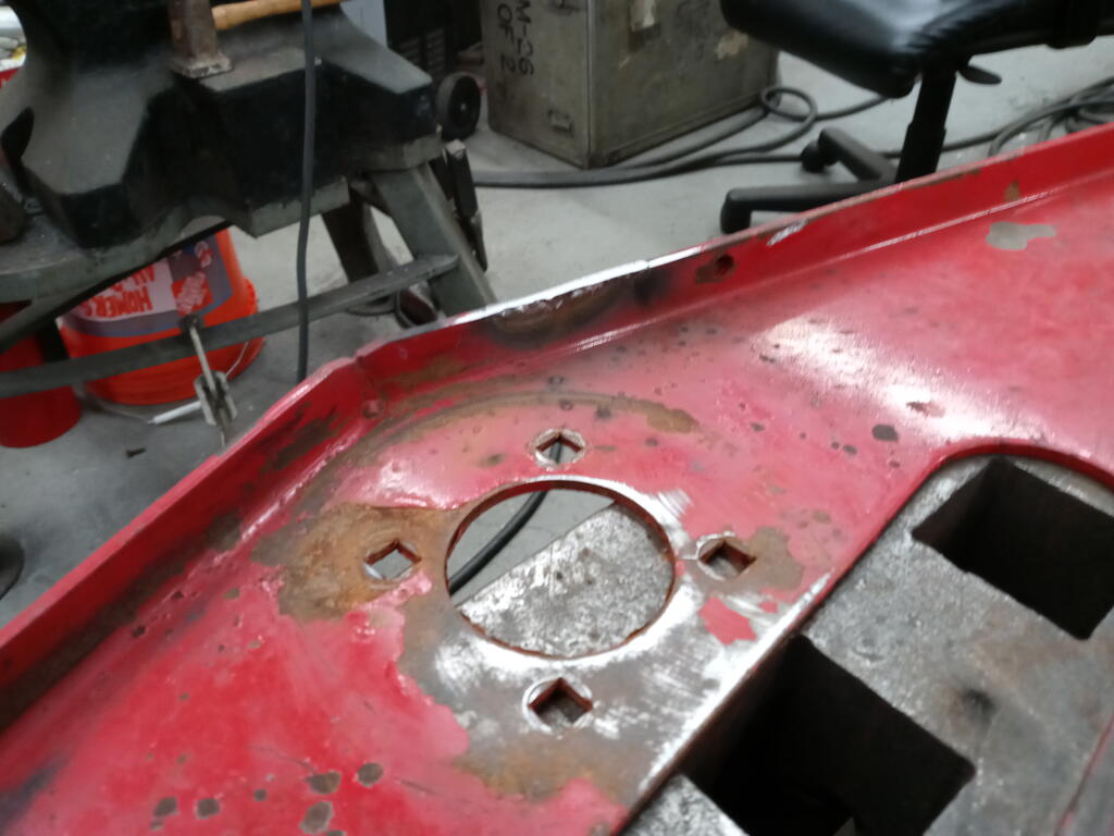

I don't know what the piece is called that the spindles come up through- holds the idler pulley/ deck belt tension bracket, and the belt guards bolt to it.
Anyway, it had a groove worn in it from a belt out of proper alignment, so he welded that up...
Horse Newbie

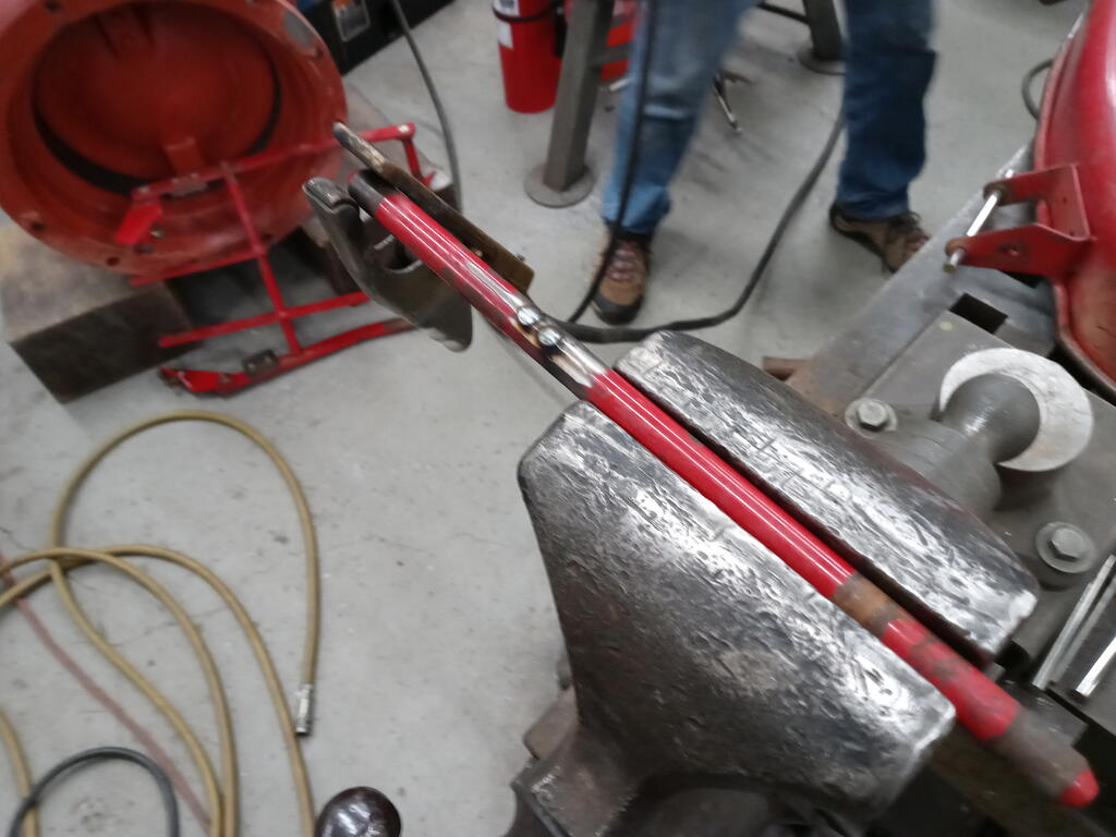

The front round cross rod in the deck hanger assembly had a groove wore in it so he welded that up too.
I brought all the deck parts back home and unloaded them to the shop...now is it get the twin Briggs running for the GT-1600, or work on this deck restoration ?...I don't like doing more than one project at a time ...
Edited by Horse Newbie

Dang ... that is nice work!  I hope you remember him well at Christmas and his Birthday!  And just for the heck of it, a couple hundred for his work now!
BTW, nearly every 48" deck I've seen has some wear at that spot.  Not sure if there's really anything to do about it!

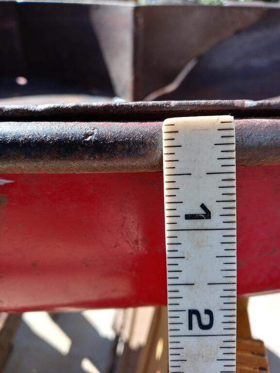

Jeff-C175
@Horse Newbie
I think I asked this a while back in another thread but I forgot the answer!
There's what looks like a 3/8" rod all the way around the perimeter that appears to be factory.
My 1980 deck does not have that (except where I added a piece when I repaired similar damage to the left front roller).
I wonder when WH started doing that?
I think I might add that to my deck next time it's off for maintenance.
Am I seeing it right? Is it in fact 3/8" ?

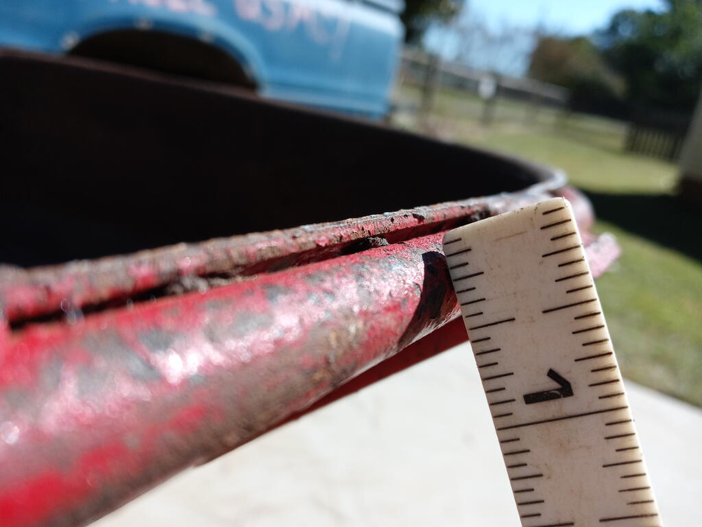

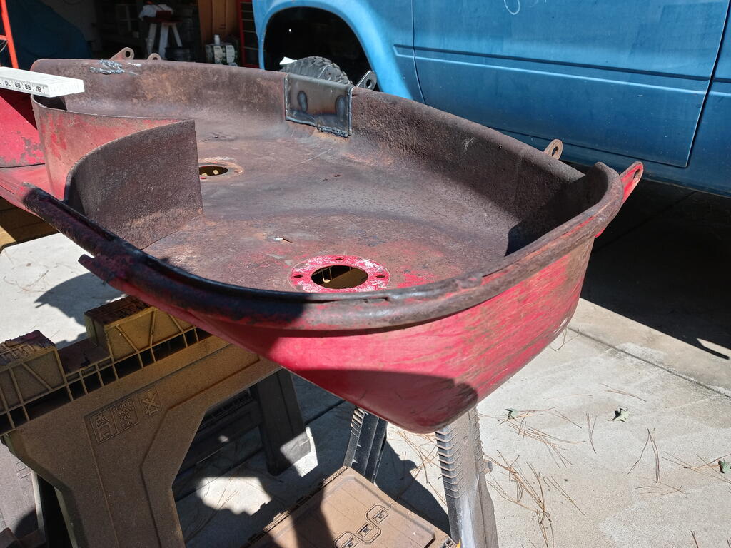

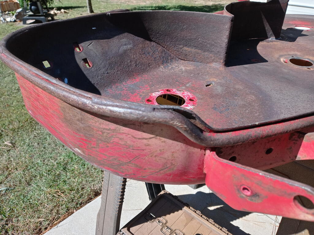

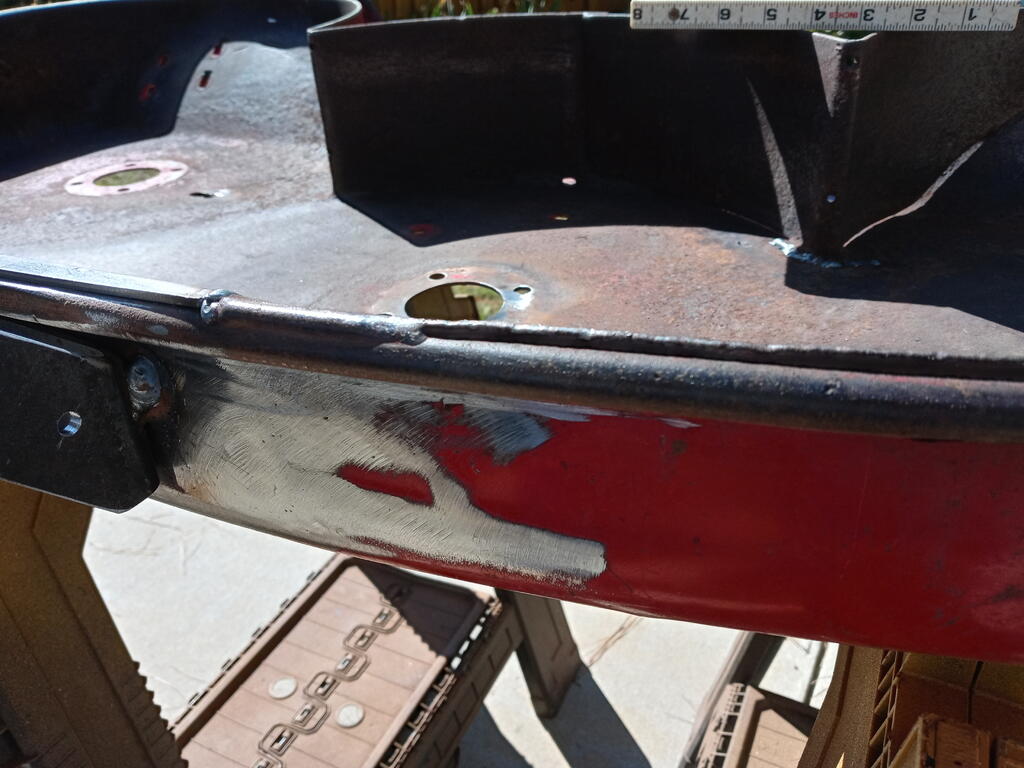

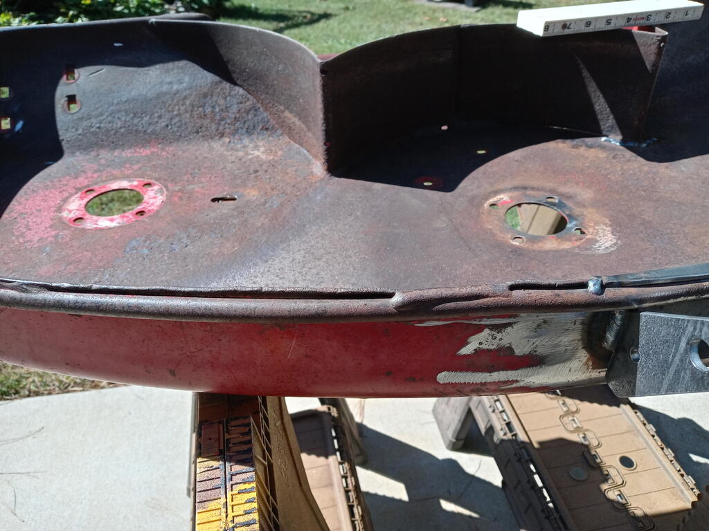

Horse Newbie

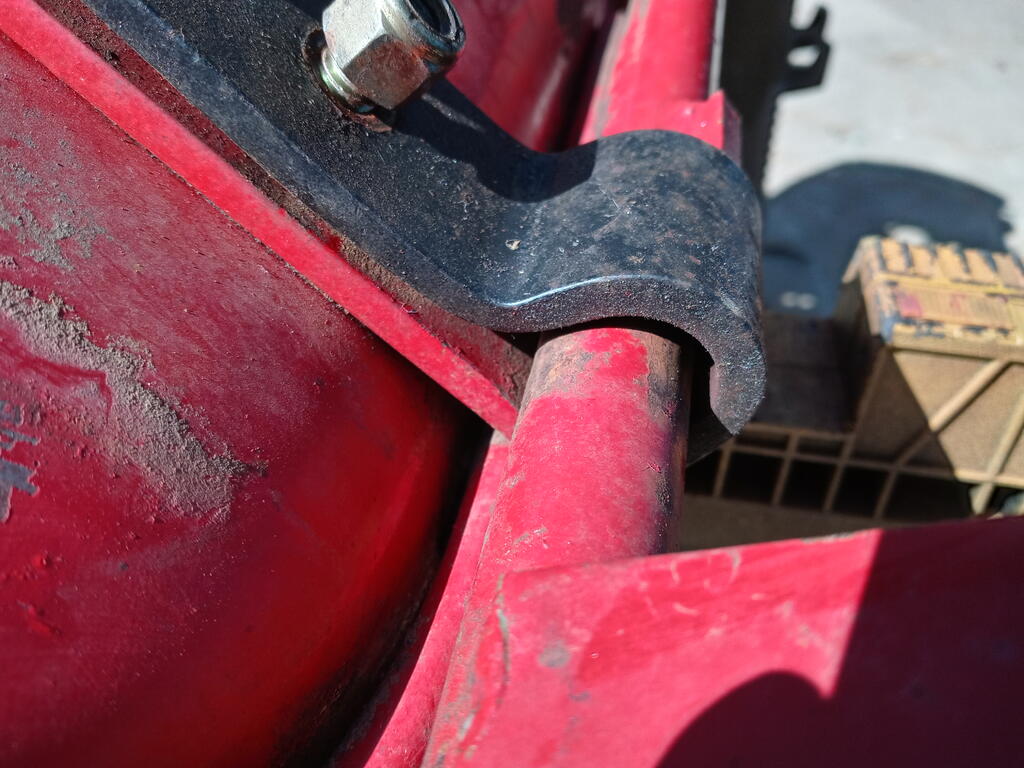

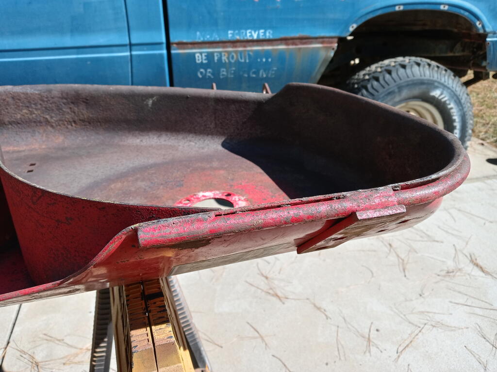

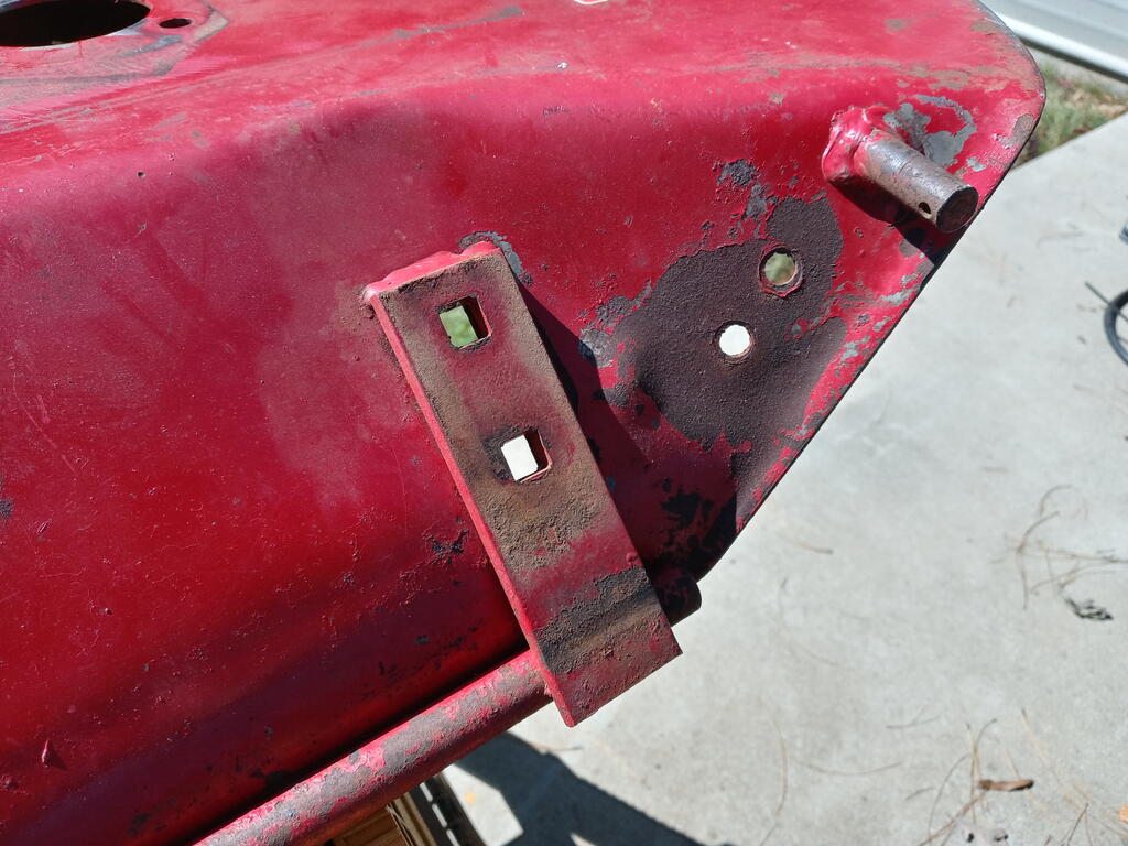

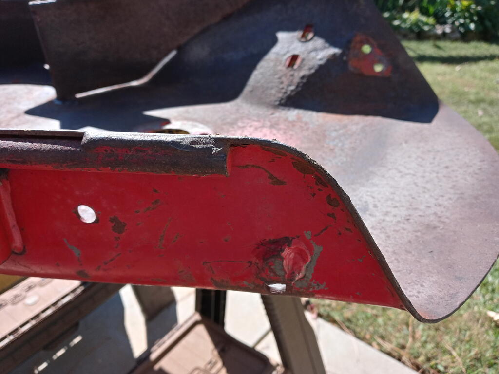

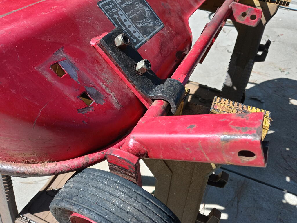

@Jeff-C175  I took a look at the cold roll going around the bottom edge of the deck. It looks like 1/2 inch diameter to me. Here are some pics to help you see what areas it covers.
You can see in the 3rd and 4th pic that it goes between the deck shell and the mounting brackets for the height adjustment axle...not sure if your brackets are tight against the shell of your deck or not.
That would be one area of concern and also bending some of the tight radiuses around certain areas of the deck.
Jeff-C175
Thanks so much for taking the time to get those pics!
Or maybe 7/16" even?  No matter, what's a sixteenth between friends?  ;)
This part could be a bit challenging:
I do have access to a 20 ton press though so I'm sure I can deal with that.
This detail I hadn't noticed before:
I wonder if the brackets are modified to account for the thickness of that extra material?
OR... is that the actual bracket?  Just made longer to reach down to the extra bar?  That makes huge sense... instead of the forces being applied directly to the deck shell,  they are transferred all the way around with that setup.
Did they do anything to strengthen the lift carriage mounts on the rear apron?  I repaired the cracks that always appear at that point, but want to improve that part also.
Edited by Jeff-C175

I did mine myself. I chose 1/2" .... well, mostly cause I had some! If you have a gas rig and stick/mig welders its not difficult.
At my starting point I made a couple tack welds and then with a cutting torch (or better yet a 'rose bud', I didnt have one!) apply red heat to the next few inches and bend the bar to fit, and tack weld that, moving around the deck in this manner. When I had it all tacked I went back and put a continuous bead down.

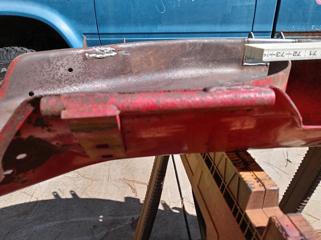

Horse Newbie

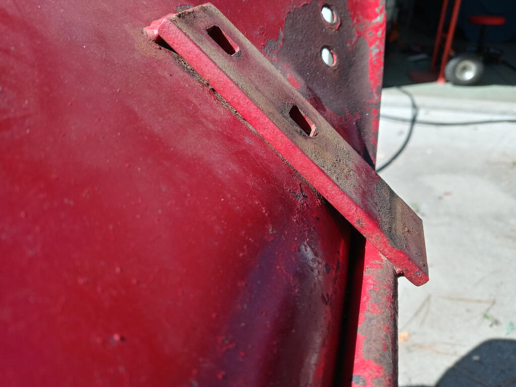

I don't know if it is a modification or not as I have seen no decks up close beside mine...
The only strengthening I have noticed for the carriage assembly is a flat piece of 3/16th , 14-1/4 x 3 inches (pic 1).
The axle is held in place by 1/4 inch thick flat bar with a curved area bent around the height adjustment axle. I would think all WH decks of this design would be  with this. (pic 2)
Jeff-C175
On earlier decks that part is 'separate'.  Not welded to the deck.
Yep.  That's different too.  Earlier decks had a square piece of 1/4" about the size shown in green.  Cracks typically go away from the upper corners as shown in yeller.
Do those grind marks indicate that yours may have had cracks in the same place?
I think what you have is a definite improvement, but doesn't really address the flex that causes those cracks apparently.
It might be better to have a bent piece of steel "up around the bend"
Although, that might just move the area that cracks!

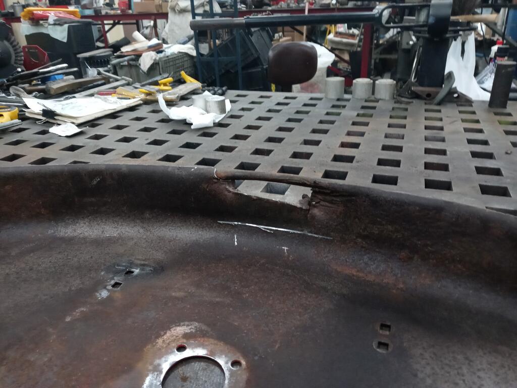

Horse Newbie

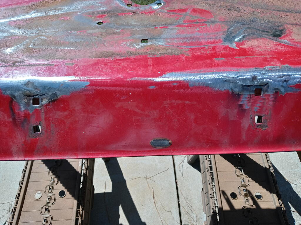

Yes, I had rather extensive stress cracks at the 4 holes where the carriage brackets mount, front and rear of deck.
