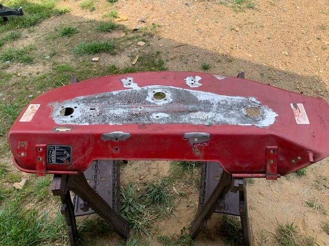

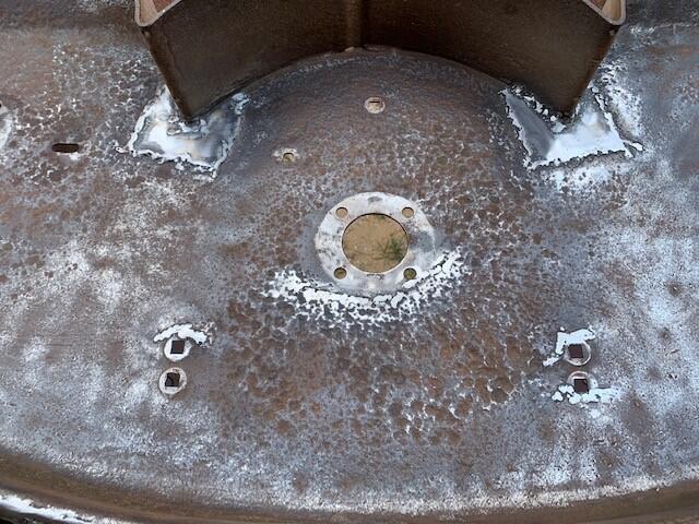

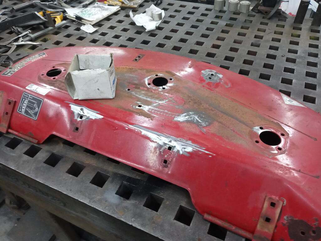

I get to move on this thing with 40 hours of vacation starting. Finished the welding. Yeah, I suck, but it's my first time and I still can't see what I'm doing. Great little HF welder but their cheap helmet is too dark on its weakest setting. I think I might do pretty well if I didn't have to stop every 5 seconds to see where I am. Recommended setting is C - 4 but I get best results with C.5 - 3. Lots of trial and error and through the use of a chunk of 16 ga for practice but practiced on the deck, too.
So welded up. Big box full of flapper disks so can make it look nice. Now need to get to HF for more stripper disks to remove the paint, plastic to smooth the top and then prime. Bearings and pulleys on the shelf ready. I'm in the market for the belt covers if anyone has any laying around...

Well, the flap disks make it look tolerable.
Thanks! I have heard it's also good to have the eyes shut at the trigger in case the helmet doesn't react quickly enough and your eyes over adjust to the short flash. I could almost see the crack I was welding. Well, plenty more time to practice.

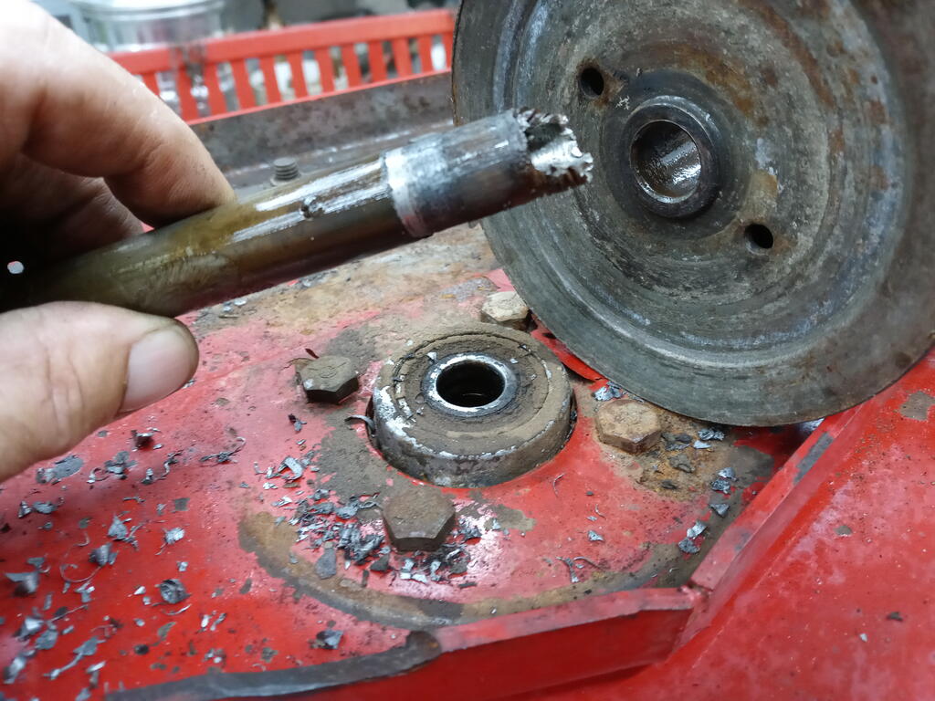

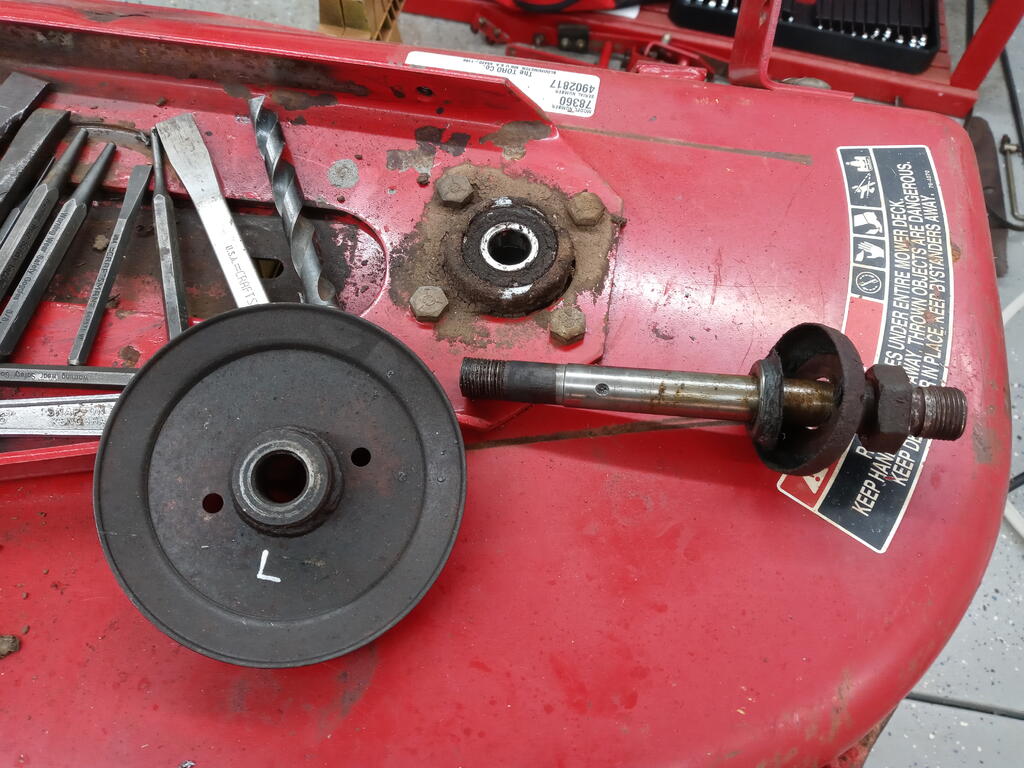

Managed to get the spindle shafts out of the spindles today...also took the spindle housings off the deck.
Had a bit of a challenge with the center(double pulley)...ended up drilling down through the center of the spindle shaft and taking chisels and punches and collapsing it in on itself.

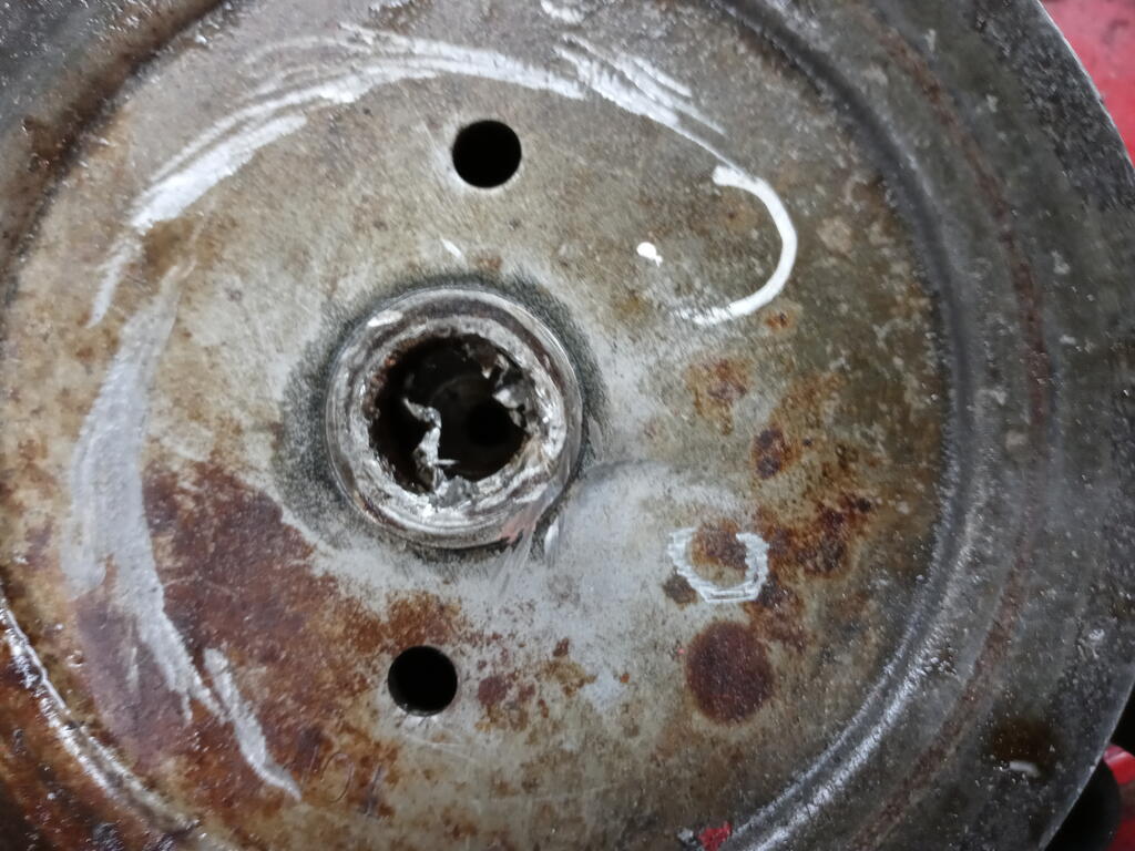

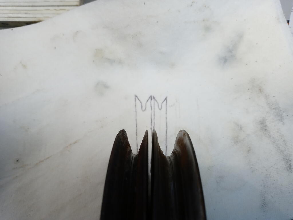

Take a look at these pics and tell me what you think...On the center(double) pulley, the "v" groove where the PTO belt rides seems to have some weird wear in the groove...actually the "v" where the deck belt has the same problem...advice anyone ?...new center pulley ?
I drew a profile of the shape of the grooves on a white napkin...see pic...

Too bad you have the unkeyed pulleys, I happen to have a 3/4" keyed center pulley that's excess to my needs. (and brand new)
You could probably 'get by' with the one you have but might experience accelerated belt wear.
Edited by Jeff-C175
Lee1977
If you haven't ordered roller spindles yet they are easy to make. Some 1/8" x 3/4" flat and 1/2" bar is all you need.
lynnmor
Those pulleys deserve a complete retirement.

@lynnmor...are you saying that because of the wear in the "v"s, or the shape of the holes that the spindle shafts go through ?
lynnmor
I really didn't look at the holes, the shape and pitting of the V's will wear a belt fast.  I wouldn't consider running them.

Yeah...the holes in the pulleys aren't bad.
That one pic of the center pulley...it actually has some of the spindle shaft that I drilled out remaining, making it look a lot worse than it is.

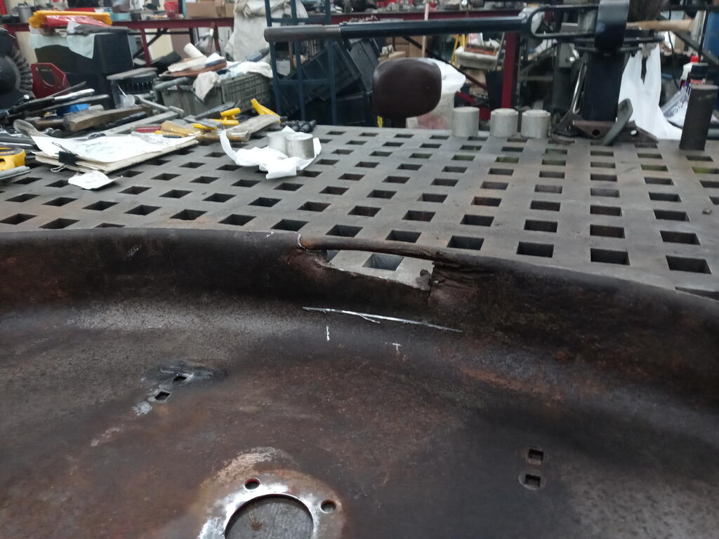

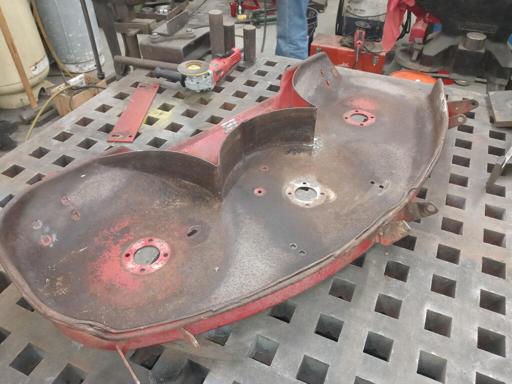

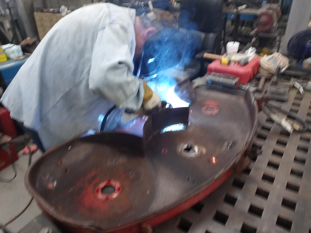

So today I took my 48 inch SD deck to the machine/ welding/ blacksmith shop and got started on repairing it where the PO had centered the middle front anti- scalp wheel on a stob, then apparently took a lap and come back and centered the stob again by the way the deck looked...
Got the front of the deck jacked back out using a hydraulic ram jack and a table that accepts round steel pegs to hold it in place.
My friend who was doing  the welding said no need to do the "drill a hole at the ends of the stress cracks" since he was doing full penetration welds on the deck. He has welded on steam turbine fins at nuclear plants so I figure he knows what he's talking about.
After jacking the front back to "as good as we could get it", and welding the stress cracks we went about tackling the gaping hole in the deck right behind the center anti-scalp wheel bracket.
The center blade made contact with the front of the deck when it was pushed back by the stob, and I guess the PO just kept on mowing( damn the torpedoes,full steam ahead ! :lol:) because the area of the deck behind the center anti- scalp wheel bracket was missing. (Will have to put a patch there)
Here's a pic or two...20210626_133136.jpg.7c2a2e260b0c12f1ab2a6d787c5b58a8.jpg
