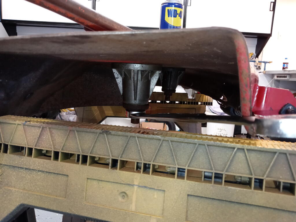

Update on the desk resto...took the blades off...16 " long, luckily not much trouble loosening the blade nuts on the bottom of spindle shafts with an impact wrench  (Was afraid I was gonna need the heat wrench).
Arbor hole on the blade looks like 3/4" according to a carpenter's stick ruler, but take a look at this video; the blade holes seem to have a lot of wiggle room around the spindle shaft.
Is this normal ?
Edited by Horse Newbie
Jeff-C175
17 minutes ago, Horse Newbie said:
Is this normal ?
No, that doesn't look normal to me at all.
Can you get a close up still shot from the side of the shaft?
It looks to me as if the blades were loose, or had been in the past, and the shaft is worn down in that area.
There's no way you can get the blade centered, you'll probably have tremendous vibration issues due to out of balance condition.

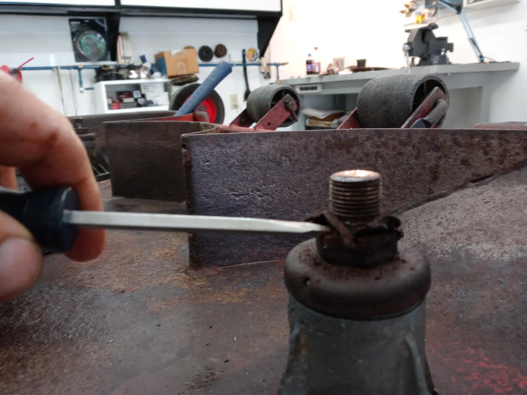

Horse Newbie
@Jeff-C175 The left spindle shaft seems to be the worst, but all three had more wiggle room that what I've ever seen on any brand of deck.
I tried to get a close up.
I have, or will tomorrow, order 3 new spindle assemblies ( that's gonna hurt ) from a fellow member on here, so not much worried about the slop at this point.
I have quite a few stress cracks to address.

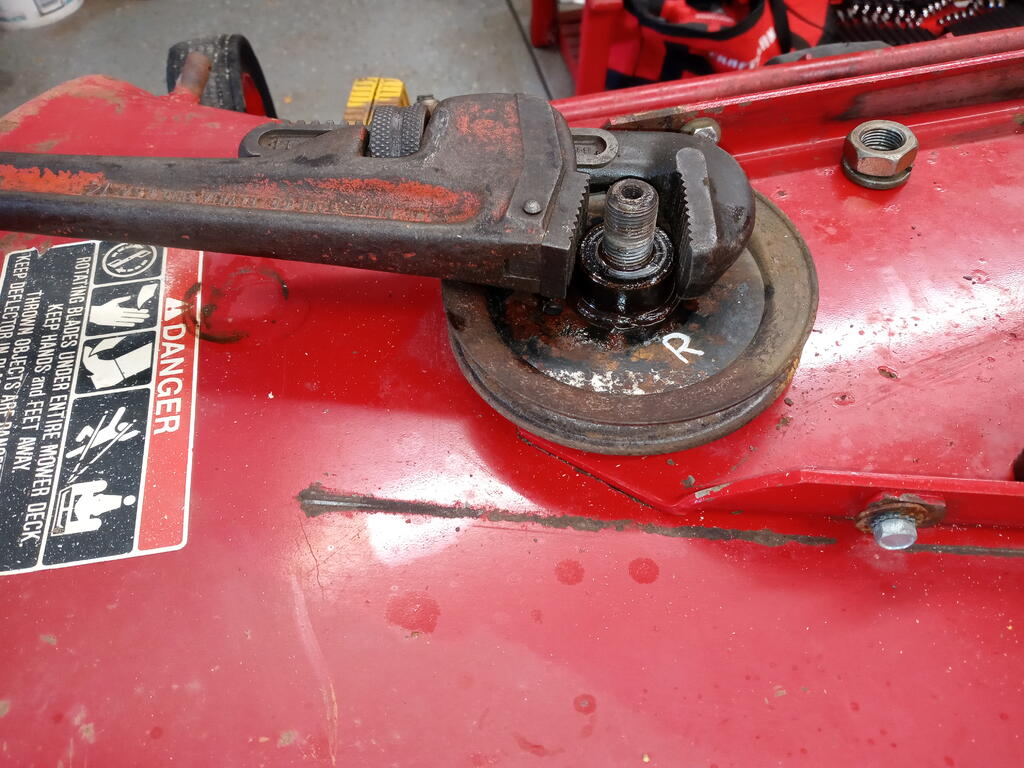

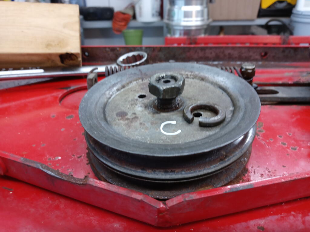

Okay...need some advice on how to remove this center pulley/ pulleys without tearing them up. I have whopped the top of the spindle shaft with a nylon head hammer ( with nut screwed on a bit )...I have wacked it with a 2 lb hammer with a 2x4 on top to maybe keep from wrecking the top of the shaft...I would really like to not damage the pulleys...as you can see the lock washer is done.

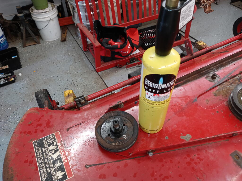

Horse Newbie
Thought about to try and loosen the pulleys on the spindle shafts by putting a 1-1/8 th wrench on the big hex at the bottom, gripping the pulleys shoulder(right & left, center has no shoulder) with a pipe wrench and maybe turning a bit. But before I do I want to make shure that the pulley holes are not splined...anybody know ?
Horse Newbie
What do you guys think about taking a punch/ center punch and putting it in the grease zerk hole and knocking the maholies out of it ?
I tried heat from a mapp gas torch...did not budge
Jeff-C175
4 hours ago, Horse Newbie said:
more wiggle room
Those threads should extend all the way down to the big nut.  Definitely some loose blades caused that issue.
Were BOTH washers still in place?  Thin one on top of the blade, thicker one on the bottom?
Blade nut torque is something like 80 - 100 ft lbs.   Pulley is 60 - 80 .
They are not, but I don't know if that's going to work or not.  I don't like the idea because you could end up 'egging' the pulley collar.  Pipe wrenches put a tremendous amount of 'squeeze' on the thing being removed.
WD-40 ain't the best thing to use though.  I've never had any luck with it.  I have had good luck with PB Blaster (some of the others on here don't like it though... but it works for me)
Get some PB, put it on there around the shaft. After a couple more hours, put some more.  After a couple more hours, put some more.  Let it soak in and do it's magic.  Be patient, if it takes days, it takes days.
Above all, do NOT attempt to use any sort of 3 jaw puller, you WILL destroy the pulley!
If you do that and spread the top of the shaft you'll have to grind it down to get the pulley off once it busts loose.  You might end up having to grind it anyway even if you just whomp it with a BFH.
Apply the heat to the pulley hub, not the shaft.  You want to 'grow' the hub more than the shaft.  If you have some of that "Freeze Spray" in a can, when you get the pulley hub hot, hit the spindle shaft with the freeze spray.

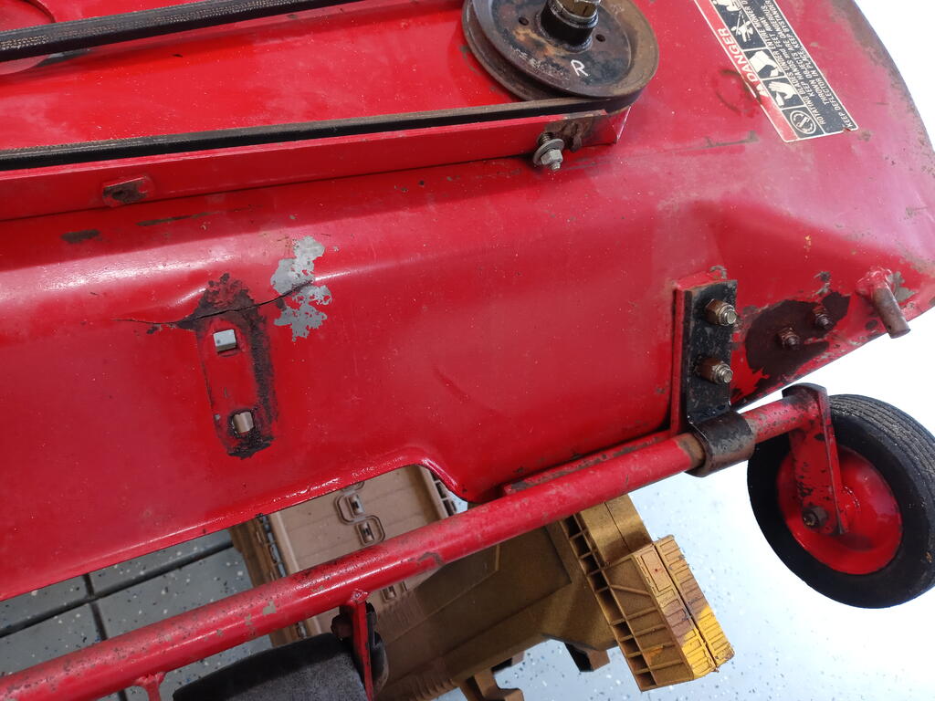

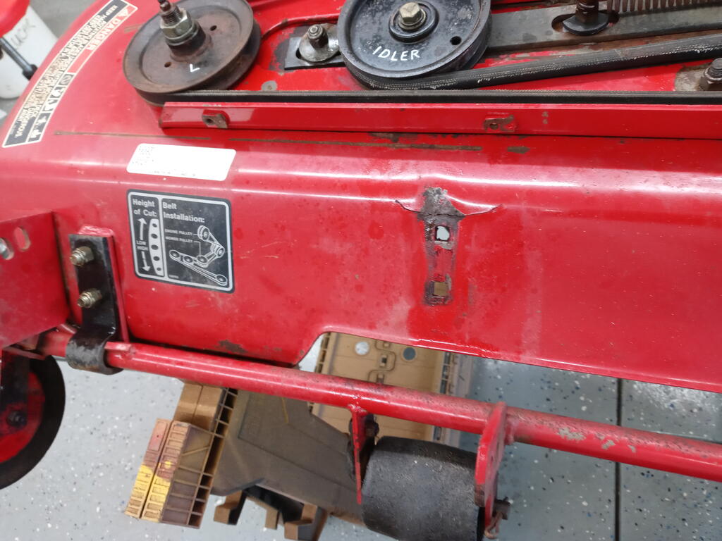

Jeff-C175

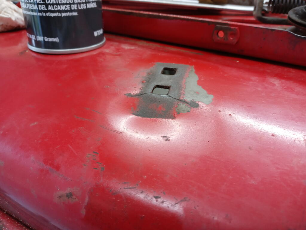

When you drill the holes at the ends of the crack, remember that the end of the crack becomes microscopic so go a little past where you think it ends.
Those cracks are all typical, but this dent?  I can't imagine how that happened!
You don't want to bang that one out without an 'anvil' of some sort on the other side or you'll end up driving those cracks half way across the deck.

In addition to adding reinforcement plates, get a pneumatic needle de-scaler and peen the dickens out of any repair welds that you do.  This will set up compressive residual stresses in the repair, making it more resistant to fatigue cracks in the future.
Horse Newbie

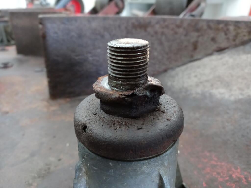

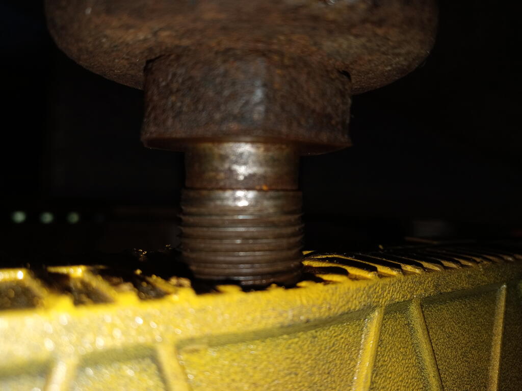

@Jeff-C175 , and @8ntruck, thank you guys a gazillion for your advice ! Let me cover where I left it tonight when I turned out the lights in Horse Newbie's Custom Hot Rod and Lawn Mower Shop...:lol:

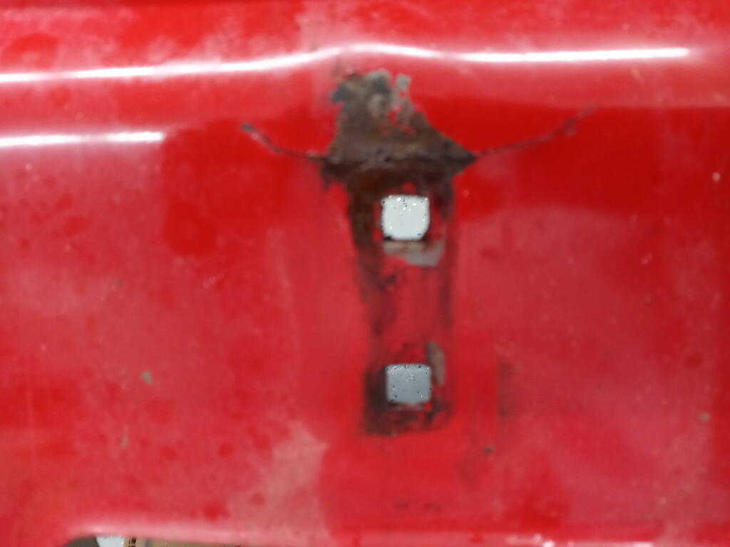

Both washers were in place in only the right side spindle. The center and left spindle only had the thick washer at the blades. When I found the thin washer on the right spindle I did not recognize it as a washer. It looked more like a spindle cup, wrapped around the big hex at the bottom of the spindle shaft.
See pics 1 and 2
Pic 3 is what was left of the thin washer after I got it off and laid it on the workbench.
I DID NOT use the pipe wrench to try to turn the right and left pulleys...don't know if it would have "egged" it or not, but I know what you are saying Jeff...I've egged pipe before...
I've put PB Blaster and WD-40 on it...I plan to keep the pulleys/ shafts soaking while I take my time removing the pulleys.
I DID NOT go near the pulleys with a 3 jaw puller...I've already read and saw on Red Square the all-too-often results of that. I am not trying to buy pulleys too. I'll keep trying patience, PB Blaster, WD-40, and heat...by the way when I put heat on it from the MAPP torch, I did heat up the pulley shoulder/hub trying to expand it away from the shaft.
I'll have to get the freeze spray...thought of heat but did not think of the added element of contrasting cold...good idea !
As far as that dimple you circled...I may weld the stress crack then try to fix the dent.
I have not had a chance to try any of the freeze spray ( have to get some ), but if anybody has any other method of pulley removal on a deck restoration that I could try, please let me know
