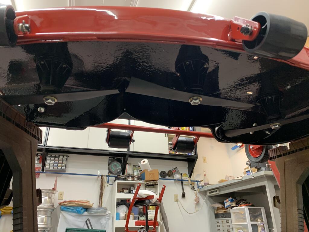

Yeah, and I noticed the thick washer is on the shaft first… I’m still gonna go thin, blade, thick, nut.

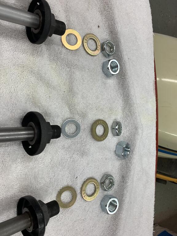

What I did after work was go back to the local hardware to see my “nut and bolt guy”.
He wasn’t there … left at 4pm…:ranting:
So I got to looking around and found some regular hex nuts in 3/4-16 NF, same threads as the Nylock nuts that Brian sent with the spindle kits.
I have the nuts and washers laid out in the order they will go on the spindle, minus the blade, for illustrative purposes.
The regular hex nut is laid beside the Nylock nut.
Since my nut and bolt guy was not there, I could not confirm the grade of the regular hex nut, although I’m thinking it is going to be a grade 5 nut- I will verify that before I use them, if I wind up using them.
So here is the next thing to ponder without overthinking this thing.  :lol:
The Nylock nuts DO HAVE a locking ability, which I like, and agree with Brian when he says he has seen too many ruined shafts when the regular hex nuts don’t stay tight, but…
The regular hex nuts put way more threads on the shaft than the Nylocks nuts do, and by just glancing at it without throwing on the blade, it looks like the regular hex nut will hang out past the end of the shaft by maybe 1/8th of an inch, and protect the threads on the bottom end of the spindle shaft, still putting way more threads on the shaft…
And I will just go ahead and use the silver “thin” washer on the middle shaft, and the two gold colored washers on the right and left shafts. Even though the silver washer is thicker, I don’t think the gophers will notice the middle blade cutting 1/16ths inch lower.
Now I don’t know which nut to use, the Nylocks or regular hex nuts… I’m thinking the Nylocks because using a regular nut would mean no lock washer.

76c12091520h
The "regular" hex nut that Wheel Horse uses is about half the thickness of the nut you have pictured - think jamb nut
Handy Don
I've learned that nearly 100% of the force on a nut is transferred via the first six threads. Over 90% in the first five, I believe. Extra threads are not there for force transfer but may be useful to give a larger wrenching surface or to hide threads, as you mentioned.

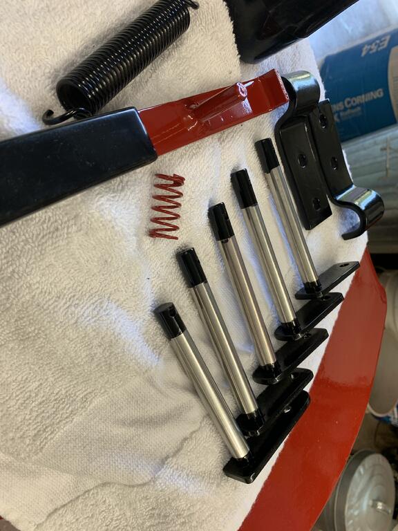

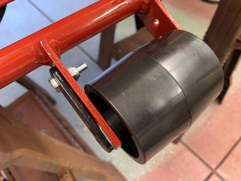

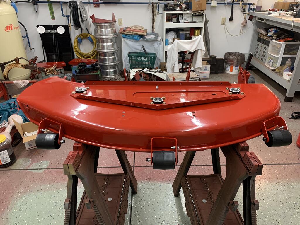

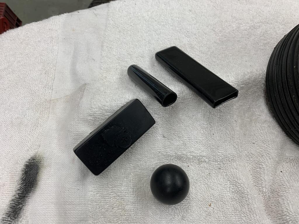

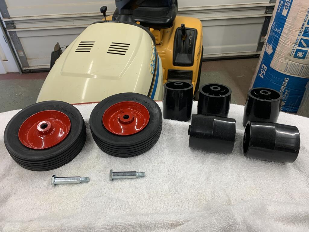

Got a shipment in from Lowell ( @wheelhorseman ) at Wheel Horse Parts and More…
a new set of anti-scalp deck wheels, deck height/ gauge wheels, a rubber grip for the height adjustment lever, a rubber grip for the mid mount attach-a-mastic lever on the 1994 520H ( which this restored deck is going on), a Hi-Lo shifter knob for the 1984 Work Horse GT-1600, and a fuse block dust cover for the 1994 520H… got to get her dressed for the show !
Well now that I’m done showing off the goodies I got from Lowell, I guess I’ll bolt a few more parts on the deck.

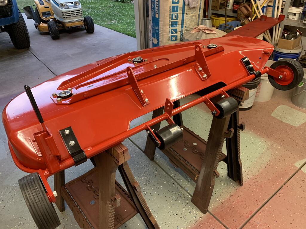

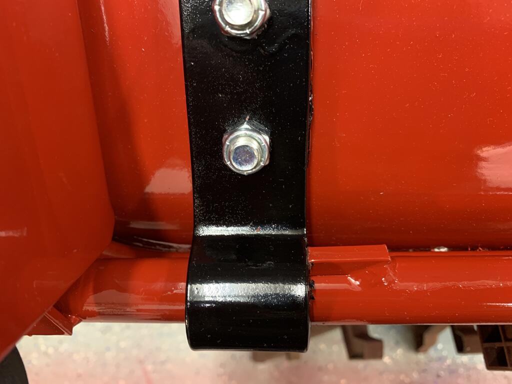

Horse Newbie

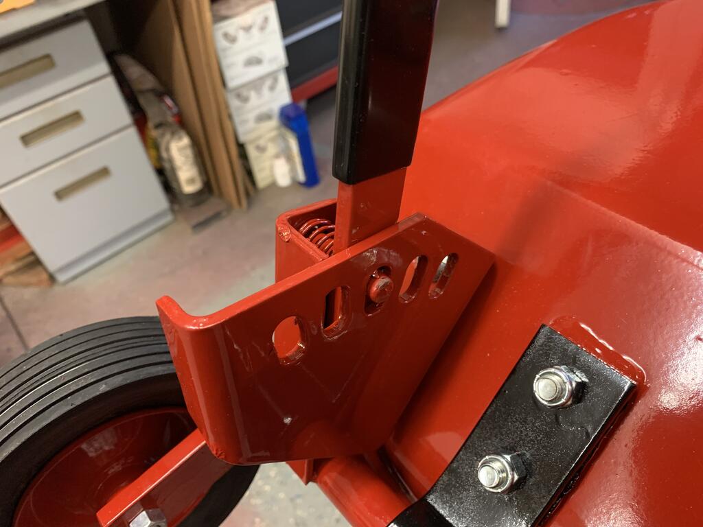

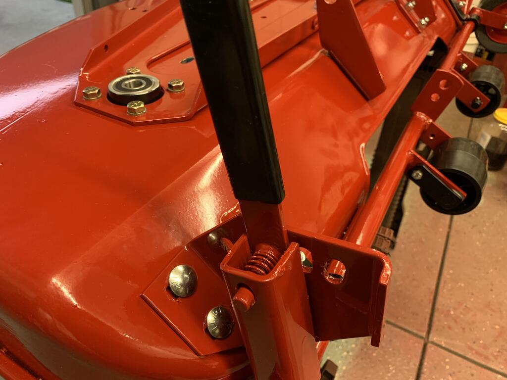

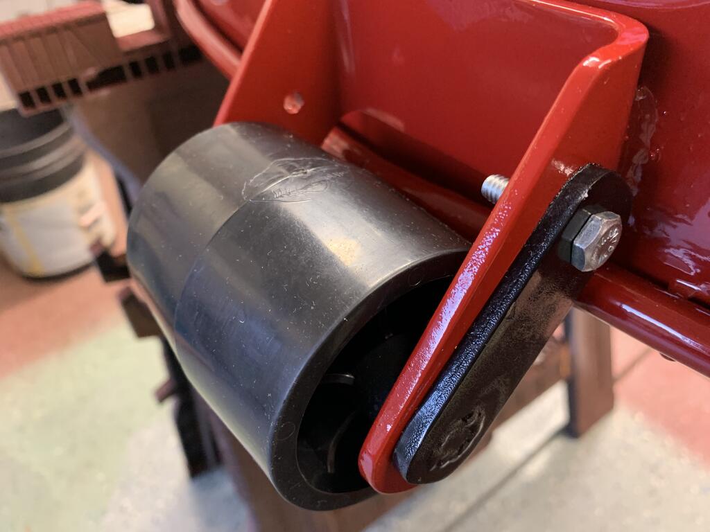

Tonight I installed some more parts on the deck…
Got a question… I know to tighten the blade nut to 80-100 ft/lbs, but what is the torque value on the deck pulley nuts ?

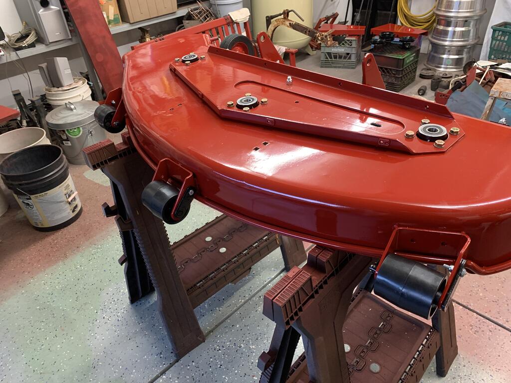

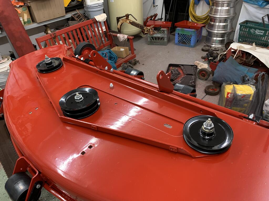

I got the spindle shafts,  blades, and pulleys on, except for the idler pulley (painted that)… Went to Walmart and had to settle for @peter lena ‘s red and tacky grease… they were out of the green.
Could not grease ‘‘em up because the grease gun would not prime. Hung it up so maybe gravity will help the grease gun spring…
