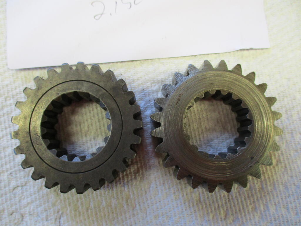

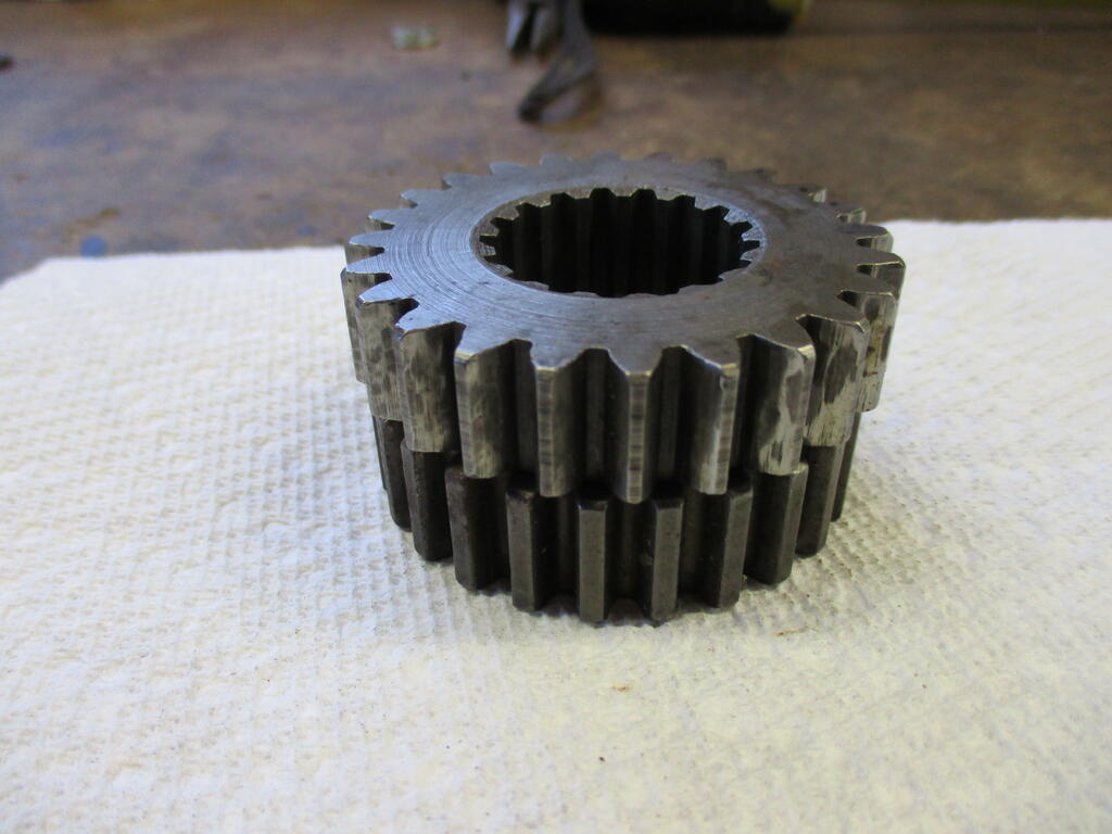

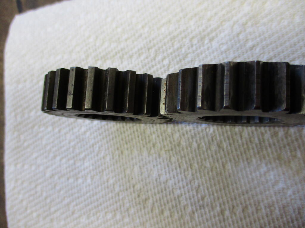

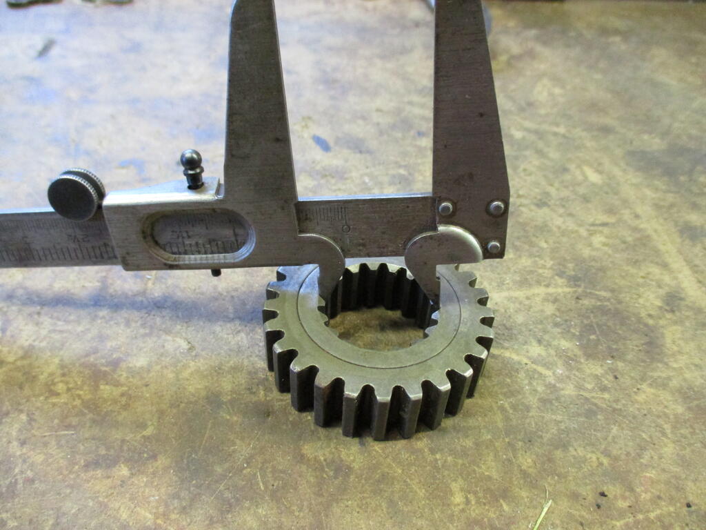

It would be easier to change out the whole unit if could find it.  Quite a few hydros and 10 pinion LS.
The square tooth is 10 pinion  the pointy teeth 8 pinion.   25 teeth (10 pinion)  vs 24  In addition to tooth shape outer diameter is slightly different 2.244 10  2.156   8
  • Thanks 1
stevasaurus
I saw they were different part numbers...  I agree, it will not work with parts we have.  :eusa-think:
