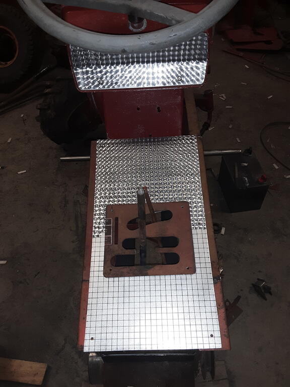

We see a lot of stainless steel  panels with engine turning on fast food trailers. Somehow it makes the plane surfaces seem much more engineered than if they were left shiny.
Oldskool
It definitely adds a bit of bling. I think to the average eye it just looks stronger/ textured? I've always liked the looks of it. Until I looked at a video of how to do it I always thought it was much more involved. Not saying it isnt to a point but it can be pulled off by just about anybody.
Mickwhitt
Yes its absolutely do able for anyone with a drill and some patience.
I agree it does look stronger somehow.

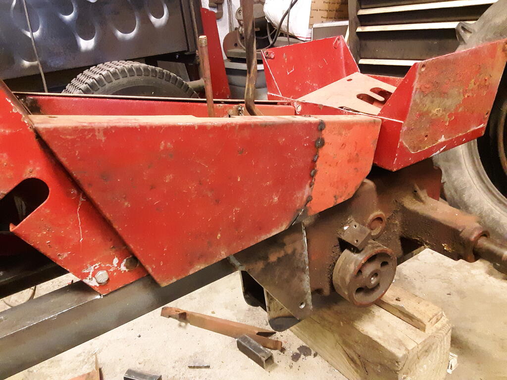

I have managed to get a start on the belt guard. I think the next thing is the console cover.

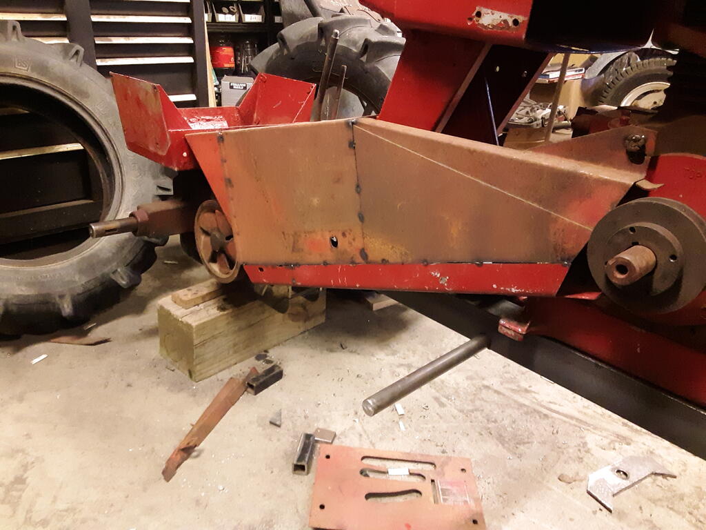

Things are closing in a bit. The other side cover is lengthened.
  • Excellent 3
I like what you doing with all that
Thanks. I think its going to serve its purpose quite well.
