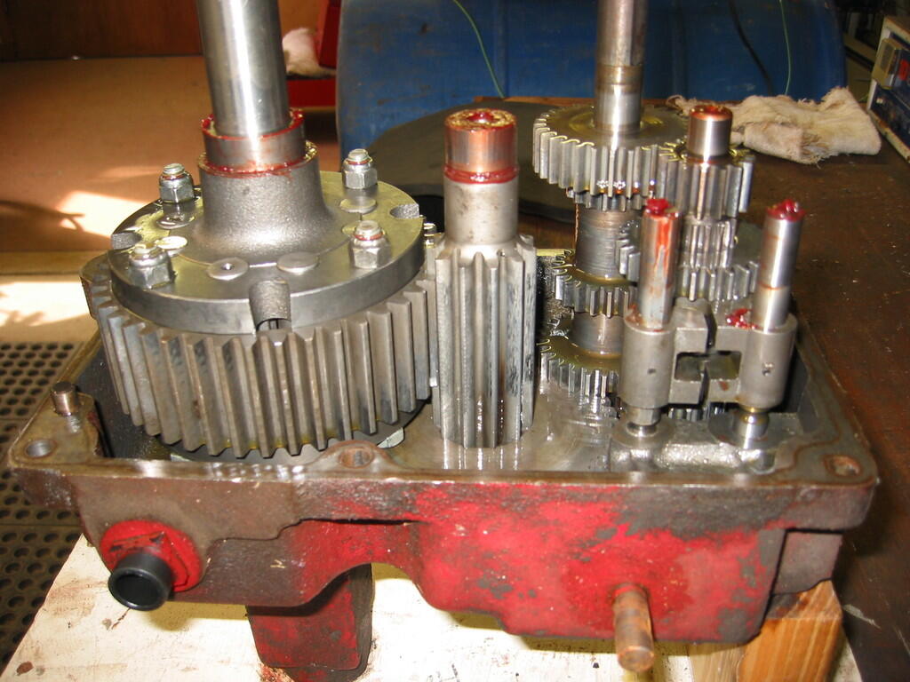

OldWorkHorse
That should be the direction of nuts. (Sry for whoevers photos I stole)
edited by Stevasaurus...@OldWorkHorse  yes, the picture is correct.  The exception is 10 pinion Limited Slip...the nut go down in those.
Edited by stevasaurus
Looks right.
Just go around the case there giving everything a shake or two and be sure its all properly seated.
Sometimes a shaft doesn't set in quite right or whatever.
The case lineup pins have bit me at least twice now.
It'll go. Just be patient and watch the videos 37 times. It's worked for me so far.

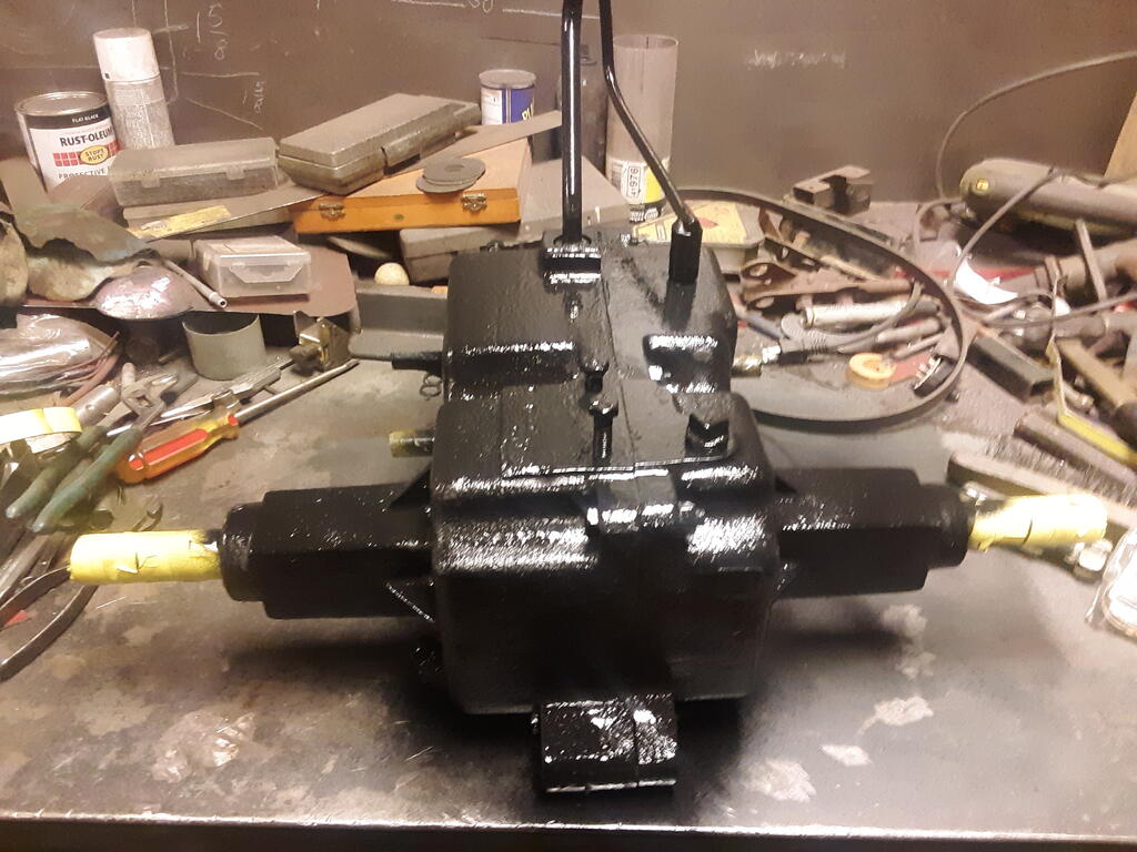

All clean and shiny.
  • Excellent 3
19richie66
put a thick coat on the bottom. :handgestures-thumbupright: Looking good!
I'll second that.
