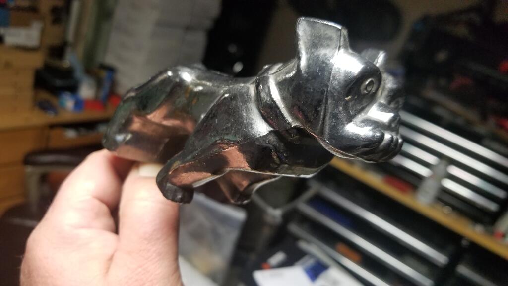

25 minutes ago, Tractorhead said:
did you set a basecolor of Black ahead?
Yes, it started with a high gloss black urethane. The Moto Chrome paint that I used specified that the base color must be a urethane paint. It also specified that the base black color be allowed to cure for at least 1 week before spraying the chrome paint over it.
Tractorhead
Thanks Dan for that Feedback.
I see that often in advertising's, but never tried it myself.
but to see a result from an independent person give me a better feeling to try it by myself.
They mostly suggesting not clear coat it, otherwise the Glossy will fade quickly.
Is that the same on this product?
Achto
This company offers a clear that is "made" for their chrome paint and suggested it be used for extra protection if the item is to be exposed to the elements. They warn that it will drop the reflection quality by 5% to 10%. Well... they are right. The shine is not what it was before I cleared it.:unsure:
It still has a respectable gloss but not like it had before I cleared it.

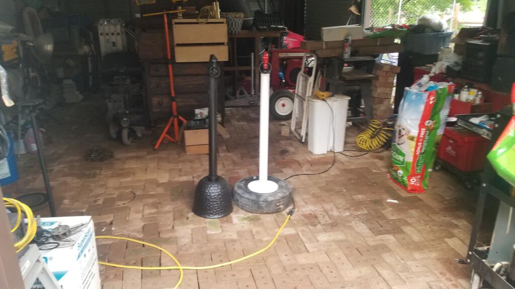

Latest projects Im finishing up just before big show.

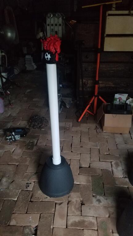

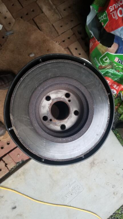

Hitching posts....used old rotors from the brake shop, drill 6 holes around edge, and added bolts with 2 nuts...one nut snugs against the outside of the pot pinning the pot between the bolt head and that nut, the other nut tensions against the rotor while the tip of the bolt goes into the holes around the edge of the rotor.

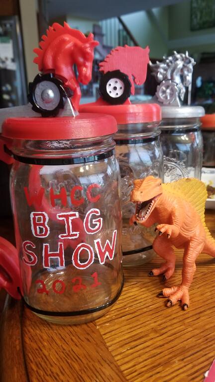

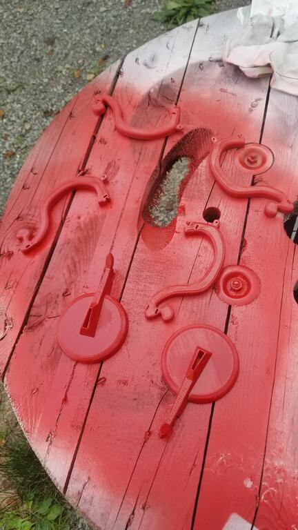

Steins...did a red coat over some if the off red abs and assembled. Painted ONE custom BIG SHOW stein as a donation to the WHCC auction.

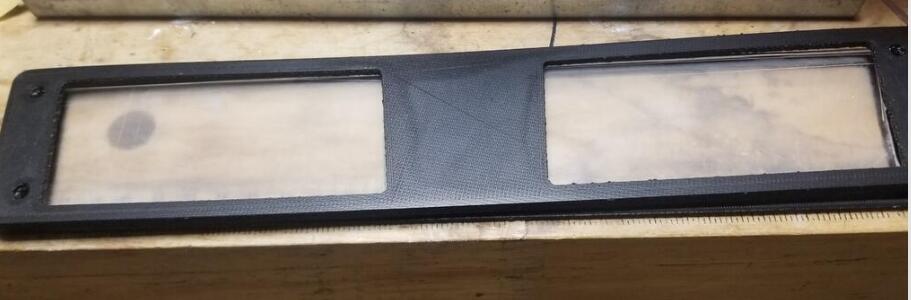

Also just finalized design for the 78 79 fiberglass blackhood lenses will have one or 2 of those at the show.

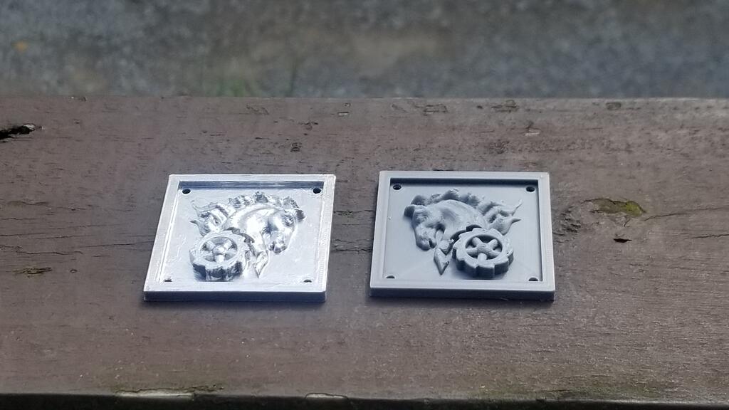

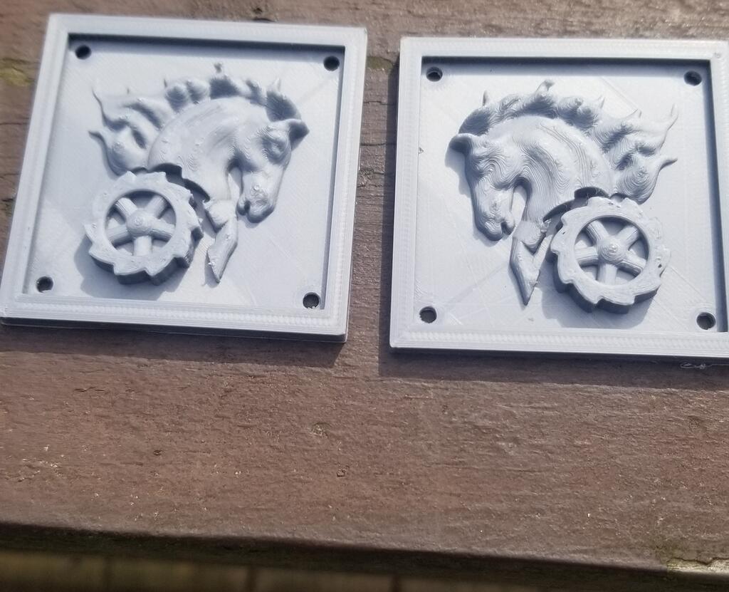

2 1/8 inch Badges now in the store! Available in natural "steel" or painted silver, and as a single left facing, or Left and right facing pair.

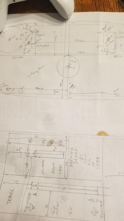

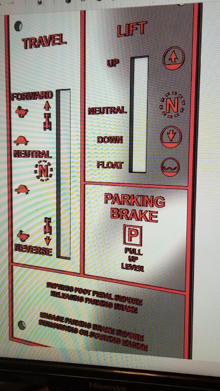

Begining layout of GT 14 dash and console.
Thanks to @buckrancher for the sample!
Wheel Horse 3D

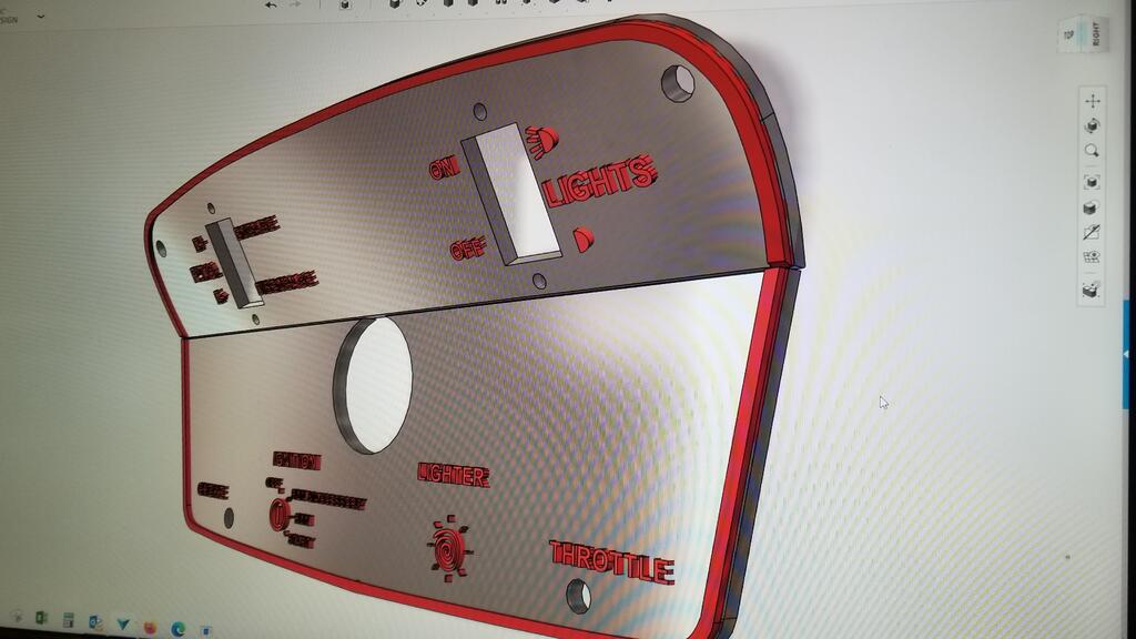

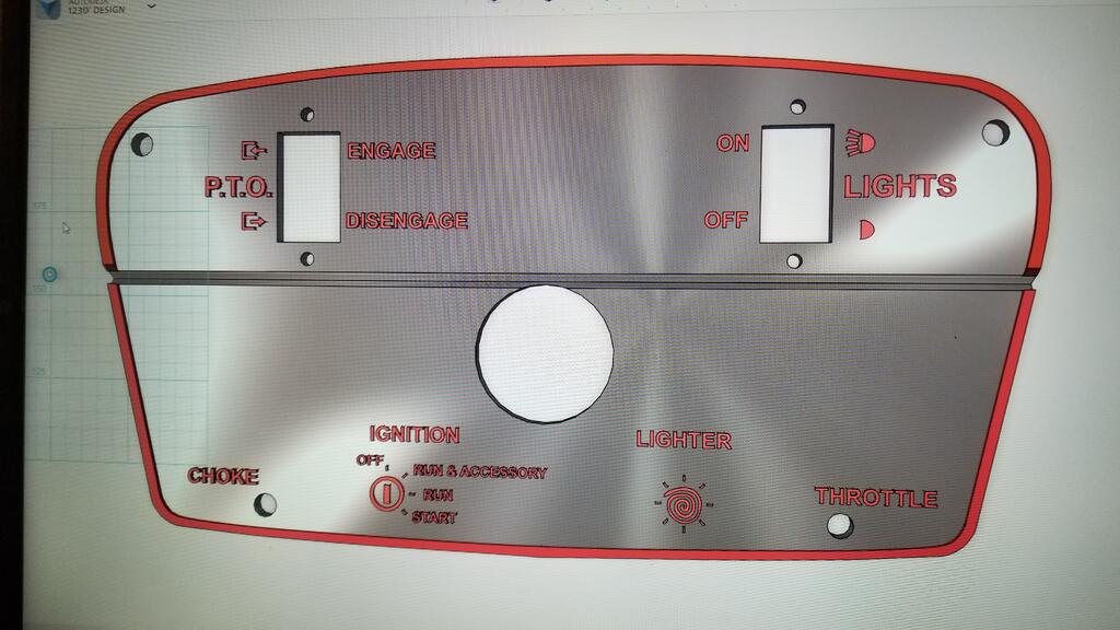

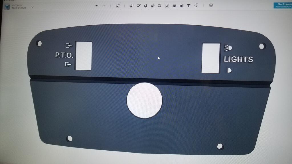

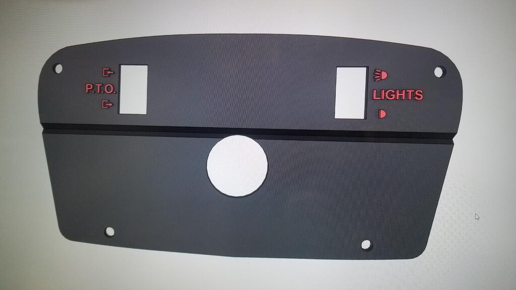

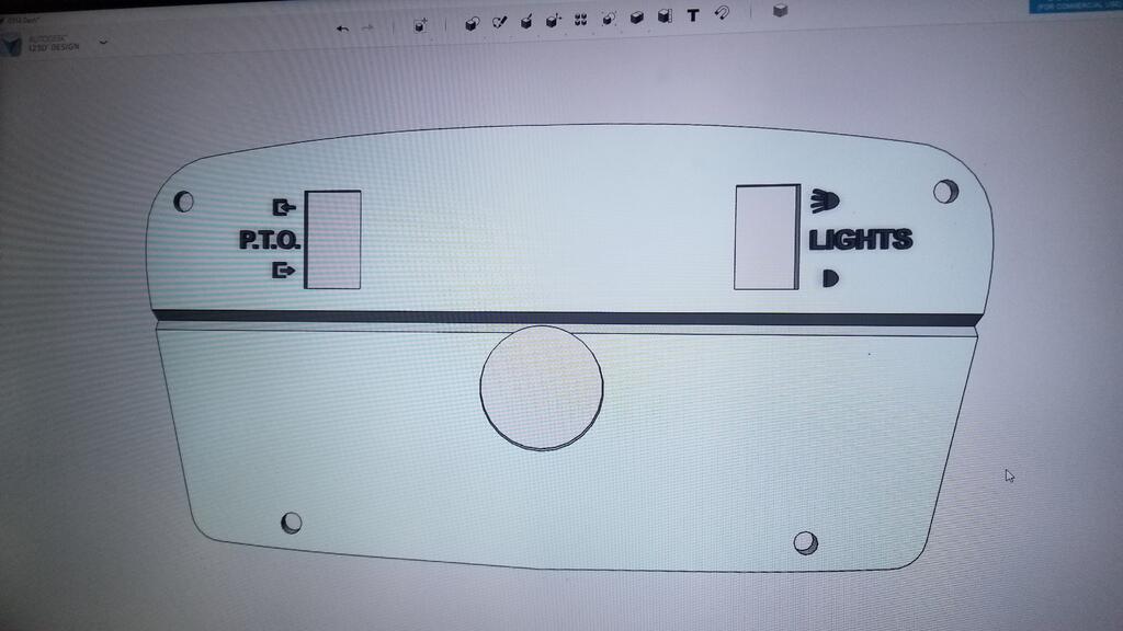

Gt14 dash model in progress! Thinking this would also be easy to print in different colors for some nice custom looks!

Gt 14 console model.. initial draft!
Wheel Horse 3D
Still working on that GT14 dash..that durn lighter icon curly cue is a bear on the big machine theres a setting somewhere not quite right..maybe extrusion factor.

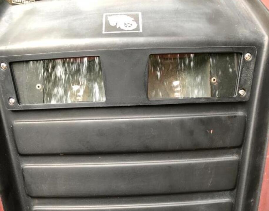

On 5/12/2021 at 11:03 AM, Wheel Horse 3D said:
For those who havent been following else where, and thanks to a RedSquare member who is willing to send a broken one for dimensions, we'll soon have a headlight bezel model for the '78 '79 fiberglass hoods that are very hard to find! I'll be sure to have these ready just as soon as i receive the example, and ill be sure to bring at least one up to the Big Show(unless more are requested)
Did you get these finalized? I have an E 141 that I will need this part for… please pm me if so…
pic:
Wheel Horse 3D
pic:
Sure did get em finalized!

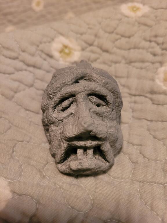

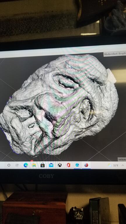

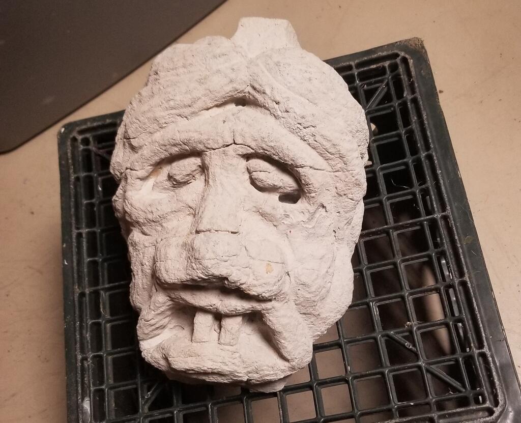

Continuing to send out ornaments etc. Just purchased an upgraded computer system that is extremely fast! Now have the ability to vastly increase resolution, AND use photos to 3d scan items...such as this gargoyle head from the Trans Allegheny Lunatic Assylum museum.(The 2nd largest handcut stone  building in the world after the Kremlin.) Museum wants keychain gargoyles lol.Fist the original cast, and the screenshot of the completed 3d model.

This morning we end up with a physical copy of the original!
