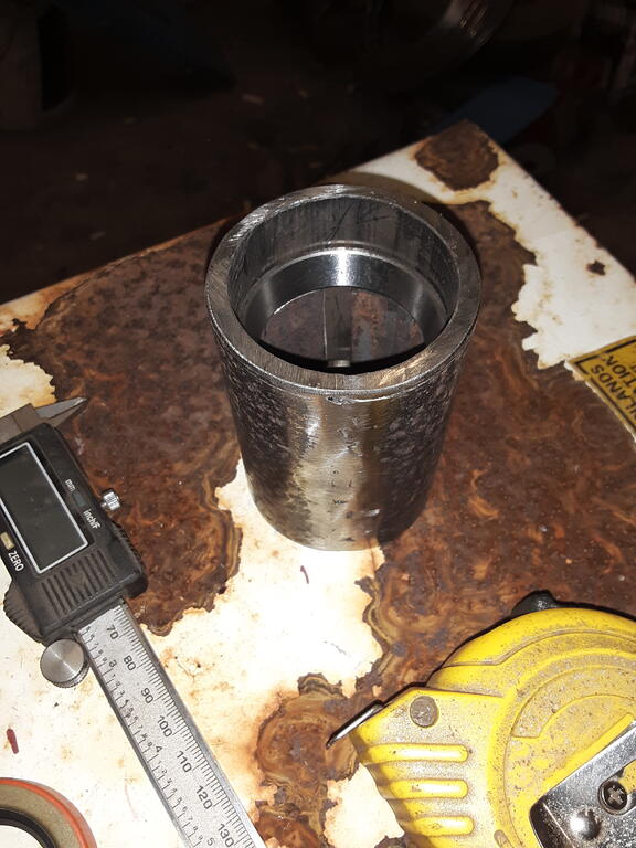

1 bearing hub. 1 more to go

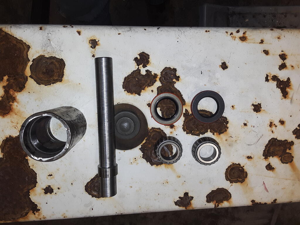

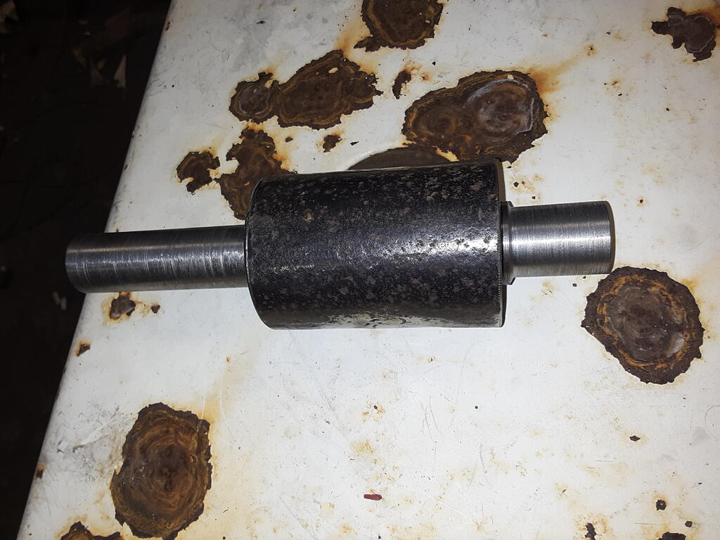

To nice of a day to be in the shop for to long. The honey-do list is still looming over my head. I did manage to get one shaft turn out. To finish this unit I still have to thread one end, make a spacer to compress the bearings and have 2 keyways cut. One on each end.
