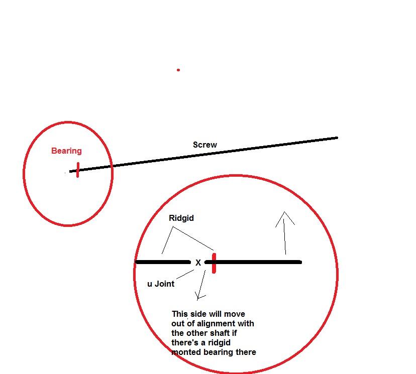

A problem with doing that is the shaft section behind that rigid supported bearing will move out of alignment in a way in which the the U Joint can't handle or renders it useless to swivel. The swivel point of a support bearing must be in the same plane as the U joint swivel point if he wants to keep the sprocket from tilting at all.

DennisThornton
I think you are right!  Too great a swing in that very short distance.  Just changed the problem instead of eliminating it...  Earlier I mentioned CV joints.  Not sure what their range is though.

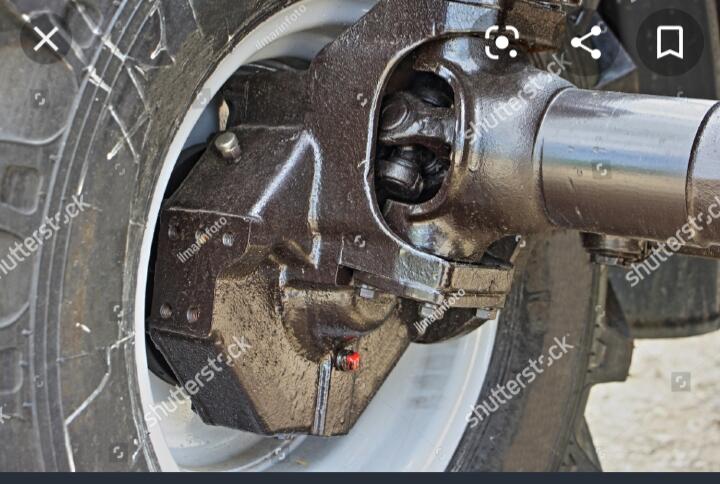

Open all the cans of worms you want. lol I think what @DennisThorntonis getting at is something like this pic.

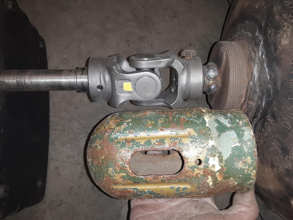

Oldskool
So for now I have a couple of ideas .
1: drill and tap for 5/16 at the yellow tape and make some thick washers to help support the ujoint caps.
2: use the caps off the tanks. Cut the top off where it starts to round. It wont help in support but it actually would if the ujoint fails. It also has a hole big enough the service the joint.

The cap also will keep the screw from coming out of alignment at ujoint failure making it easier for retrieval and loading. Instead of the rear strut just hitting the ground
